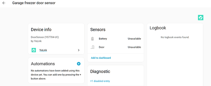

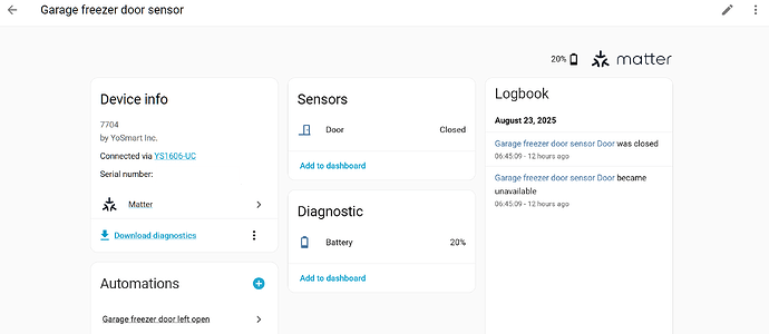

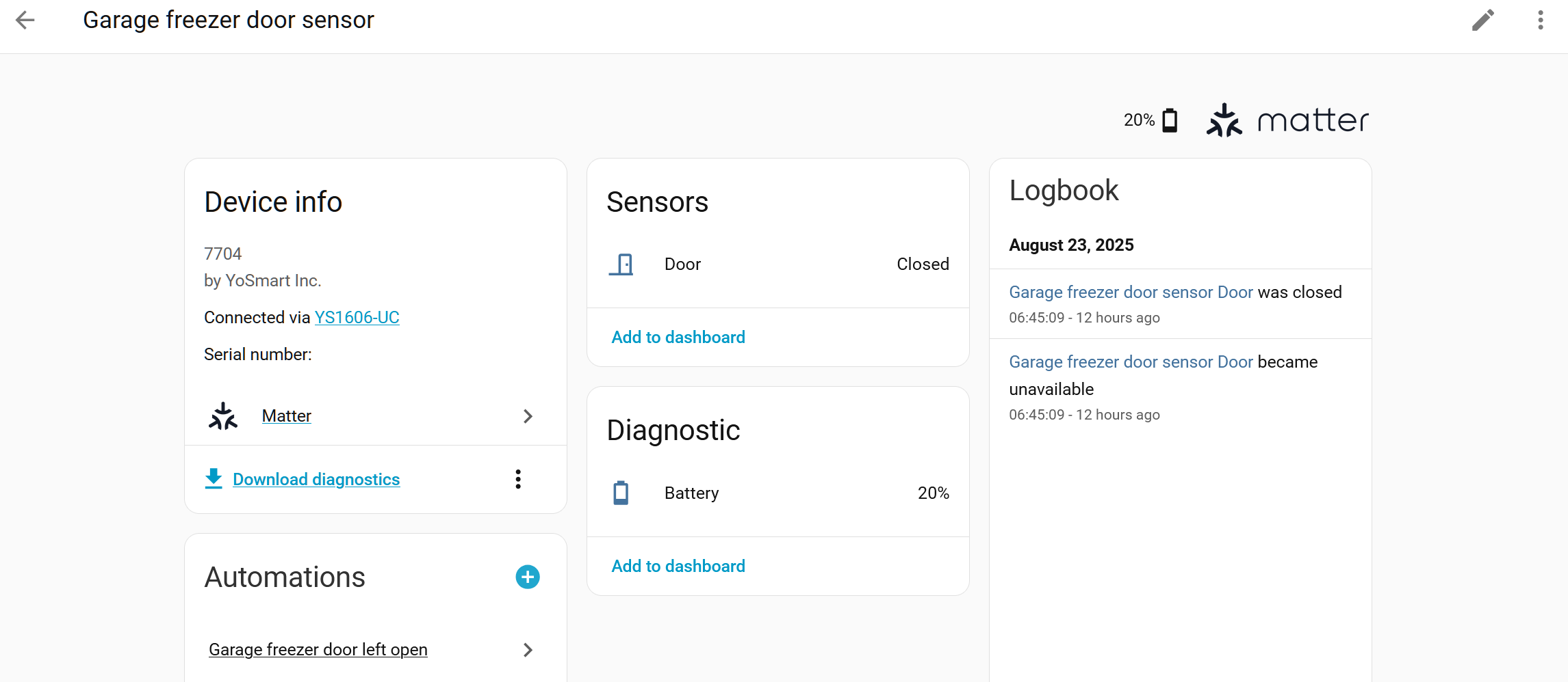

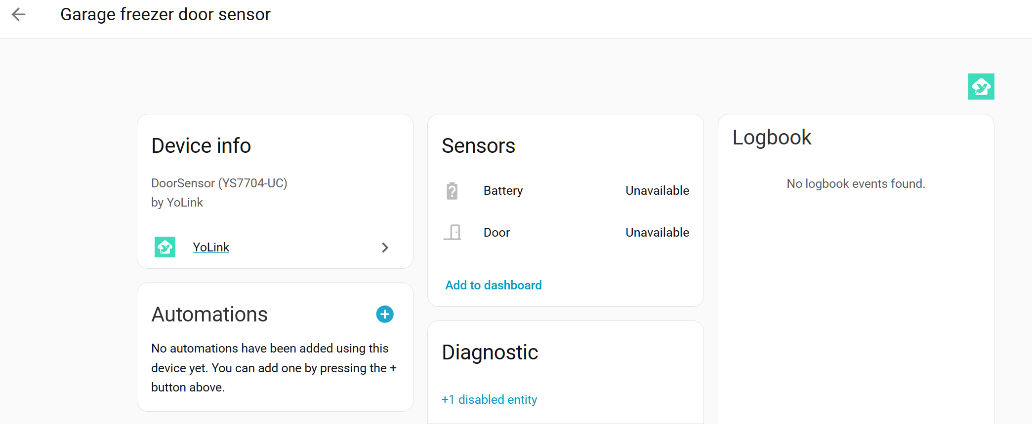

One of them is a YS7704-C door sensor, which has been offline for 12 days in the Yolink app. It shows as having 20% battery, and “Closed” with the Matter integration.
The same sensor can also be used with the Yolink cloud-based integration. It correctly shows up as being offline in that integration.
So, this door sensor device is showing offline in 2 out of 3 places
  1. the Yolink Android app : offline.
  2. the Yolink HA integration : offline
  3. the Matter HA integration : online

  1. The YS7704-C door sensor. This sensor was never dropped. It is however located in a freezer, which impacts battery performance. My observation is that in one HA integration, the Yolink integration, the device shows as offline, whereas in another integration, the Yolink one, it shows it as online. The state of the device should be consistent in both integrations - either it should be online in both, or it should be offline in both. The discrepancy is my main reason for posting this thread. In this case, the device should show as offline in the Matter integration, not online, as it still does even one month later.

However, it remained online in the HA Matter integration. That is again a discrepancy between the HA Yolink cloud and HA Matter integrations.
The Yolink device never goes offline in the HA Matter integration, even with batteries removed.
