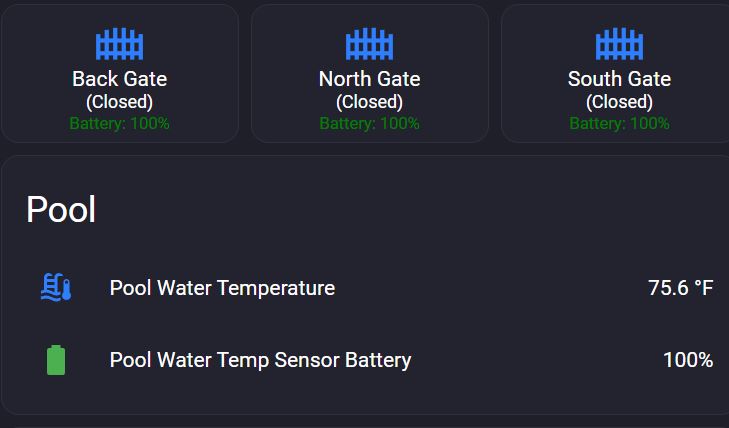

I only have the YoLink Local-Hub, but I will say that the (3) gate open/close sensors update pretty much instantly. I’m very impressed by the responce time - and I have one that is a good 75+ feet away in the far back of the yard on the rear fence gate and I have the hub in the basement. It works perfect. I also have a water temp sensor for the pool and that also works great.

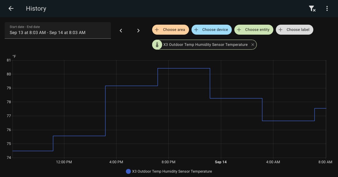

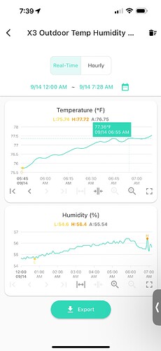

Can you do me a favor? Can you see how often your pool temperature sensor updates in HA? I have the local hub integrated with HA via matter and the YS8015-UC X3 Outdoor Temp and Humidity Sensor only updates every three hours no matter what recording interval is selected in the app. Unfortunately this makes the local hub a completely useless investment for my application.

I use this for the pool temp: Yolink - 3YS8004. It appears the update schedule is exactly once an hour via MQTT.

Just for another data point… my YS8008-UC Pool Thermometer updates every 30 minutes when connected directly to the YoLink standard hub and integrated into HA with the YoLink integration.
