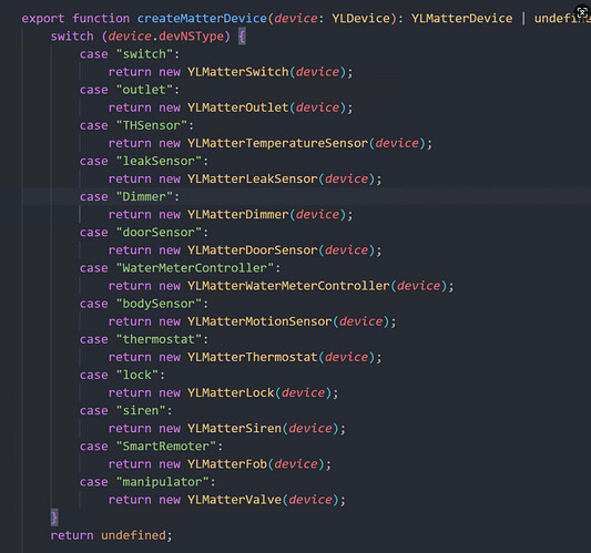

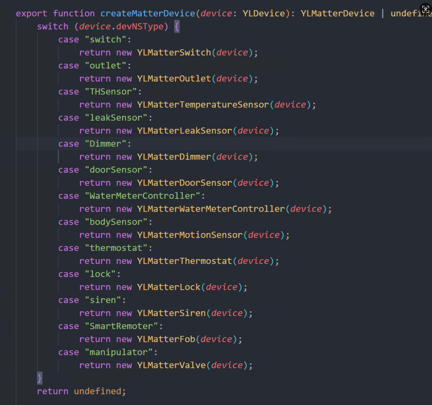

So they replied with this
ā€œHi there,
The siren and Flex Fob are indeed on our Matter support roadmap.ā€
I think that should take care of the rest of their devices that are currently supported in Matter.
