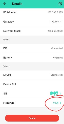

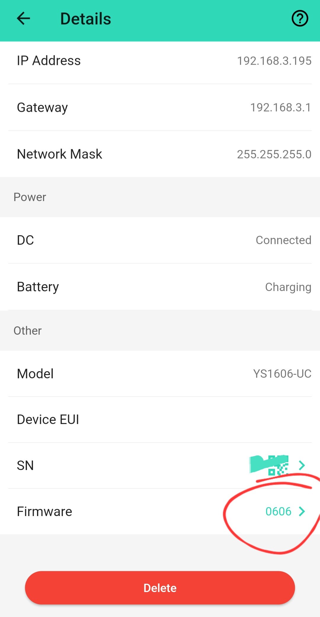

  • Firmware 605 was not working for me.
  • Locate the firmware info and apply firmware 606.
  • Be patient - mine took a while and it had no confirmation that it succeeded. I ran it multiple times. If you interrupt, it may brick the hub.
  • Physically power cycle the local hub with the slider switch. Wait 10 seconds for the light to go completely off before powering back on.
  • Close/reopen the app if necessary to confirm it shows firmware 606.

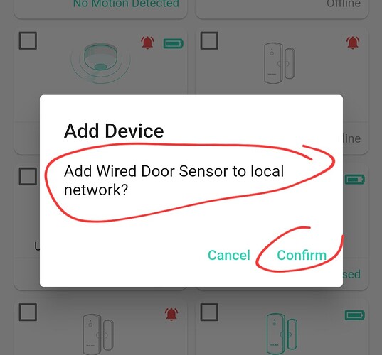

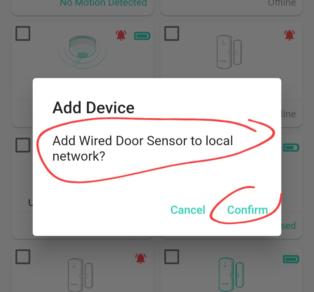

III. Move devices from YoLink cloud to Local Hub

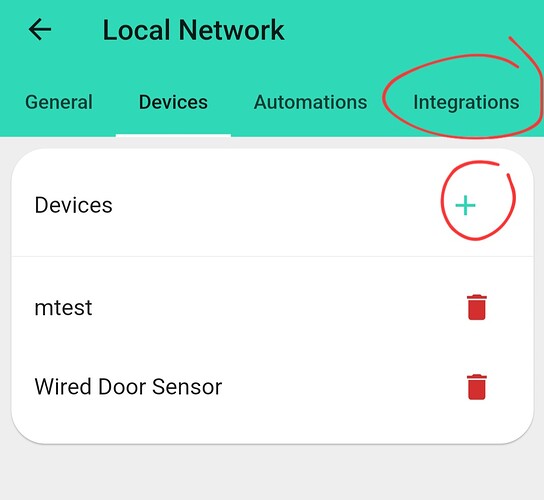

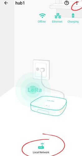

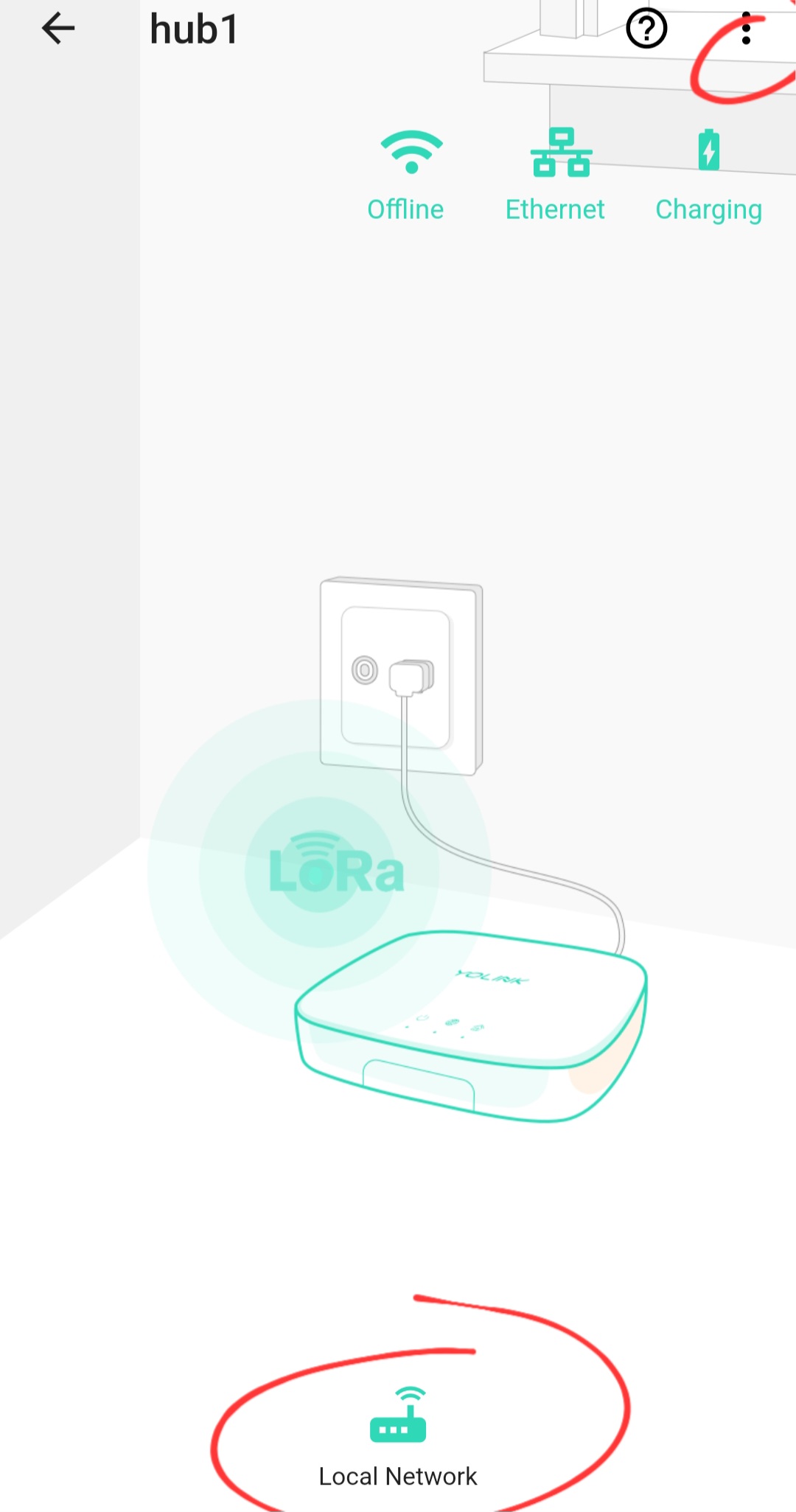

  • Create a Local Network (I did not take a screenshot, I think it prompts you to do this initially when opening the hub device). The term “Local Network” is specific to LoRa (it’s not an IP subnet).
  • Add devices to the Local Hub. This isolates them from YoLink cloud and pairs them to this specific hub.

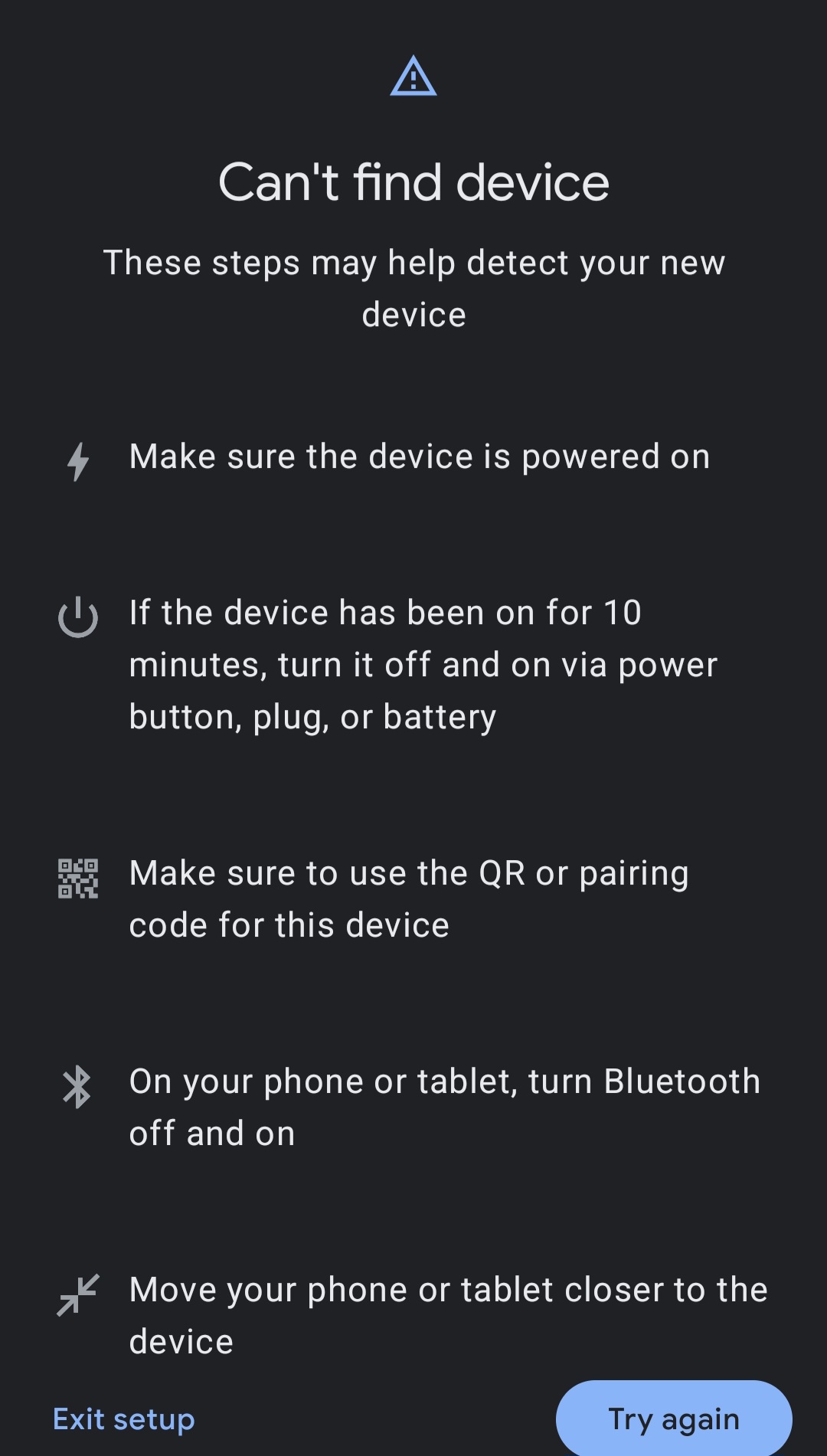

  • This was a struggle until I updated the hub, power cycled it, and moved everything to the same lan/vnet. Be advised … when it works, it takes only a few seconds to connect.

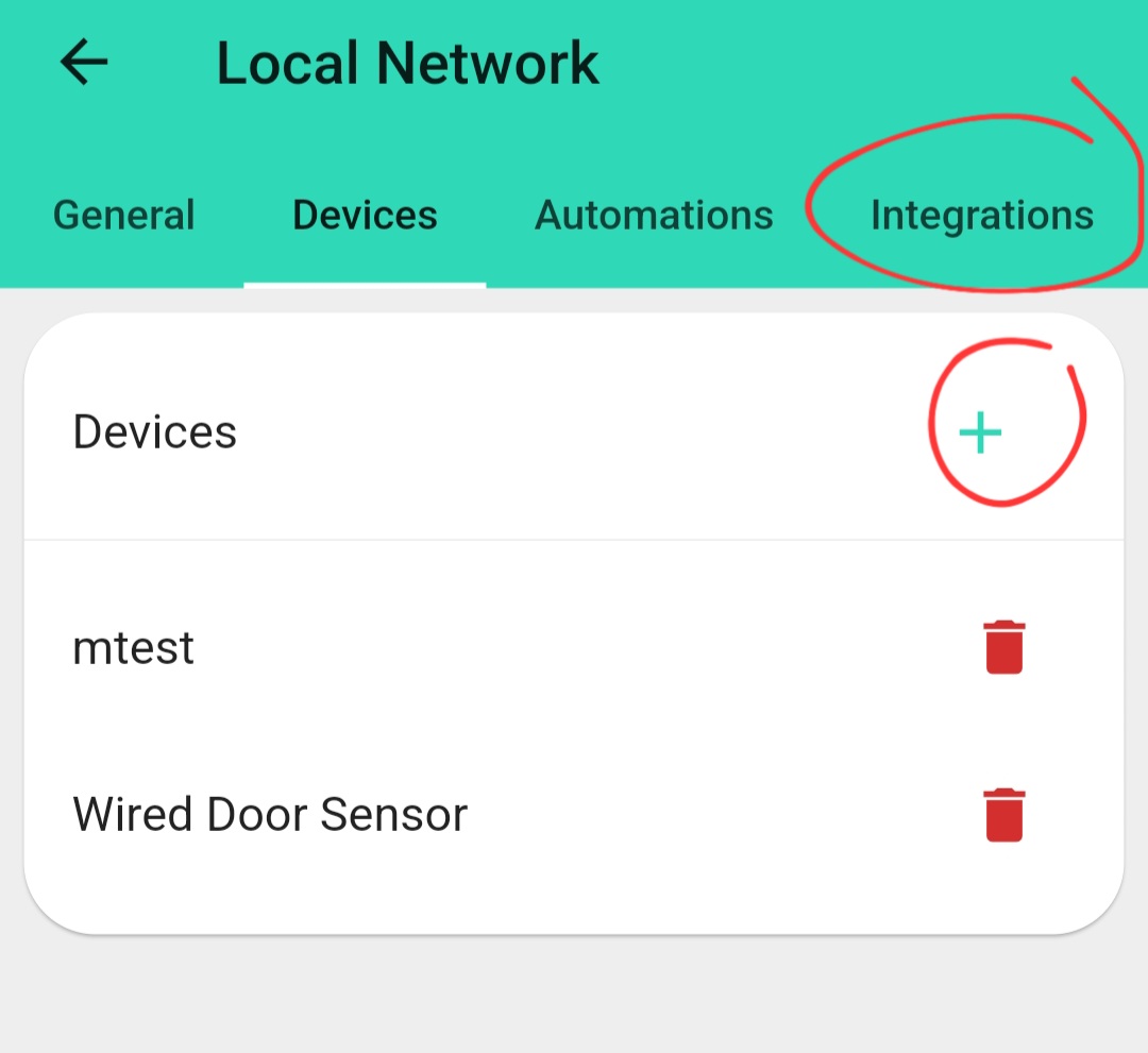

  • It appears the pairing process is only needed a single time. Additional sensors will subsequently work their way into HomeAssistant with a little “help” by restarting the YoLink local network and/or reload the Matter integration in HomeAssistant.

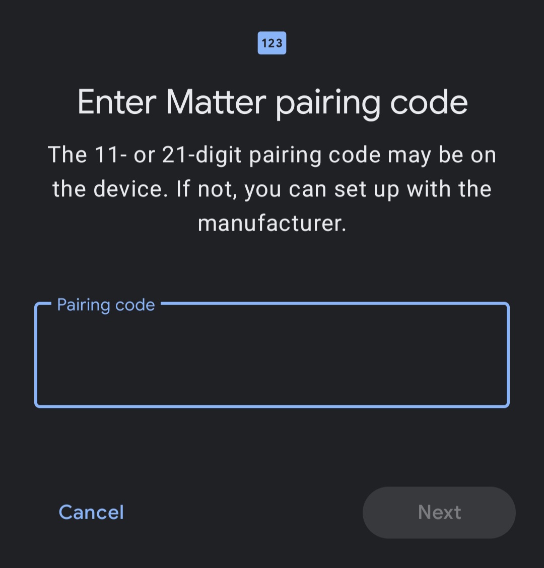

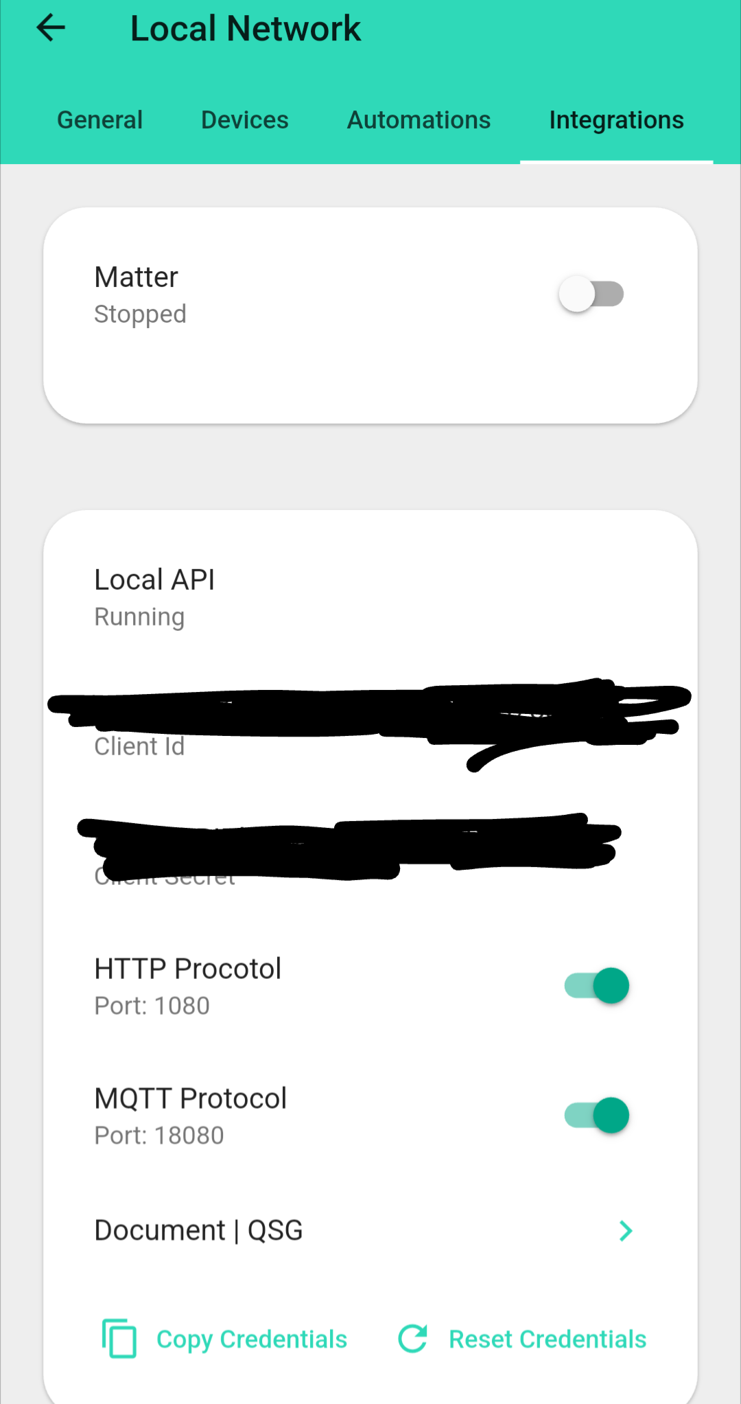

  • Open the YoLink app → Local Hub → Local Network → Integrations tab and record the Matter pairing code.

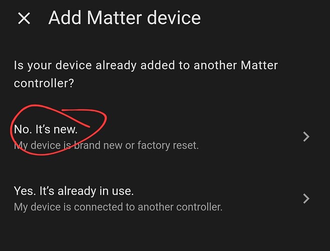

  • Now open the HomeAssistant App. Assuming you have already configured Matter (BETA) integration, go to Devices & Services → Devices → Add Matter Device.
  • Pick “No, it’s new” when prompted
Code from integrations tab needed below:

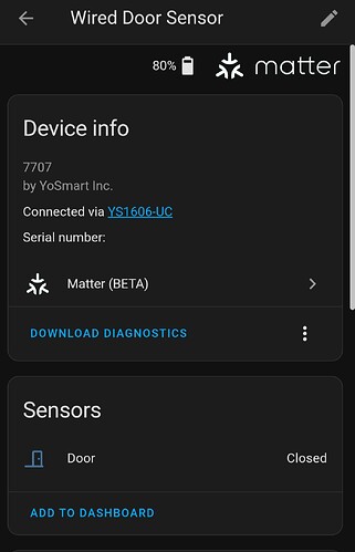

Success! :partying_face: Devices show up with good responsiveness, but fewer details than I remember seeing in the YoLink integration:

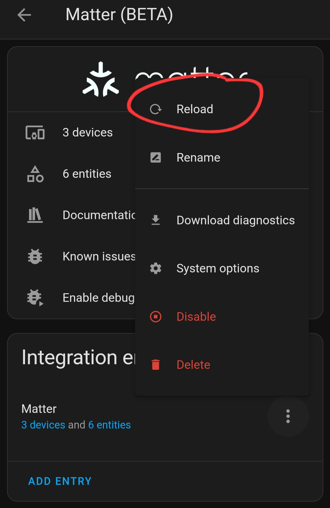

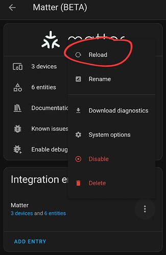

  • Try reloading the HomeAssistant Matter integration, or restarting the “Local Network” in the YoLink app.
Troubleshooting:
  • Update to the latest YoLink app
  • Make sure at least one device has been added to the local hub before trying to set up Matter integration
  • Try moving everything to the same local network
  • Disable “AP Isolation” mode for wifi, at least temporarily
  • Make sure your phone is actually on the correct wifi (same subnet) as the YoLink hub and HomeAssistant
  • I’m not familiar with Matter protocol or what ports it uses - try a base HomeAssistant installation (with IPv6) if you are not having any luck

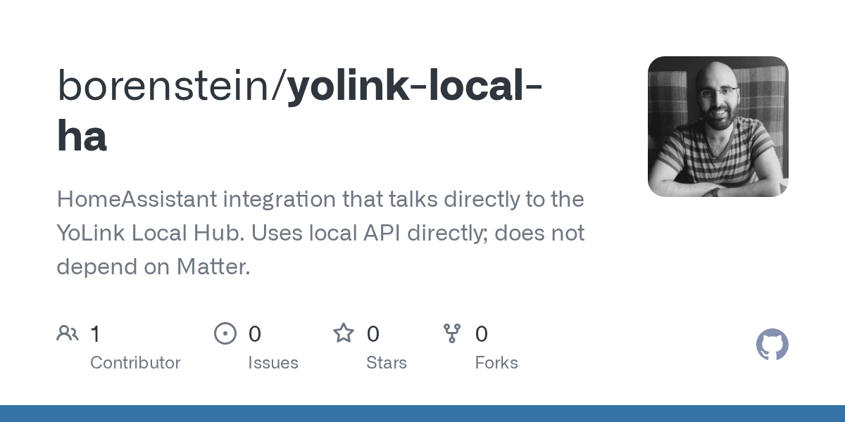

@parannoyed this was incredibly useful, and inspired me to take it one step further. The Matter integration is really half-baked, but the local API is fully mature. So I wrote a HomeAssistant integration that talks directly to HTTP and MQTT. I haven’t yet done the stuff to get it added to HACS, so for now, you’ll need to clone and install.

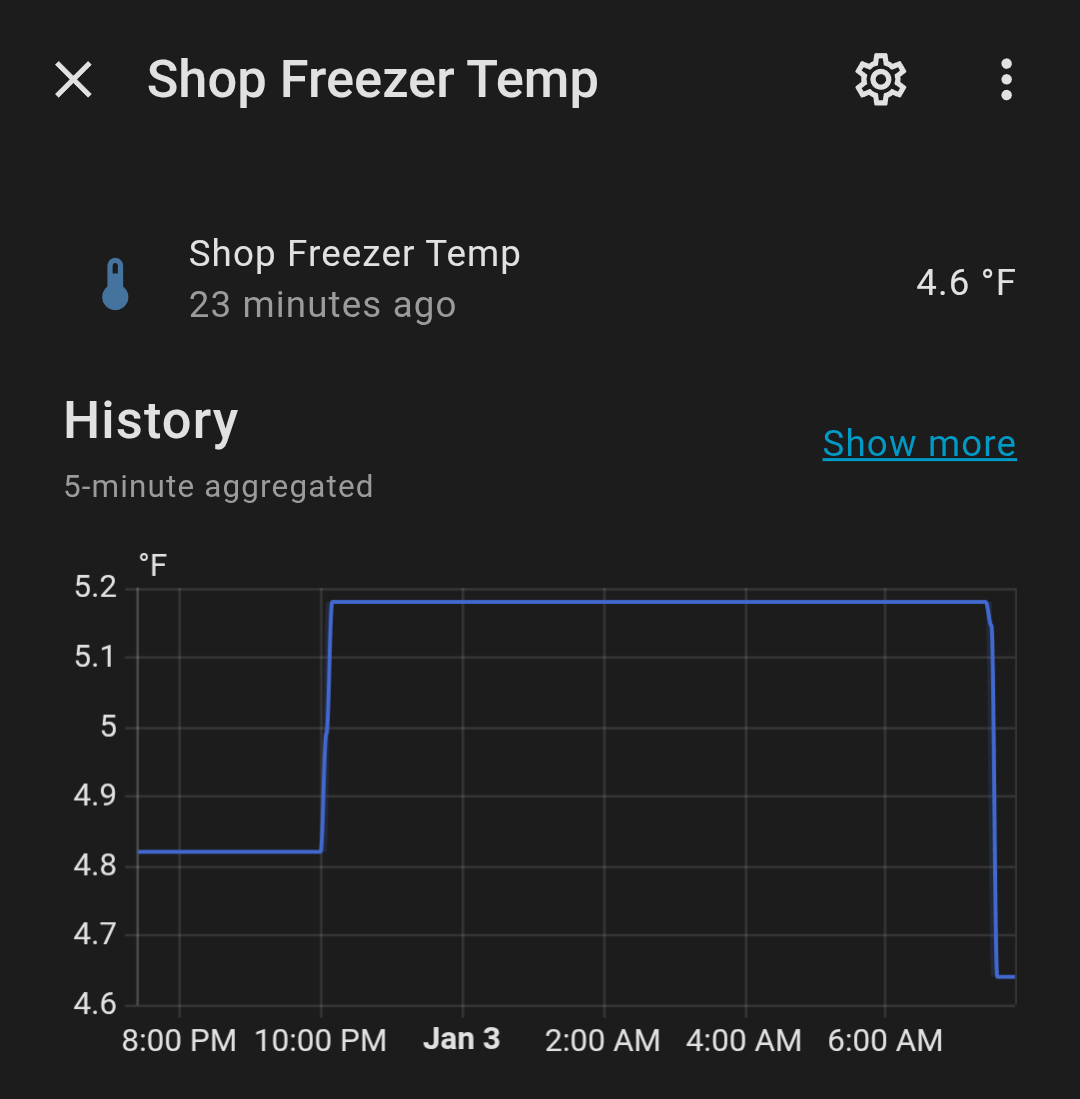

I’ve just installed the local hub and the hacs integration from @borenstein. First of all the setup was really easy, thank you. Very detailed instructions in the repository.

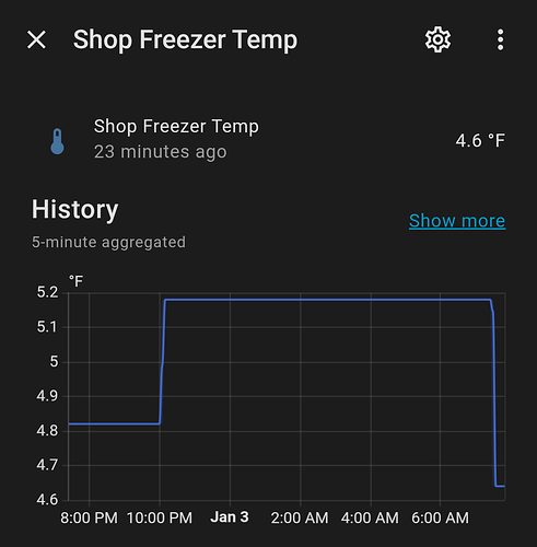

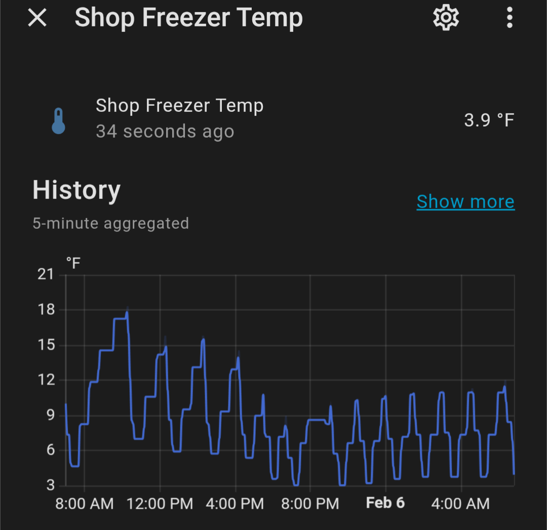

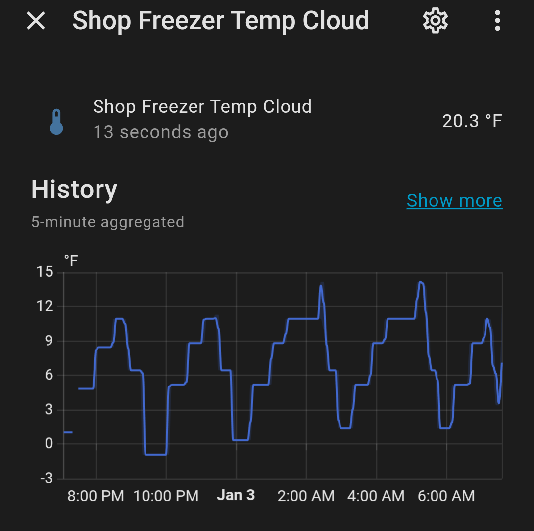

I’ve noticed that the devices don’t seem to update very quickly. You can see the updates for the temperature sensor in my freezer below
These are the same device. The cloud based integration updates every 5-10 minutes or so while the local integration seems to barely update every 8 hours.
Not sure if this is normal or if I set something up incorrectly. I know it’s still early days on this but I’m keeping the cloud integration running for now.
I have HTTP and MQTT protocols enabled in the Yolink app, but not the Matter protocol

Well after a few weeks I’ve revisited (after having forgotten about it honestly…) And it appears the local integration is showing device updates much more frequently now. May have just been a quirk of the integration or perhaps some firmware updates. Either way, I’m happy with the frequency of updates and excited for the future of this local integration
