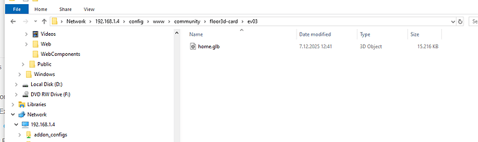

Your Home Digital Twin: Interactive floor 3d plan
My plan is only 13 Mb. “15.216Kb”

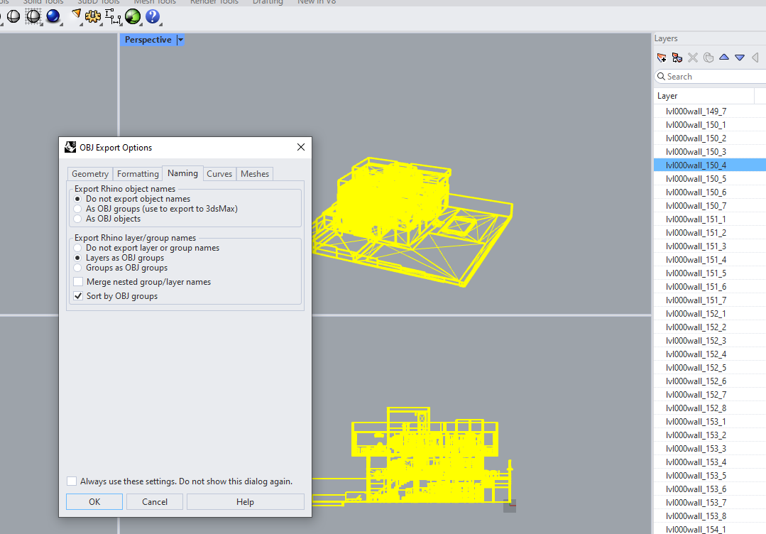

Other professional programs to evaluate;

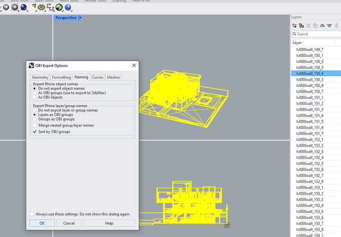

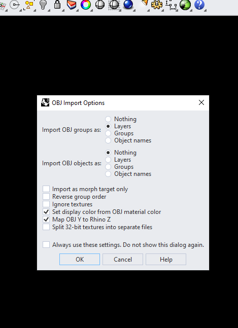

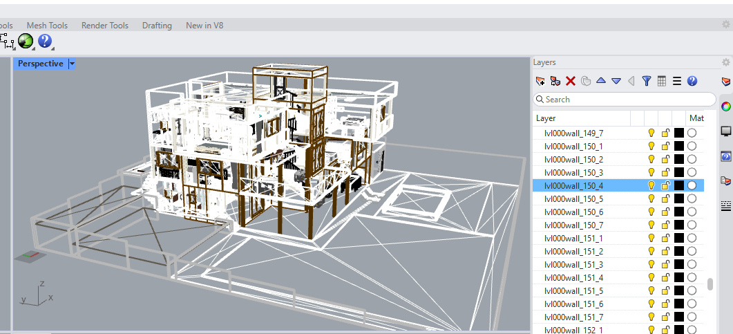

If you want to use Rhino;
way:1
use ExportToHASS and then you have an obj file. Import to Rhino for editing you need these settings
Then you will see
After this you can edit, delete or add whatever you need.
way:2
Beginning from Strach.
layer=object groups
Remember
All layers must be unique
Obj File->Group (door)->object1(wing)+object2(frame)+obj3(handle) etc. (sweet home 3D)
Layer (door)For another app->object1(wing)+object2(frame)+obj3(handle) etc. (professional app always use layers))
g lvl001wall_0_1 adizanni format
“lvl000” “lvl001” “lvl002” are the levels so layer name must be “lvl001(1or0 or2 )xxx”
save as obj (convert layer names to group)
For save as or export to obj file use these settings
the important thing is obj group is equals to layer.
In fact other professional pragrams have the the same logic “object groups=layers”
