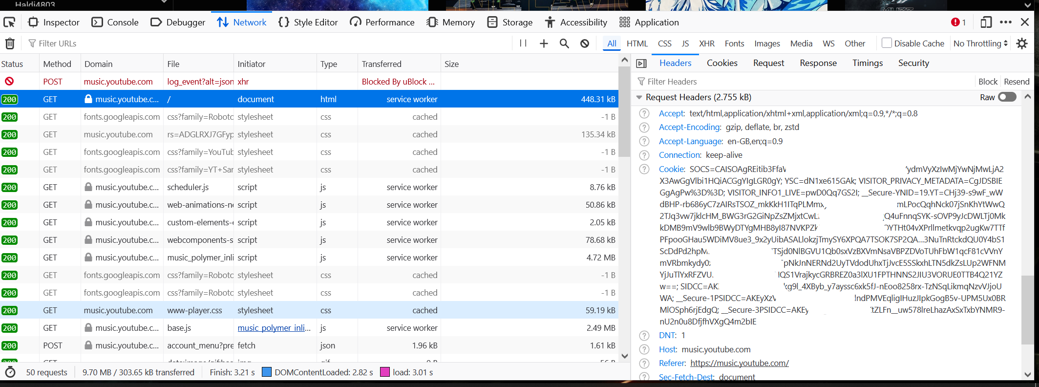

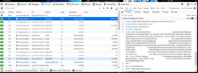

2. Recapture your cookie correctly
Open music.youtube.com while logged in. Open DevTools, go to the Network tab, and click on a youtubei/v1/... request (not the page itself, not a static asset). Copy the full Cookie request header. Confirm the captured string contains all of these names:
  • __Secure-3PAPISID
  • __Secure-1PSID
  • __Secure-3PSID
  • SAPISID
  • HSID
  • SSID
If any of those are missing, you grabbed a scoped request. Try a different youtubei/v1/... call. The prettyPrint=false request you used last time is fine as long as the full set above is there.
Paste it into the provider's Cookie header field and save.

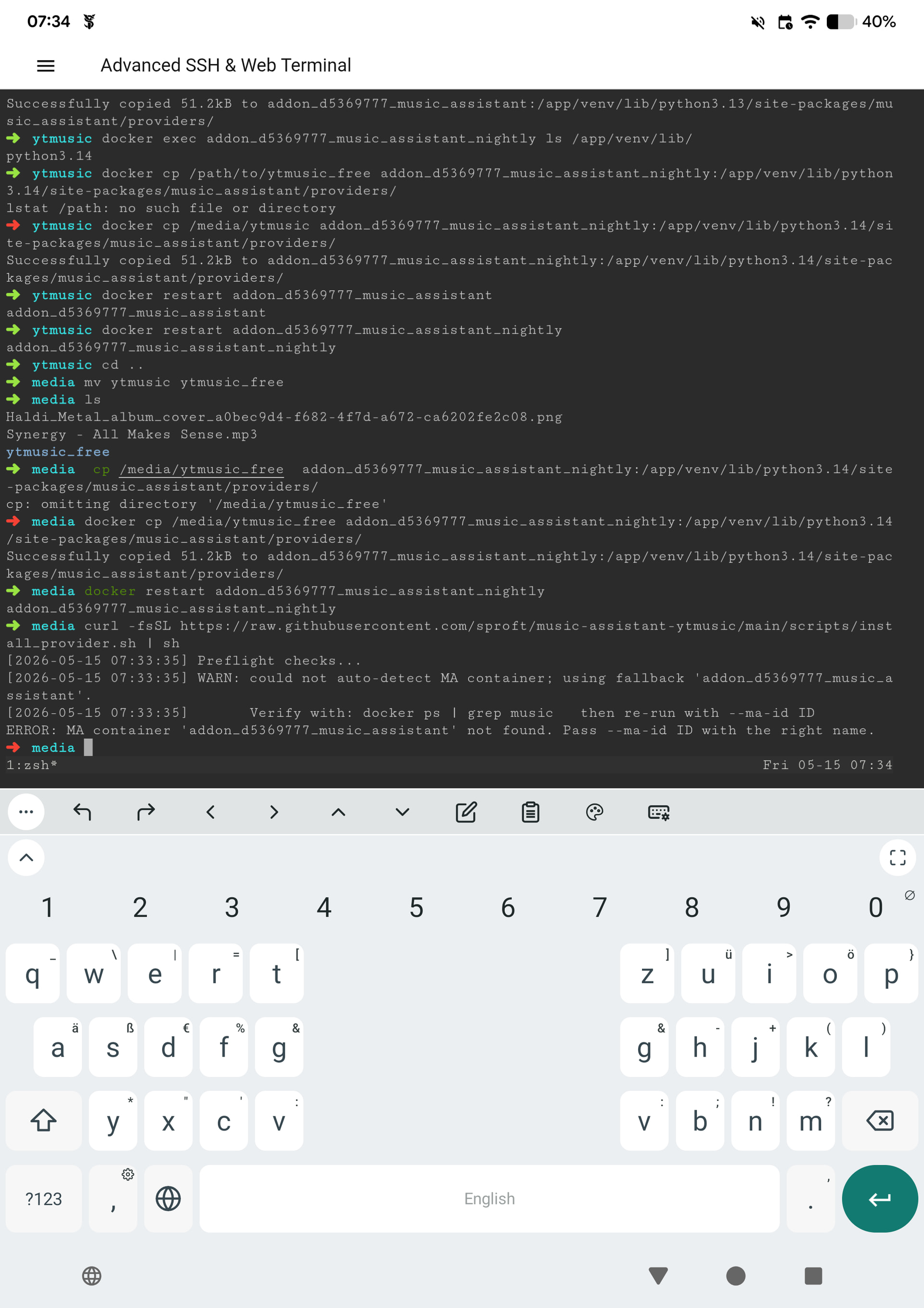

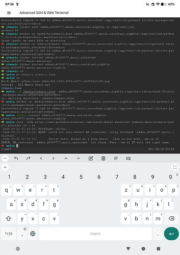

i used the Web Terminal...
How do i properly add the --ma-id command in the fsSL command? Can't you Auto Detect Beta/Nightly Versions? It's always "music_assistant" anyway.
➜  ~ curl -fsSL https://raw.githubusercontent.com/sproft/music-assistant-ytmusic/main/scripts/install_provider.sh | sh
[2026-07-01 21:18:48] Preflight checks...
[2026-07-01 21:18:48] WARN: could not auto-detect MA container; using fallback 'addon_d5369777_music_assistant'.
[2026-07-01 21:18:48]       Verify with: docker ps | grep music   then re-run with --ma-id ID
ERROR: MA container 'addon_d5369777_music_assistant' not found. Pass --ma-id ID with the right name.
➜  ~ curl -fsSL https://raw.githubusercontent.com/sproft/music-assistant-ytmusic/main/scripts/install_provider.sh | sh --ma-id addon_d5369777_music_assistant_beta
sh: bad option '--ma-id'
curl: (23) Failure writing output to destination, passed 1369 returned 0
➜  ~ docker ps | grep music
7f0b7388b9e3   ghcr.io/music-assistant/server:2.10.0b2                    "/usr/local/bin/entr…"   13 minutes ago   Up 13 minutes                                                                                                      addon_d5369777_music_assistant_beta
➜  ~ curl -fsSL https://raw.githubusercontent.com/sproft/music-assistant-ytmusic/main/scripts/install_provider.sh --ma-id addon_d5369777_music_assistant_beta | sh
curl: option --ma-id: is unknown
curl: try 'curl --help' or 'curl --manual' for more information
➜  ~ curl -fsSL https://raw.githubusercontent.com/sproft/music-assistant-ytmusic/main/scripts/install_watcher_addon.sh | sh
[2026-07-01 21:23:59] Preflight checks...
[2026-07-01 21:23:59] Detected local add-ons path: /addons
[2026-07-01 21:23:59] WARN: could not auto-detect MA container; using fallback 'addon_d5369777_music_assistant'.
[2026-07-01 21:23:59]       Verify with: docker ps | grep music   then re-run with --ma-id ID
Error response from daemon: No such container: addon_d5369777_music_assistant
[2026-07-01 21:23:59] WARN: could not auto-detect Python version; using fallback 'python3.13'.
[2026-07-01 21:23:59] Downloading https://codeload.github.com/sproft/music-assistant-ytmusic/tar.gz/refs/heads/main
[2026-07-01 21:23:59] Extracting...
[2026-07-01 21:23:59] Creating /addons/ma_provider_watcher
[2026-07-01 21:23:59] Writing config.yaml
[2026-07-01 21:23:59] Writing build.yaml
[2026-07-01 21:23:59] Writing Dockerfile
[2026-07-01 21:23:59] Writing run.sh (MA=addon_d5369777_music_assistant, python3.13)
[2026-07-01 21:23:59] Install complete: /addons/ma_provider_watcher
Next steps:
  1. In Home Assistant: Settings -> Add-ons -> Add-on Store
     (three-dot menu) -> Check for updates.
  2. Open "MA Provider Watcher" under Local add-ons.
       First install:  click Install.
       Re-installing:  click Rebuild (three-dot menu) so the new run.sh and
                       provider files are baked into the image. A running
                       add-on keeps its old cached image until you rebuild.
  3. On the Info tab, turn Protection mode OFF (required for Docker socket access).
  4. Start the add-on and check the logs for "Copied OK" / "MA restarted".
This installer stamped version 1.0.20260701212359 so Home Assistant detects the
change. If you re-ran to fix the MA container ID or Python version and the
add-on still uses the old value, Rebuild it (step 2) -- "Check for updates"
alone does not rebuild a cached local add-on image.
If MA container ID or Python version was wrong, re-run with:
  sh install_watcher_addon.sh --force --ma-id <ID> --python-version <pythonX.Y>
Yeah... i think Youtube changed something...
OR i'm just incompetent...

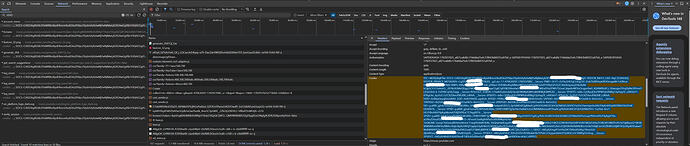

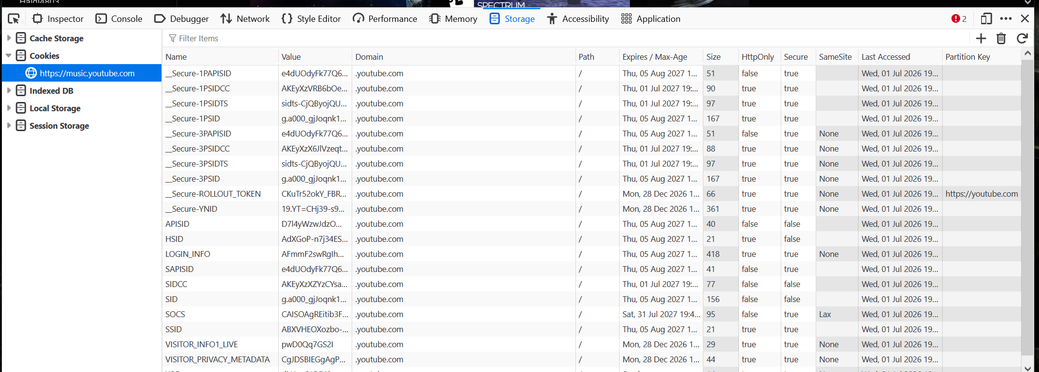

So i went to the storage Tab. And found the Cookies myself:
But can't add them.
2026-07-01 22:00:03.775 INFO (MainThread) [music_assistant.YouTube Music (Free)] Config updated, reloading provider ytmusic_free (instance_id=ytmusic_free)
2026-07-01 22:00:04.952 WARNING (MainThread) [music_assistant.ytmusic_free] Cookie is missing recommended values: __Secure-1PSID, __Secure-3PSID, SAPISID. The provider may validate at init and then fail library calls a few minutes later. Recapture the Cookie header from a `youtubei/v1/...` request on music.youtube.com (see issue #6 for the full set to include).
2026-07-01 22:00:05.513 WARNING (MainThread) [music_assistant.ytmusic_free] Cookie authentication failed (Server returned HTTP 401: Unauthorized.
Request is missing required authentication credential. Expected OAuth 2 access token, login cookie or other valid authentication credential. See https://developers.google.com/identity/sign-in/web/devconsole-project.), falling back to anonymous mode. You may need to refresh your cookie.
2026-07-01 22:00:05.514 INFO (MainThread) [music_assistant.ytmusic_free] YouTube Music (Free) initialized — anonymous mode
2026-07-01 22:00:05.514 INFO (MainThread) [music_assistant] Loaded music provider YouTube Music (Free)

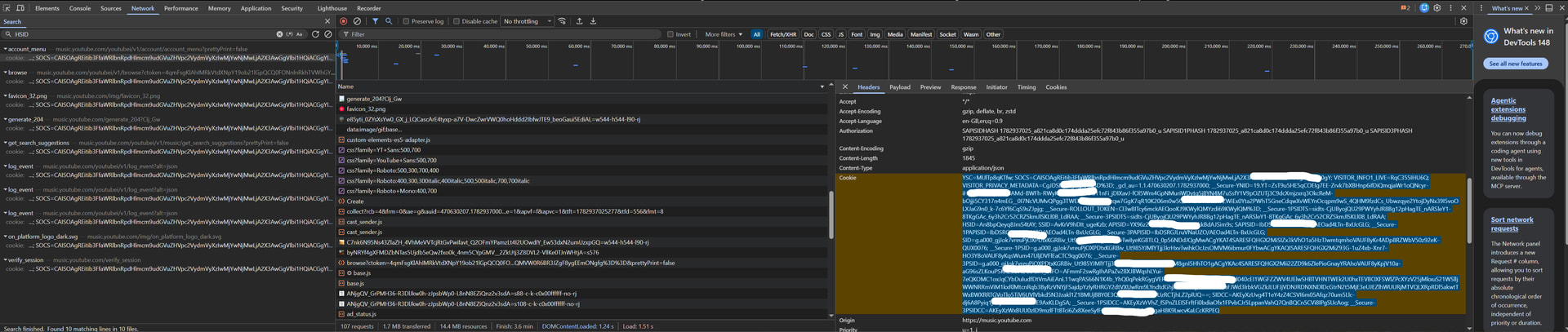

Found Issue 6, but how do i format them in one string to include?
Edit: Lol would you look at that?
Did the same thing in Chrome instead of Firefox! and it worked...

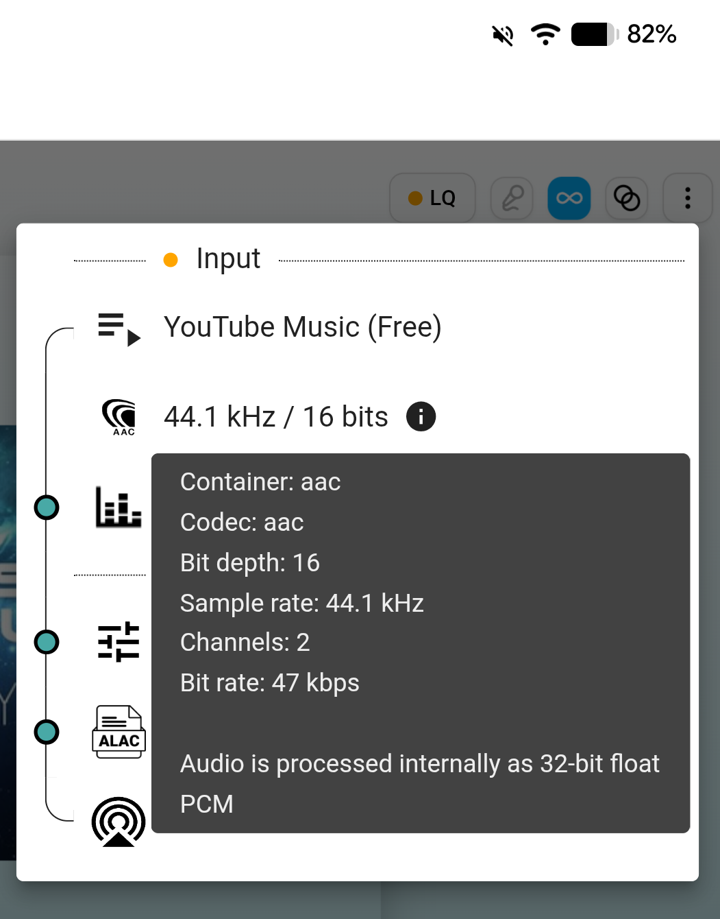

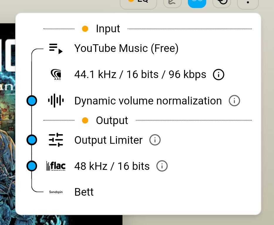

Nothing you can do about the low Bitrate. Is there?
Low Quality label: That "LQ" indicator in MA is based on what MA reports back from the stream metadata, not the actual bitrate. The android_music client we use returns 128–256 kbps AAC/Opus, which MA categorizes as "low quality" regardless of the toggle. The toggle controls yt-dlp's format selector (m4a/bestaudio/best vs worstaudio/worst), with it on, you're getting the best available audio. The label is just MA being strict about what counts as "high quality" (typically lossless / hi-res).

@sproft i don’t care about the LQ Logo, i was just astonished about the 47Kbits Bitrate. You think that value is correct? you said 128kbit AAC which is what i assumed as well, therefore wondered why it only showed 47.
Edit:
Must have been that one Video which only had low Quality.
