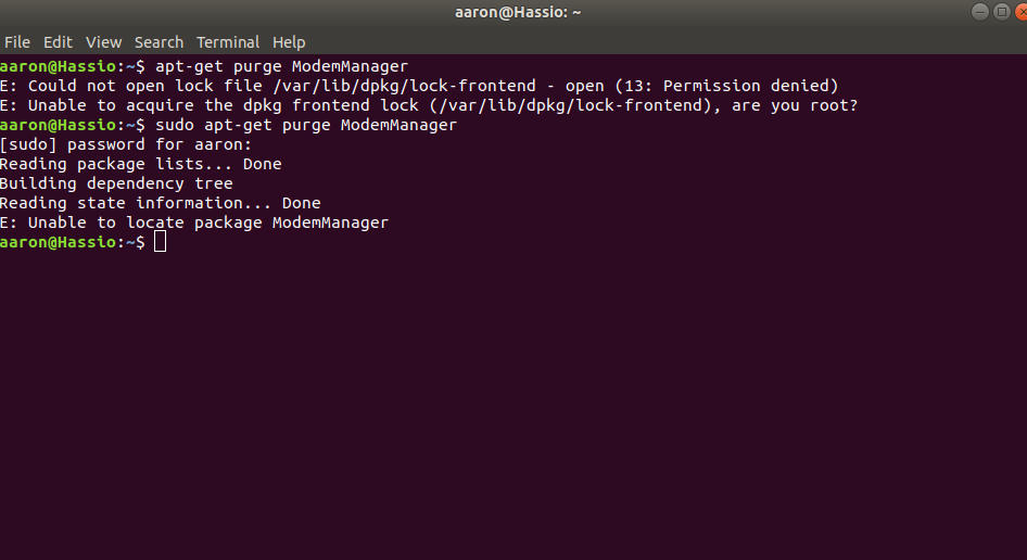

Since you’re running ubuntu remove the modemmanager just to be on the safe side command: apt-get purge ModemManager
Once you hit the Add Node button go to your device and do it’s inclusion sequence, I recommend doing this using your smartphone that way you don’t end up running everywhere.
I tried that before (did some reading :relaxed:) but this is what I get:
Sorry sudo apt-get purge ModemManager :stuck_out_tongue:
Getting further :grinning: But looks like it does not exist.
As long as it’s not installed zwave should work fine as long as you don’t unplug the dongle :stuck_out_tongue:
