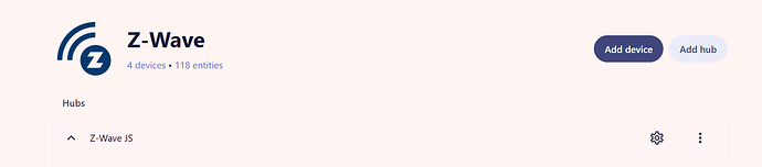

The integration shows “Z-Wave JS” when you go into it.
and then when you disable it the more prominent text says “Z-Wave JS” as well
I think that confused me - I thought I was disabling “Z Wave JS” add-in.
That’s the “name” assigned to the instance of the Z-Wave integration or “Hub” as it’s labelled in the first screenshot. Just like “LG webOS TV A996” is not the name of an integration, but the name of the HomeKit Device integration instance (or config entry as it’s technically called). But yes, I could see how that might have been confusing. You can rename that to anything you want by clicking on the … in the first screenshot.
