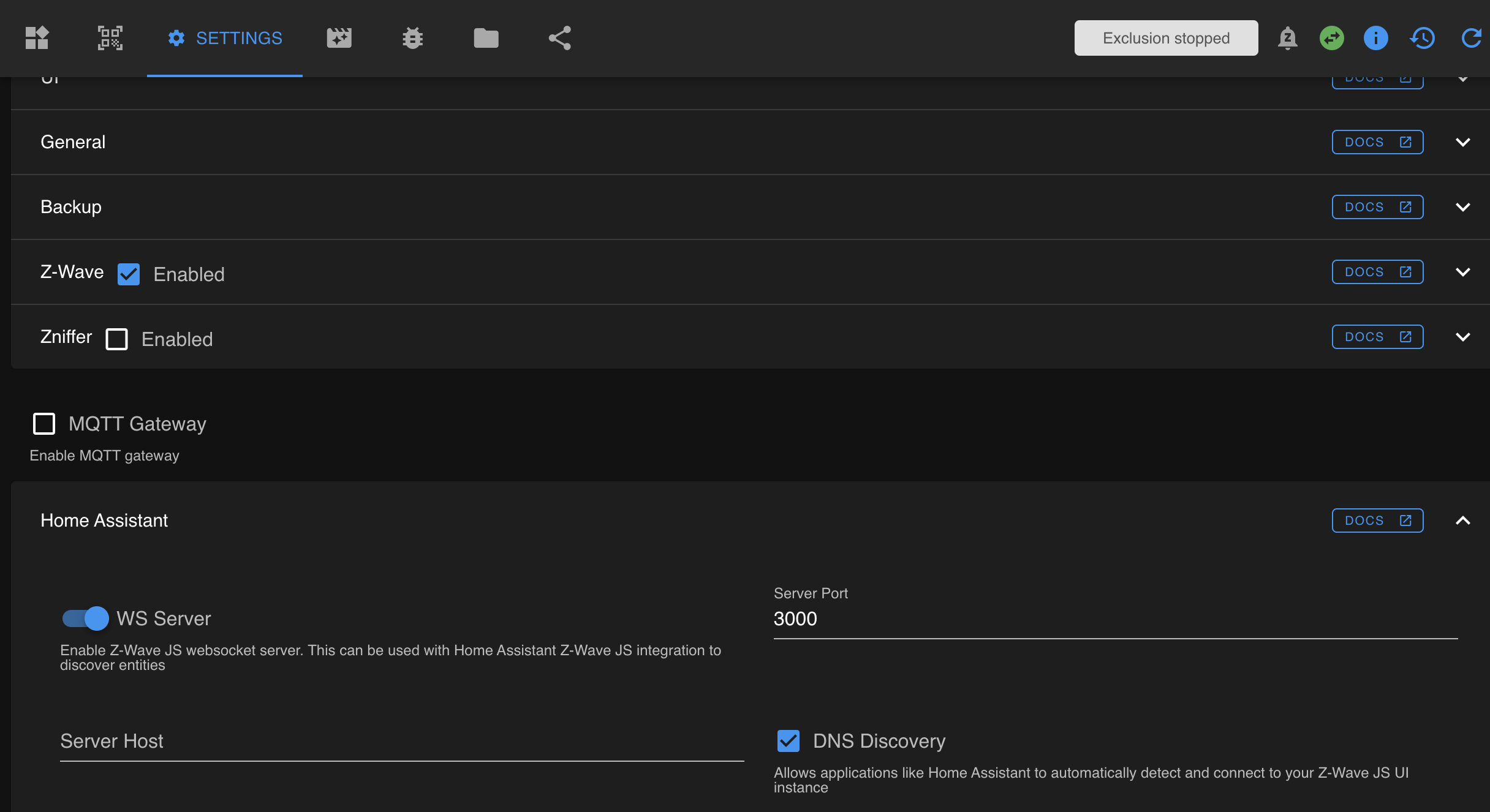

Post a picture of your Z-wave JS UI settings page, the “Home Assistant” section. Maybe we can figure it out.

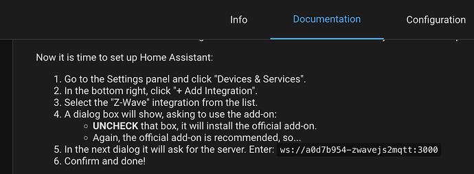

This is where I am starting, from the Z-Wave JS UI docs, my comments in italic.Its my undertanding that the official is Ver. 0.17 while the other is 10.something
Now it is time to set up Home Assistant:
  1. Go to the Settings panel and click “Devices & Services”.
  2. In the bottom right, click “+ Add Integration”.
  3. Select the “Z-Wave” integration from the list.
  4. A dialog box will show, asking to use the add-on:
    o UNCHECK that box, or else it will install the unofficial add-on.
    o Again, the official add-on is the recommended installation, not the custom one, so…
  5. In the next dialog it will ask for the server. Enter:
    ws://a0d7b954-zwavejs2mqtt:3000
    or ws://localhost:3000
  6. Confirm and done! Not so fast, restart HA

No clue what docs you got that from. Even zwavejsui docs, which is what that appears to be from, says “uncheck…or it will install OFFICIAL add-on”

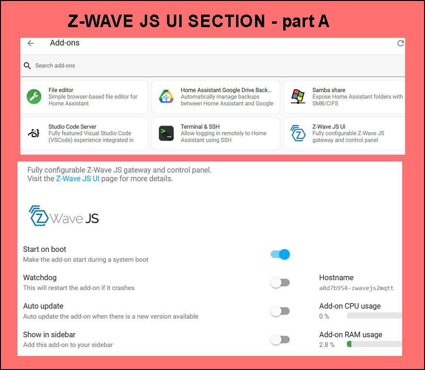

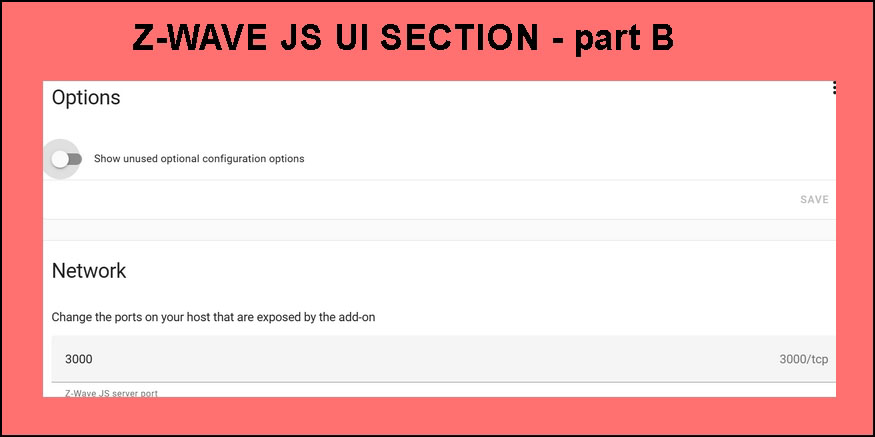

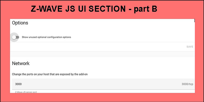

this is part A the UI section, part B and the home assistant section to follow.

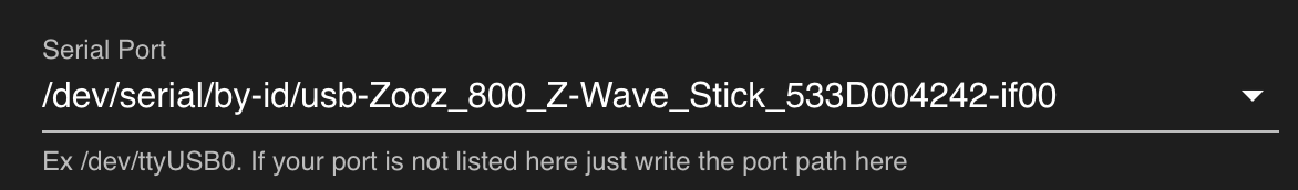

I am going to checj USB port assignments one more time. I also have a Zigbee stick that worked well. The USB port names seem long and are never exactly what the docs say
this is part B the UI section, part A previously
I am going to check USB port assignments one more time. I also have a Zigbee stick that worked well. The USB port names seem long and are never exactly what the docs say

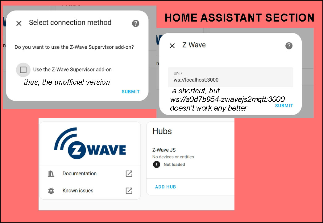

this is the home assistant section parts A and B of the UI section, were previously sent / posted.
I am going to checjk
First, there’s no reason to expose port 3000 in the add-on Network settings (and the add-on instructions never tell you to do this). That is never needed unless you have a very unusual configuration with two separate instances of HAOS. So you can remove that unless you are OK with the Z-Wave JS server exposed to anything on your local network with no authentication or encryption.
Second, server URL ws://locahost:3000 is incorrect in this case. As the instructions for the ZUI add-on state explicitly, the URL is ws://a0d7b954-zwavejs2mqtt:3000 (always for everyone using the add-on). If HA is not connecting with that address, then there is a misconfiguration of the Z-Wave JS UI settings or it has failed to start due to some error. Perhaps you should show screenshots of your configuration settings (don’t expose the security keys) in Z-Wave JS UI. Then also look at the add-on logs and post if necesssary. Make sure you have not changed anything in the Home Assistant settings panel of ZUI.
Yeah, it’s very unfortunate (and apparently confusing) that the docs mention “official” at all. But, I’m not clear why you modifed the instructions. The actual text is this screenshot:
Yes, the wording is confusing:
  • UNCHECK that box, it will install the official add-on.
… is really saying uncheck OR ELSE it will install the “official” add-on.
And why those docs say “Again, the official add-on is recommended, so…” just adds more confusion, IMO, and seems out of place considering those docs are for installing the UI version.
The USB paths are not the same for everyone, unlike the websocket address. Mine shows this, for example:
But, you said you can see your devices in the z-wave-js ui, so that means that is configured correctly.

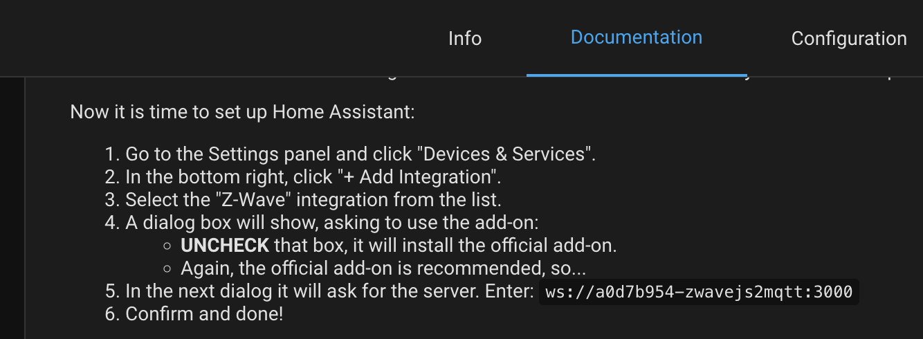

When I submitted my original post I included the instructions with my interpretations , i.e. " or else " in italics. As far as the websocket address, the first option that is presented is “localhost”. I have tried both options, localhost and the expanded one. Neither one loaded the Z-wave integration. The question seems to be, why is the integration not loading. As I write this I realize there are confusing terms all over.

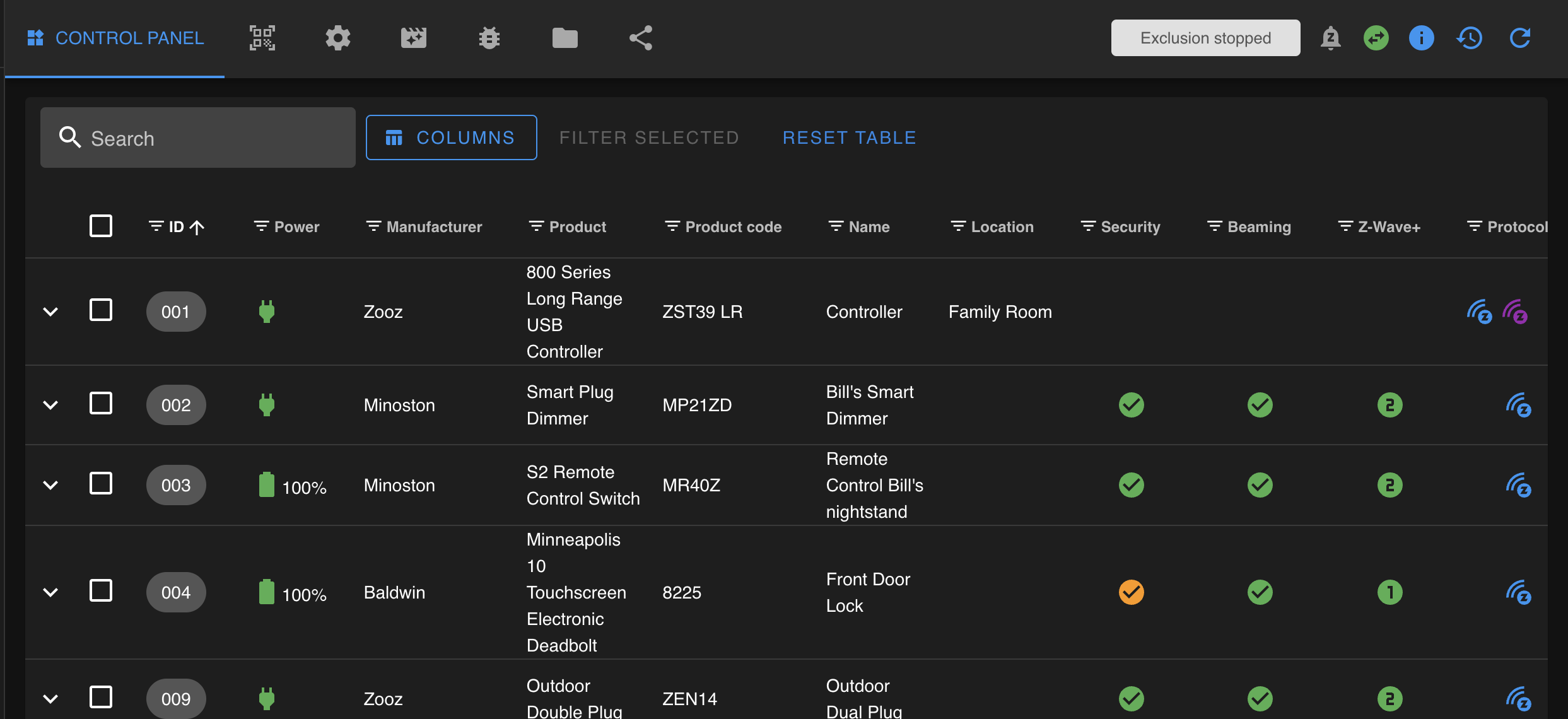

You mentioned that you can see your devices in ZUI, so it looks something like this, right?
Then you know z-wave-js-ui is working and communicating with your stick. You DO want to make sure there’s not another add-on talking to the same controller device, of course.
Next, make sure ZUI is configured to use websockets at the bottom of this part of the config:

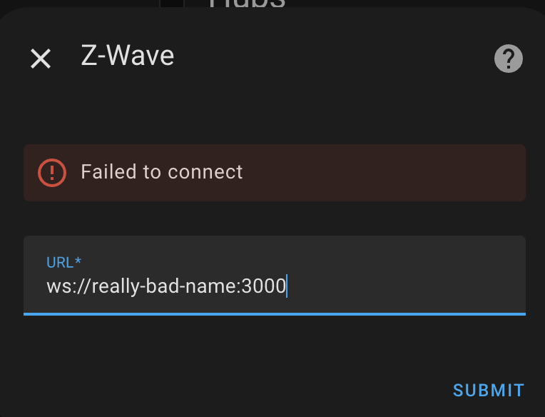

Then the integration (the code in Home Assistatant that talks to ZUI via a websocket) needs to be configured to talk to that open websocket.
If it is configure incorrectly like this I see:
(FYI – oddly! nothing was loged in home-assistant.log about it failing to connect.)

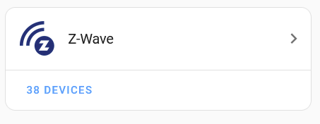

Does this appear on the Settings → Devices & Services page? This is the integration that you need.
There is no Integration called “Z-Wave JS”, just this “Z-Wave” one.
