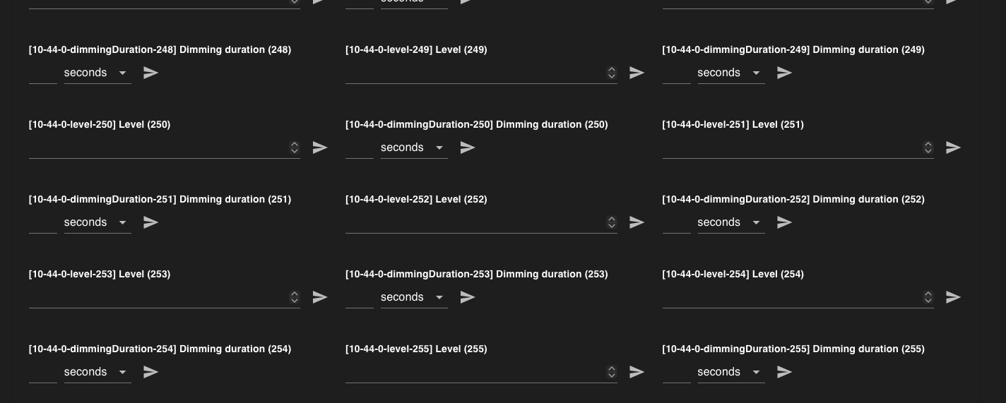

When I check the device configuration and I check:
Scene Actuator Configuration v1
I see an entry for “dimmingDuration” and “Level” from 1 through 255…
(with 70 some odd devices, you can imagine how long this takes)

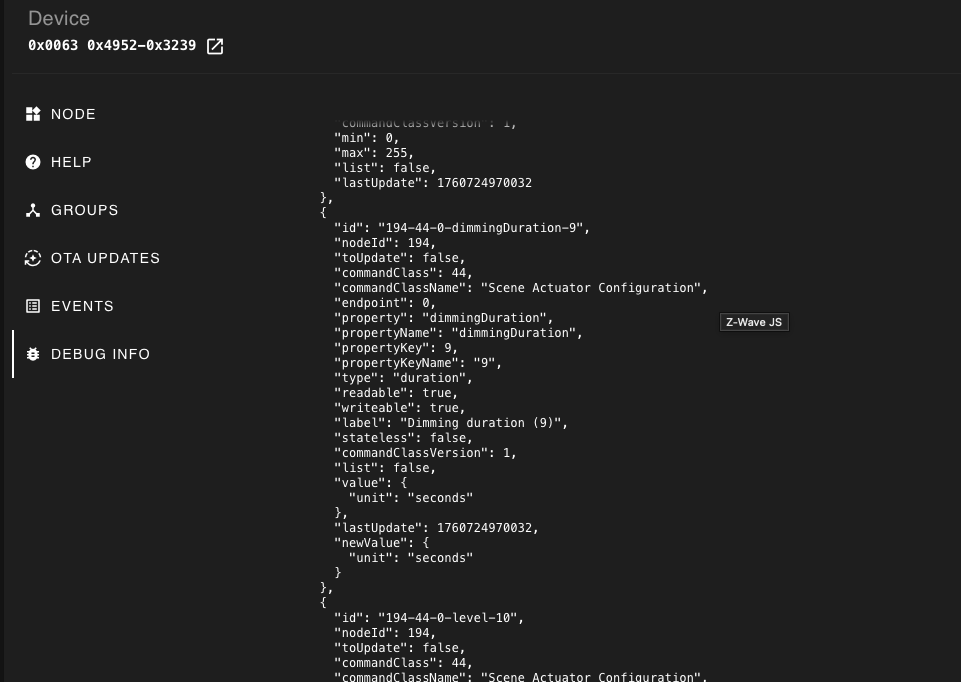

Here is the YAML of one of my devices.
You can see the “Scene Actuator Configuration”
for every device there are 255 entries:
So Z-Wave JS has to scan every single one of those CC44 configurations every time it loads.
Anyway to just shut this off?
