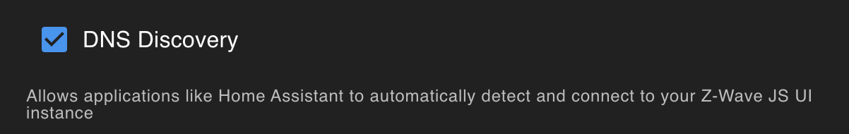

Discovery is enabled in ZUI:
zwave-js-ui: 11.8.2.a4e8747
zwave-js: 15.17.1

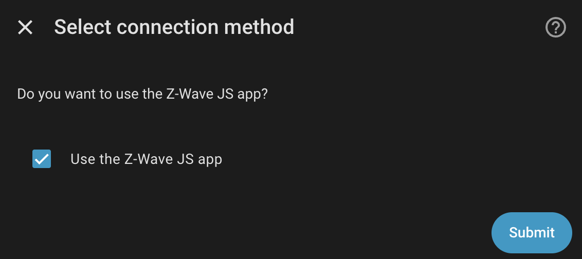

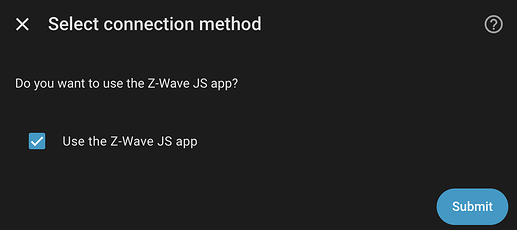

But, that leads to a secondary question. If I click Add Hub and then select a custom install I get this dialog:
I already have the ZUI “app” installed and configured with another hub. Shouldn’t it know that and not offer up to use the app?

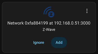

Then, when DNS discovery is enabled, you don’t manually “Add [a] Hub”. You go to the integrations page in settings and under the “Discovered” section it will show up as a discovered integration, and you “Add” it from there. There are multiple ways to add the discovered network, see next message.

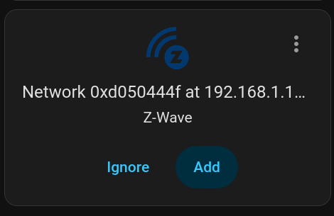

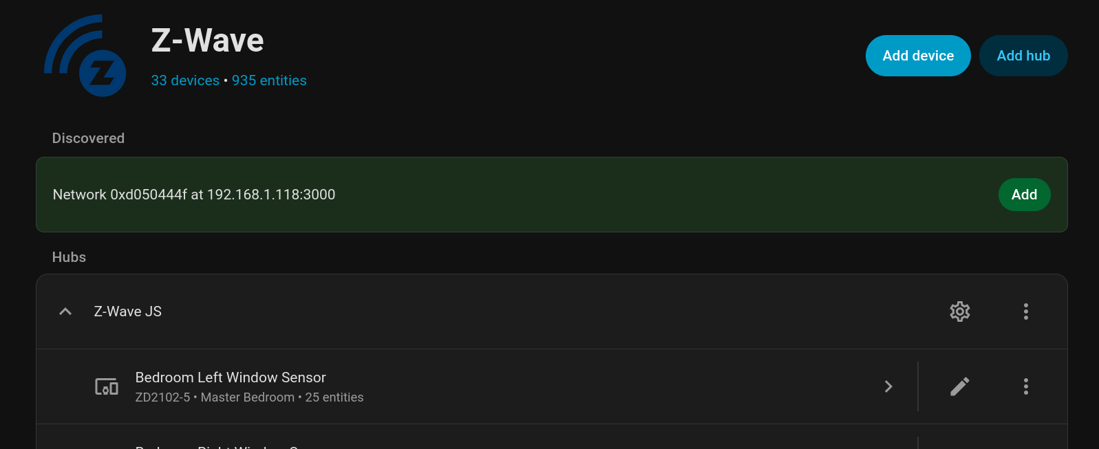

I’ve found there are actually multiple ways to install the discovered network:
From the Discovered section in Settings → Devices & Services:

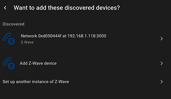

Or, if I go select + Add Integration from the same page I get a list:
That is the same list that shows when you select “Add Hub”, so my previous statement was incorrect.

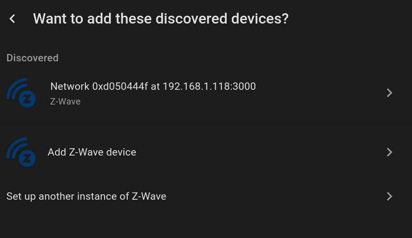

Or, if I navigate to an already configured Z-Wave integration it’s listed as a discovered hub:
There was one bug I found, which I don’t think applies to your configuration. If 1) you start with zero Z-Wave hubs installed, 2) there is a discovered one pending, then 3) you manually install a different network, 4) the discovered network will disappear. Restart HA and it will appear discovered again.

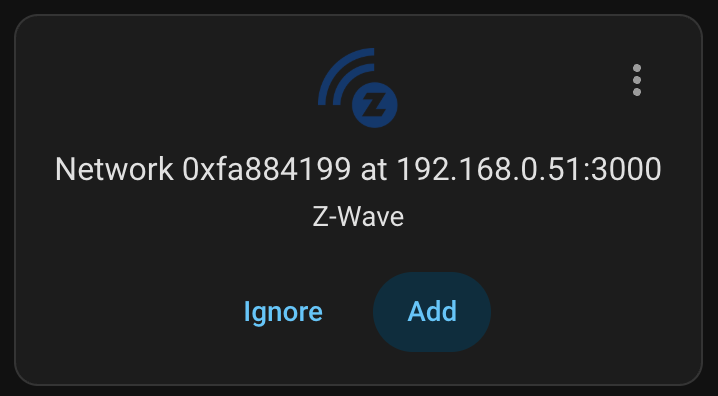

Darn it, @freshcoast, that was it. And I should know better. My other docker-compose.yaml files have host networking.
