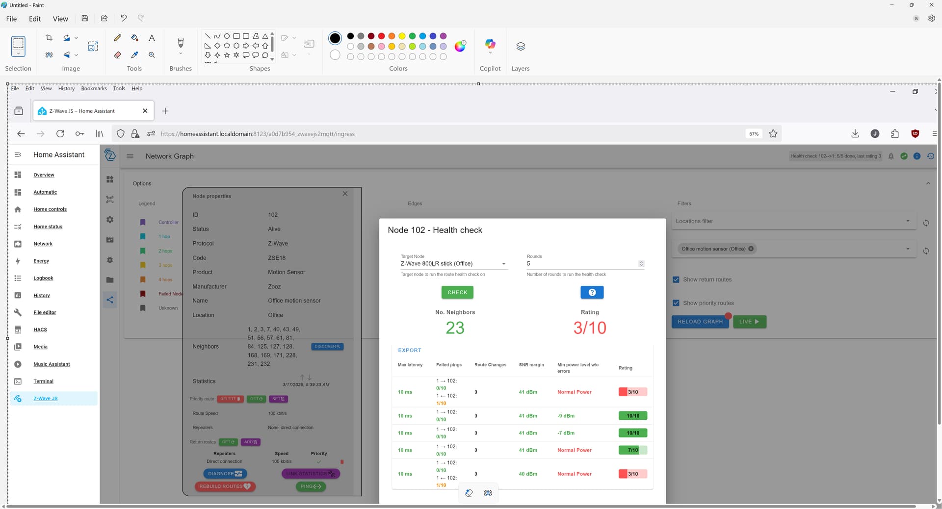

Meanwhile, I started running diagnostics (health checks) on various nodes. First, the nodes closest to the controller. I found this one particularly disturbing. This is a ZSE18 motion sensor. It is powered via USB, not batteries. It’s located on a wall, 5ft from the ZST39 controller, with a direct line of sight. The route shown in ZUI is direct to the controller - no repeaters.
Yet, it gets a 3/10 rating.
I really don’t know what to make of it. Is this a problem with the motion sensor ? The stick ? RF signal interference ? Or overloaded Z-wave bus from other malfunctioning device(s) ?
I can temporarily unplug all the plug-in and battery Z-Wave devices, but it’s a bit of a shot in the dark, and there are a lot of nodes to go through. My HAOS host being a beefy PC won’t last long on UPS if I want to debug without the hardwired switches.
I’m not sure what the community consensus is regarding health check and interpreting the results.

The specific node 102 shown in the screenshot had a direct route to the controller. After I ran the test, I even set one manually, and priority. It didn’t make a difference. I couldn’t get a 10/10 from this device.
The ZST39 is securely on the wall now. I tried to move the USB cable to a few different ports. The Asus Prime X570 Pro doesn’t have any USB 2.0 ports on the back, but it has internal headers, which I connected to the front of my case. I moved the USB extension cable to one of those USB 2.0 ports. No difference.

I conducted the test with all Wifi APs powered off, as well as the Comcast gateway powered off. The problem with the nearby ZSE18 - node 102 - still manifested. Again, it’s got a direct connection to the stick.
I tested a few other Z-wave devices, and had a bit more luck. The ZEN76 that controls my office ceiling light got 10/10 in the health check. So did the ZEN76 on the other side of the wall that controls the porch light. Same for the ZEN32 scene controller in the same wallbox on the other side. The Kwikset HC620 lock, even though located 3ft away, got a much worse result.
It looks like there are some devices that work OK, and some that just don’t, even at extremely close range with direct line of sight, and no repeaters in the route.
I got a few ZAC38 repeaters outside the office (which has the stick) to get 10/10 . But most other nodes aren’t going through these repeaters. They are trying to talk directly to the controller, even though the signal strength is too low. I can try to build some routes manually for more nodes and see if it will improve things. For the nearby rooms, that seems to be the case. Not sure that will hold true for the distant ones. It is a huge place.
