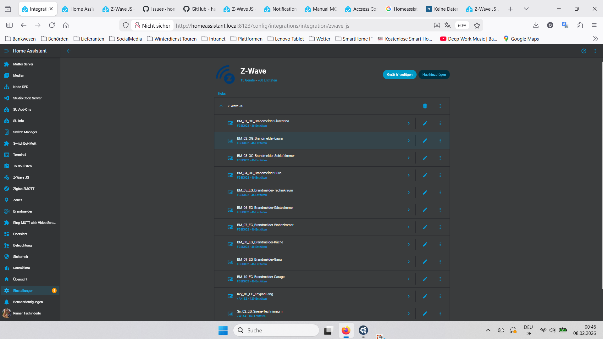

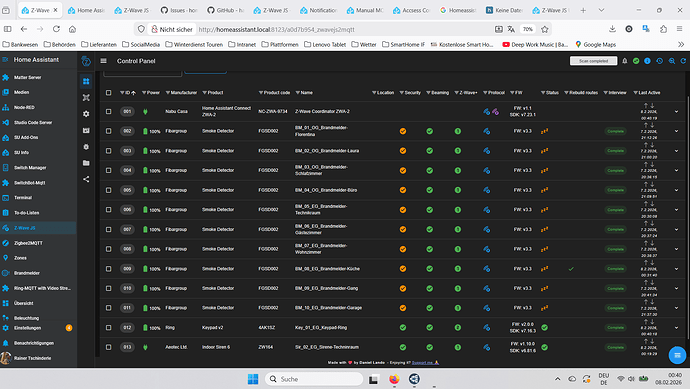

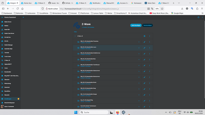

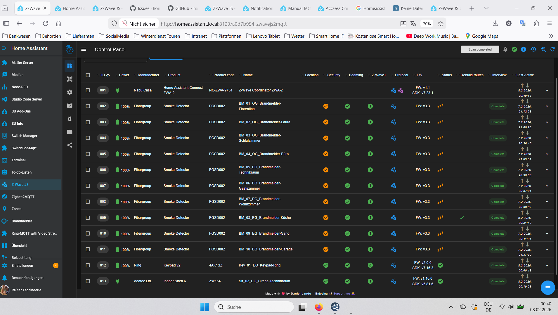

Ive connected 10 Fire Alarm ( Fibaro Smoke Sensor 2) via Z-Wave, used the ZWA-2 Coordinator, the Z-Wave JS UI Integration and MQTT.

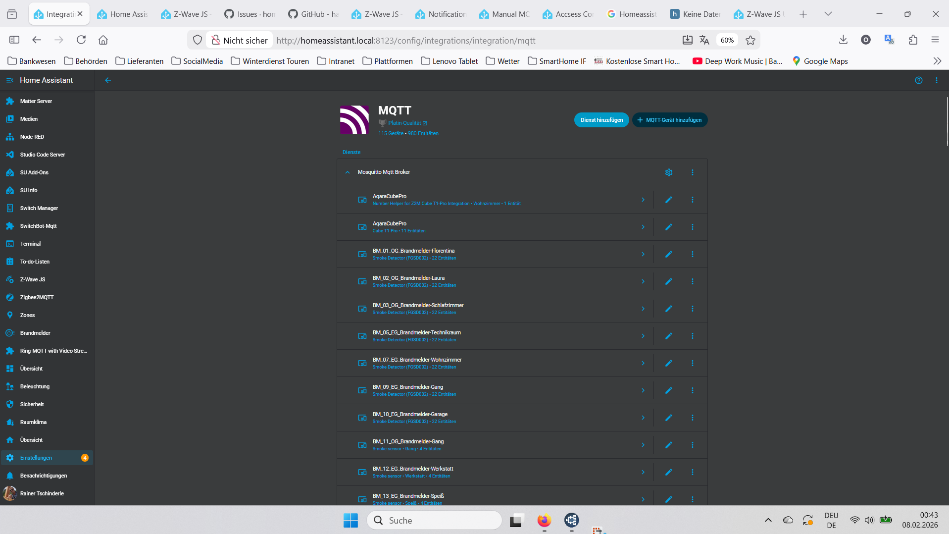

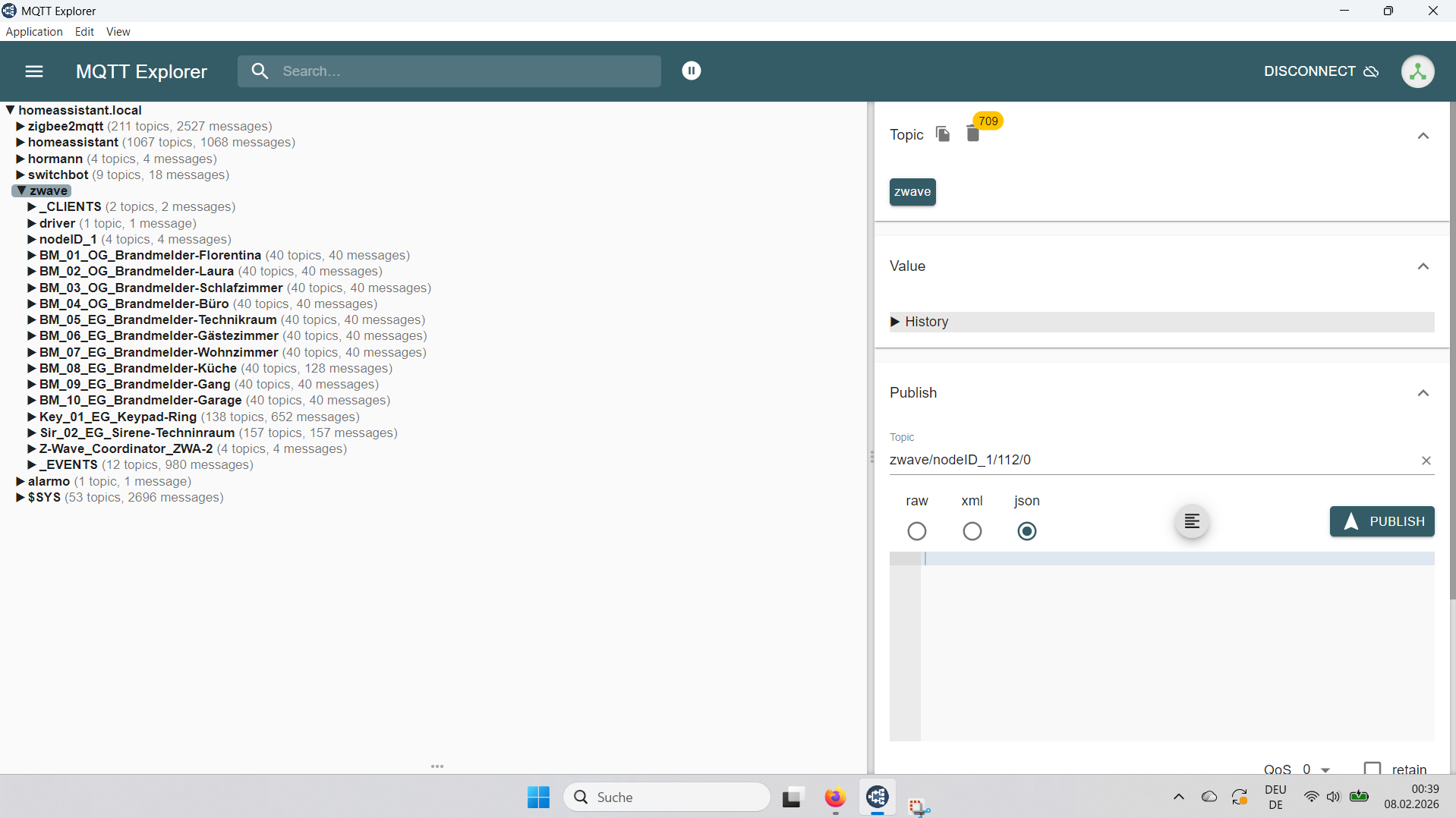

When i Check via MQTT-Explorer all 10 devices are shown, but in the MQTT Integration 3 from 10 Devices are not integrated…

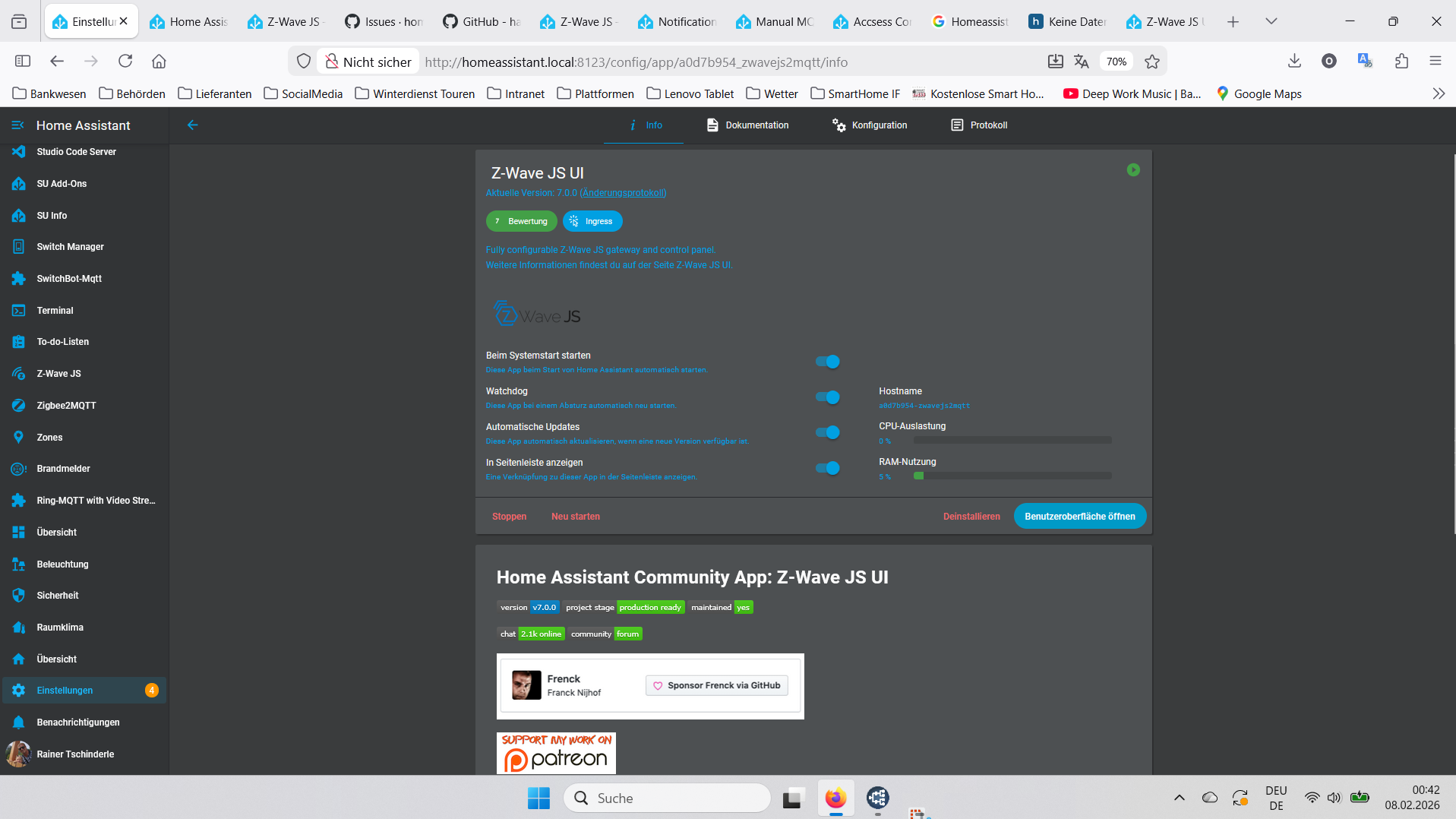

I Don´t know what the problem could be, i searched a lot on ggole, restarted everything, installed/deinstalled all addons and and and, couldn´t find the reason why.
Does anyone have an ides what the problem could be and how to fix it?
I´ll post some screenshots from everything.

For Z-Wave just use the Z-Wave integration. There’s hardly any reason to use the MQTT integration, and even less reason to use both of them at the same time.
You can keep MQTT enabled if you want, but don’t bother with the integration aspect.
