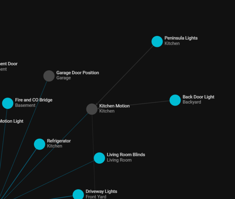

Z-wave js UI (app) has had a network map for a long time and it’s very useful. Earlier this year, core Z-wave js added a graph feature as well.
The problem is the graphs do not match. The z-wave js (core) doesn’t make any sense. It has devices routed through non-router devices. How’s that possible?
You can see an examples below. The first graph is from the UI app. It shows correct routing through a mains-powered device “ceiling center light”. The second picture is the core z-wave map. It shows multiple devices routed through a battery powered device “Kitchen Motion”.

I see this problem as well. The core shows one of my end devices using a battery remote for its connectivity… So seems to me its a bug.

Confirmed. The z-wave map was corrected in version 2026.9.0.
