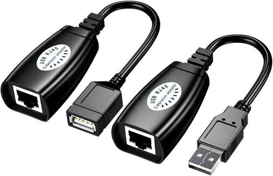

They usually cost less than $10, just search using the keywords ”usb rj45 extension”. They should all work as they are just dumb pass-through adapters and have no electronics so do not cost a lot. Cheap chinese manufacturers make them and anyone will do. See search example:
I have some different kinds and all work. I know some of the ones I bought myself looks like this and work great as long as use a good quality Ethernet cable with them:
https://www.amazon.com/s?k=usb+rj45+extension&crid=3QWN07FNTICC&sprefix=usb+rj45+extension
Thank you very much. I ordered a pair.

I finally got around to installing these USB - Ethernet extenders last week, after a the end of a long home construction project. I used a CAT6 Ethernet cable that’s about 25ft. Things unfortunately did not improve with my Z-wave signal problems. I also noticed that the Z-Wave JS UI add-on failed to initialize the controller on startup on two occasions - once after an OS reboot for patch tuesday, and another time after I restored an HAOS backup. A manual restart of the add-on fixed it. I have never seen this behavior before when the ZWA-2 and ZST39 were connected via a regular (but shorter) USB 2.0 extension cord. Since it did not help, I reverted to the regular USB extension, and have not seen the problem again.
