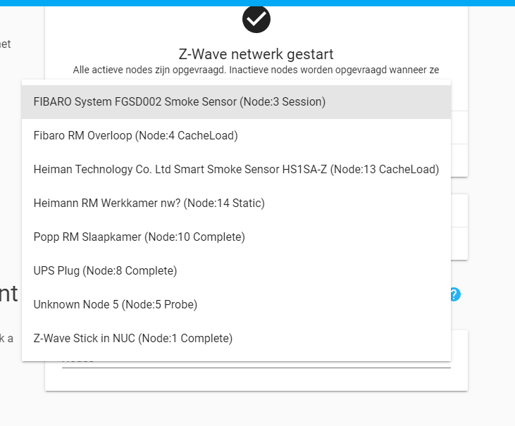

Now I have plugged the Z-Wave USB into the HASSIO server without any adjustments from the Domoticz Pi, and I also see that there is communication with the POPP and the plug.
According to the config the Fibaro sensors would also work, at least I see the temperature graph.
I tried to register two of the Heimann sensors several times, it looks like they have been registered, but I don’t see any changes, some are unknown or something …
The large amount of components that the sensor produces also does not really help to choose the right one.
Now I have tried to trigger the Fibaro and Heimann detector with smoke, this works really well (the siren can be heard) but I see nothing in H-A turning into alarm …
I have now installed the Z-Wave Graph and see half a network.
