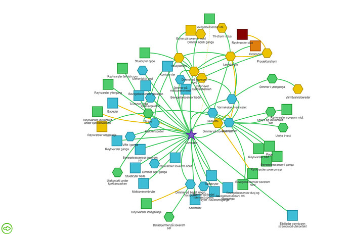

The 58 devices on the network are within ten meters from the controller, and the mesh seems to be OK too. The red one is a battery powered smoke detector:
No. I don’t believe so. When it is primary cause dropped is in hundreds or thousands. You won’t need to ask.

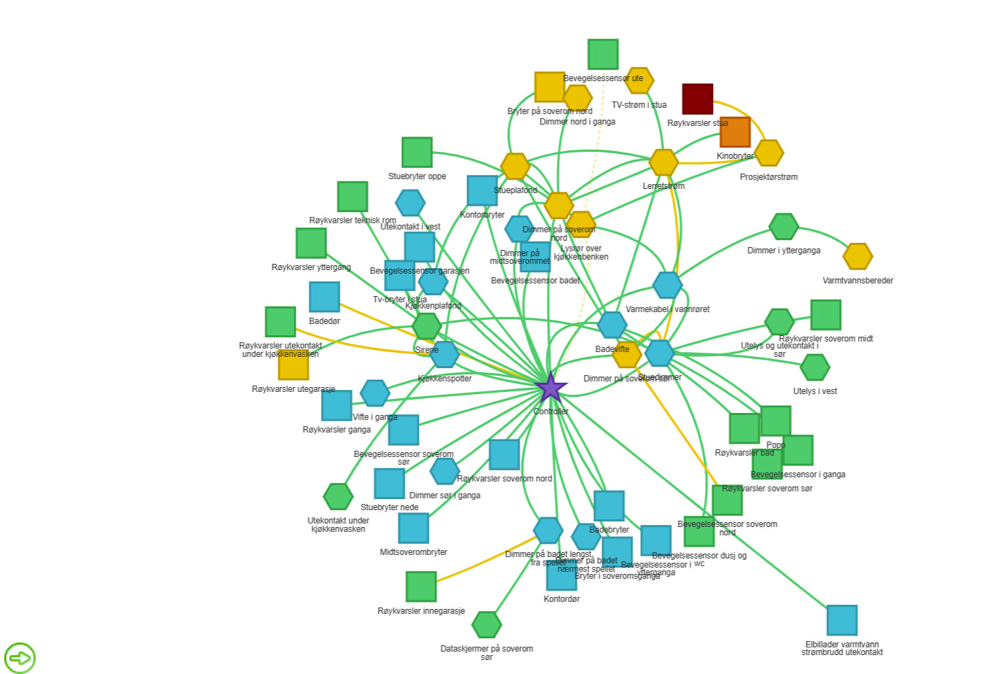

The dimmer must have been it. It’s been two days now (one day was without power because of the storm Dave), and no delays since I replaced that. THanks for the help, I have disabled the “self heal” reboot at 04. The dropping has dropped too, especially of messages, that’s totally gone with twice as many messages as my previuos screenshot, where there were 12 TX and 3 RX dropped. And the RX total commands dropped is one third in twice as many messages:
