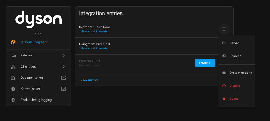

Once the device is removed from Zigbee2MQTT you should be able to go here and delete the device from the MQTT integration.
I have never had to do this before (deleting from Z2M has always removed from HA until now) so was not even aware that menu option existed! I was trying to delete from the menu in the top right-hand corner (where I have deleted my non MQTT devices in the past) eg:
So, thanks to you and @P6Dave, now I know that a delete option exists where you pointed me…
…it is now deleted! :partying_face:
Thanks to everyone for their patience whilst I slowly realised what you guys always knew.
Thanks! I did that but it didn’t remove the device from HA (even after restarting everything, HA, Z2M, my Pi).
@ddaniel and @P6Dave pointed me in the right direction with their screenshots of where the ‘delete’ button was for MQTT devices in HA.
