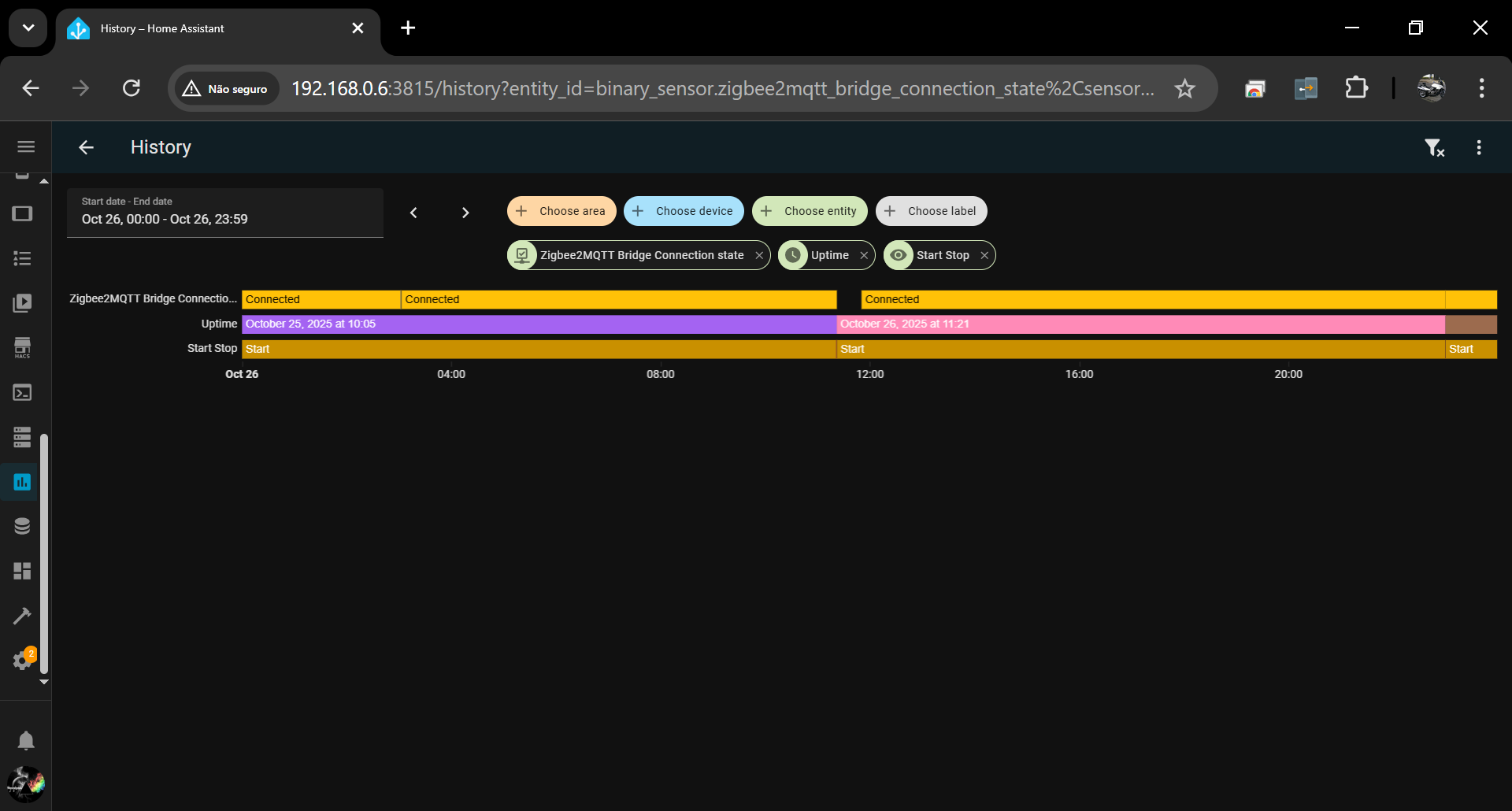

If you look at the screenshot I sent, I updated around 11:20 and the z2m was disconnected for a while until I manually restarted it.
Around 23:00 I manually restarted HA and the z2m remained connected.
