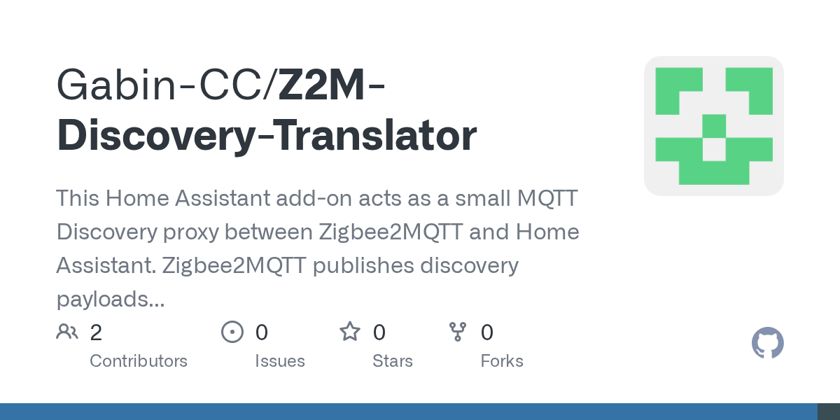

GitHub:
Feedback and translation contributions are welcome.
