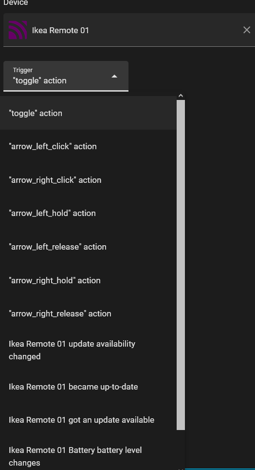

I have this remote paired with Z2M: IKEA E1524/E1810 control via MQTT | Zigbee2MQTT
Sadly, only some actions are available:
I am missing for example "brightness_up_click and the hold and release actions.
These actions were all usable with Deconz though…

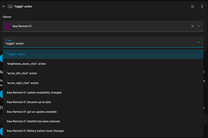

Alright, gonna see if I can figure it out. I cannot even seem to enable the flag in Z2M, “Home Assistant experimental event entities”, get an error saying
“Extension with name HomeAssistant already present”. Not sure what is up with that.
At least I can use 3 of the buttons using the regular trigger lol.

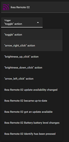

Its strange… I have 3 of these ikea 5 button remotes. Remote 02 and 03 has left, right, up, down and toggle as expected:
But remote 01 does not have up and down brightness buttons:
They are the exact same model number and have the same firmware installed.
