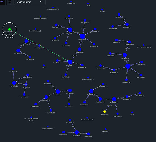

Here’s a pic of one of my zigbee maps. I apparently don’t know how to interpret it though…it looks like the coordinator only has one connection, but the data view shows it with 16.
I don’t have a practical way to keep all the lights powered all the time from right now. I hope to eventually get them all onto smart switches and have them powered all the time…but it’s going to be several days at least and I can’t leave them on all the time. And at the moment I can’t reliably turn them off from HA.
Wow. Yeah that is one fractured network.

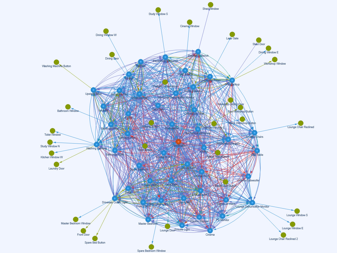

This is what your mesh needs to look like:
Also try this mapping tool, it does a better job at showing all the routes than the Z2M map: Zigbee Map - Visualize your mesh network
