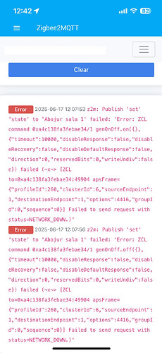

Hi! Started having some issues in Zigbee2MQTT after updating Home Assistant Core to 2025.6. I believe I was in 2025.4 before.
It happens a couple times a day, like every 3 hours. I can access Z2M front-end and try to turn on and off devices by they won’t respond. After rebooting Z2M it will start working again immediately every time. I uploaded an image to show some of the errors I’m getting.
