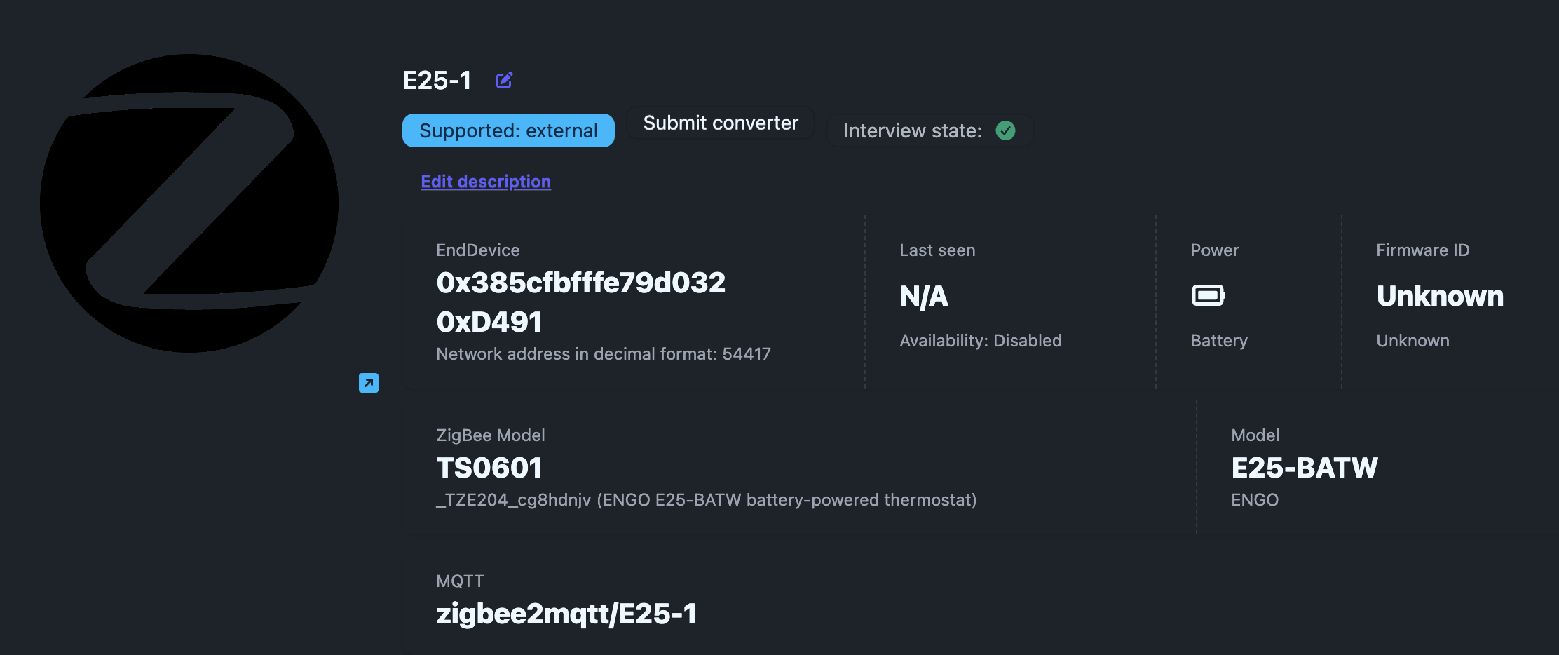

Hi, I’ve been trying to add an unsupported device, but Im struggling to make it work.
The extension file has been loaded successfully and I see the Expose elements in Z2M dashboard under the Exposes tab.
I added just 2 elements - child_lock and local_temperature for simplicity and testing. I took the exposes and meta from an almost exact same product (just 230V instead of battery powered) and confirmed both DPs from logs.
But I can’t seem to get the reading of local temperature and whenever I try to lock/unlock the thermostat I get the error of
z2m: No converter available for ‘child_lock’ on ‘E25-1’: (“LOCK”)

I did restart Z2M and checked in logs every time after the restart if the file was read correctly.
The issue turns out was in the file itself. The second exposes: [] part was canceling out the first one. Once I removed that, the thermostat was paired and worked well… for couple hours. Then it disconnected. And it keeps disconnecting after 1 to 5h and every time I have to factory reset it. Any ideas how to solve that?
