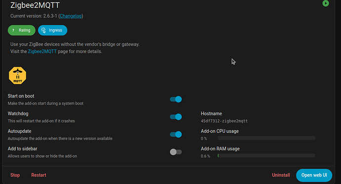

are you getting or not getting the open web ui icon at bottom right?

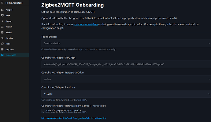

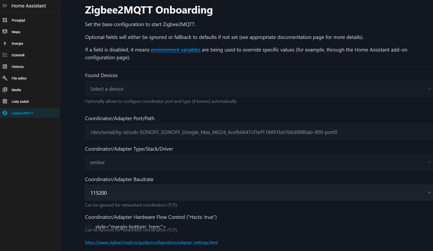

I have Icon to open but screen looks
ZHA is not integrated, rtscts: false, configuration as shown above. I have no idea what is wrong.
Set onboarding to false
no change after that
Could the fact that the HA is supervised cause this problem? I don’t think it should have any effect, but I’m looking for a starting point.
Problem solved - I added “#” before
Onboarding page is available at http://0.0.0.0:8099/
and it works
