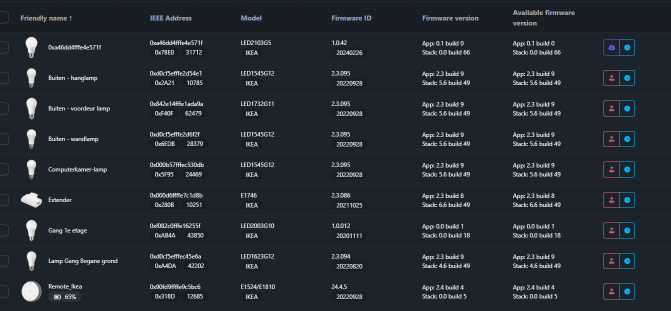

Not very clear from your post, but do you actually see an OTA update if you go to Z2M > OTA section?
If you do, then all you need is to wake up the device by pressing any button, then click Update device firmware (red button in my screenshot) immediately afterwards.
Otherwise, click Schedule Update (blue button in my screenshot) and it will update by itself when it next checks for updates.

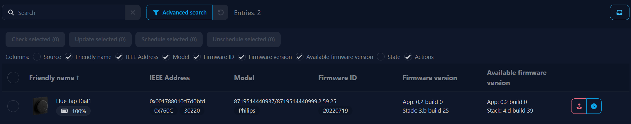

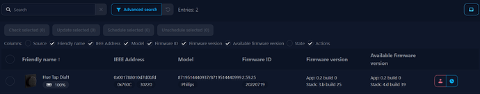

In the OTA Page, only IKEA products are visible.

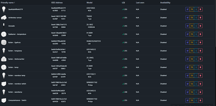

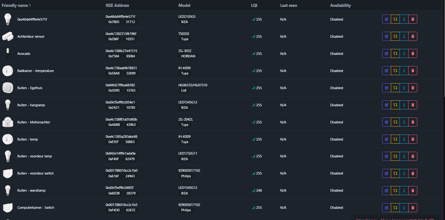

And here is my full list.

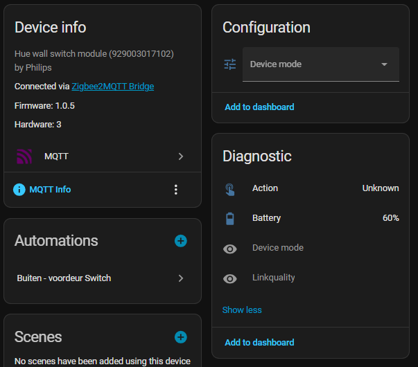

What I see in HA, is that only IKEA has a Configuration check for firmware.
And Philips and others dont have.
