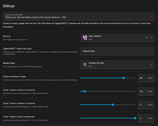

This blueprint is evolved from @gTunes blueprint. It has since been altered by others both to keep it working and for full customization instead of binding three buttons to media controls. The only thing I’ve done is to update the template syntax to the new syntax and translated some comments to english.
The blueprint supports controlling a media device and additional custom automations with a Philips Hue Tap Dial control. It is specific to Z2M.
Features of this blueprint:
  • Simple selection of a single media device to be controlled
  • User-specifiable volume steps - if your physical device uses a volume range other than 1-100, you can specify that range and this automation will scale incremental steps appropriately
  • The controller generates three rotation speed events : step, slow, and fast. This blueprint allows you to specify how many volume increments should be applied for each speed. You may, for example, set “step” to 1, slow to “3”, and fast to “5”. Because some volume ranges can result in rounding or truncation issues downstream of the automation, the blueprint allows these steps to be set as decimal values such as “1.5”
  • Both Short press and long press of all 4 buttons are configurable. Do whatever you like with them.

Setup:
Select your device, adjust your MQTT base topic if necessary, the choose the media_player to control.
Choose volume steps, increments, etc. and configure the custom sequences as desired.
