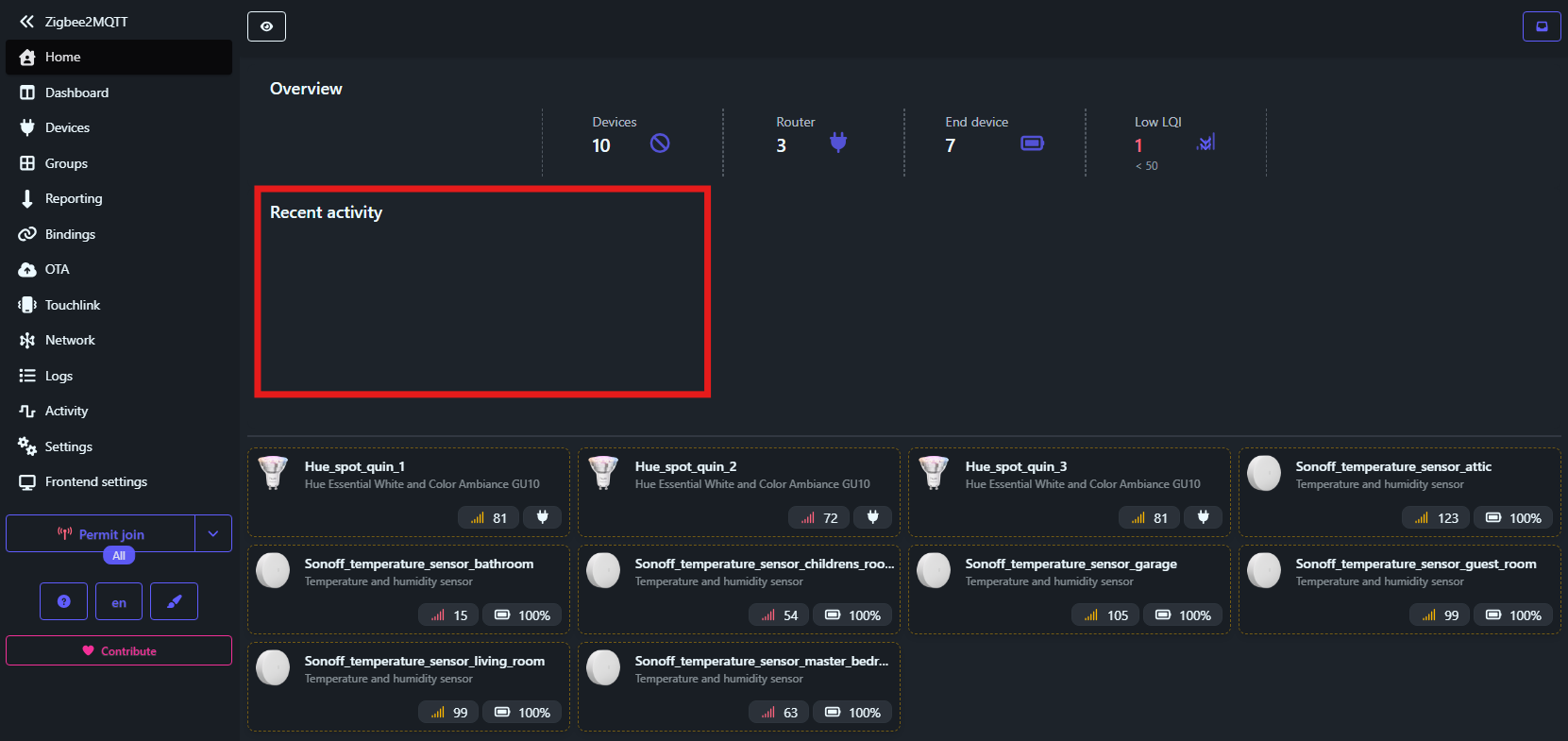

I have HASS running on a RPI 4 and recently switched from SD card to SSD. This change went fine, only the Zigbee2MQTT app did not start afterwards. I don’t know how I fixed it, maybe a few restarts helped. But now the app is running and I see all my Zigbee divices which all received a initial value, but have not update since.

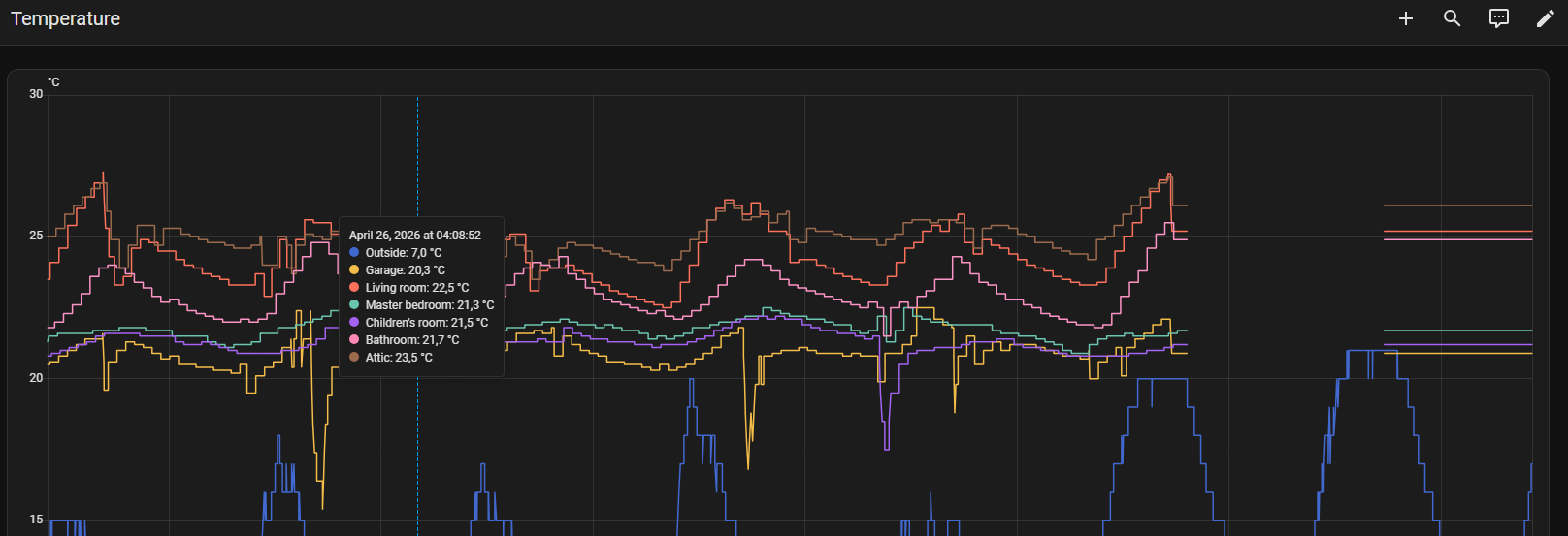

Example of a dashboard with some temperature sensors that worked fine before the change.
Any ideas how to resolve this?

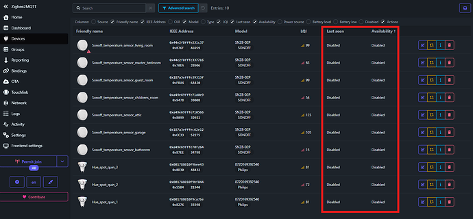

I am running HAOS on a RPI4 with a SONOFF Zigbee 3.0 USB-dongle Plus.
The RPI has a fixed IP address, this hasn’t changed. The only new hardware is a SSD via a USB adapter that is plugged in. I checked the serial port, and it is still exactly the same.
serial:
  baudrate: 115200
  rtscts: false
  port: >-
    /dev/serial/by-id/usb-ITead_Sonoff_Zigbee_3.0_USB_Dongle_Plus_f67af1e6a46bef11910e97adc169b110-if00-port0
  adapter: zstack
I’ve checked, and it still looks correct. I use the ‘by-id’ path.

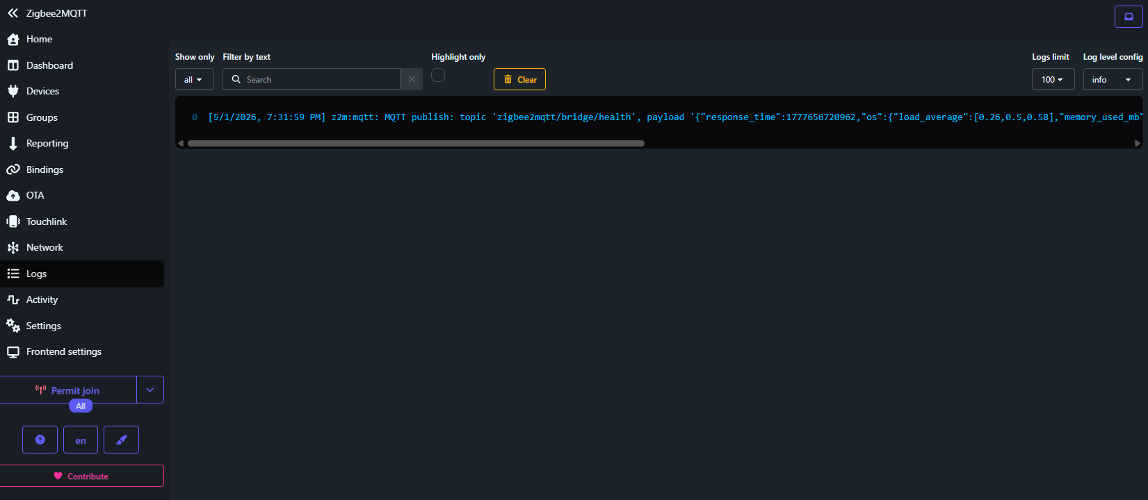

I don’t see any activity in Zigbee2MQTT.
Only a very old log.
How do I upload the logfile? There is no such option here.
You can copy the text & paste it here. Format it in code tags (like you did for your Z2M config) so you won’t end up with a wall of text.

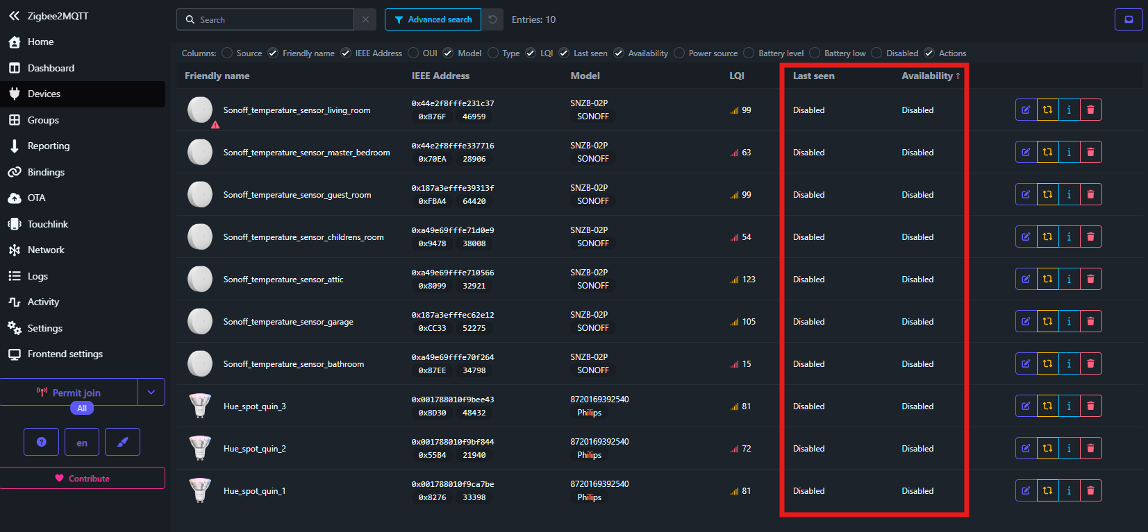

All devices remain disabled.
Edit: I see some changes now. I pressed the button of 2 devices which triggered an update. A third device updated without manual push. I’ll monitor it for some time.
Keep an eye out for that error. Looks like your coordinator is cutting out for some reason
Everything seems to be working correctly now and that error did not occur anymore.
