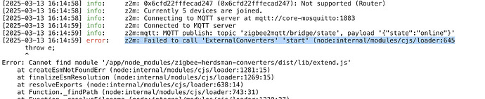

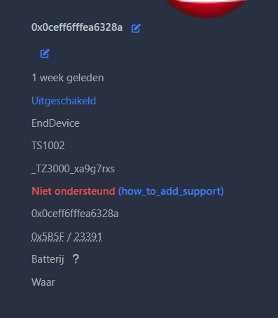

Added the file here:
But after restarting, still got this:
What am i missing? Nothing useful in the logs of TZ3000 :frowning:

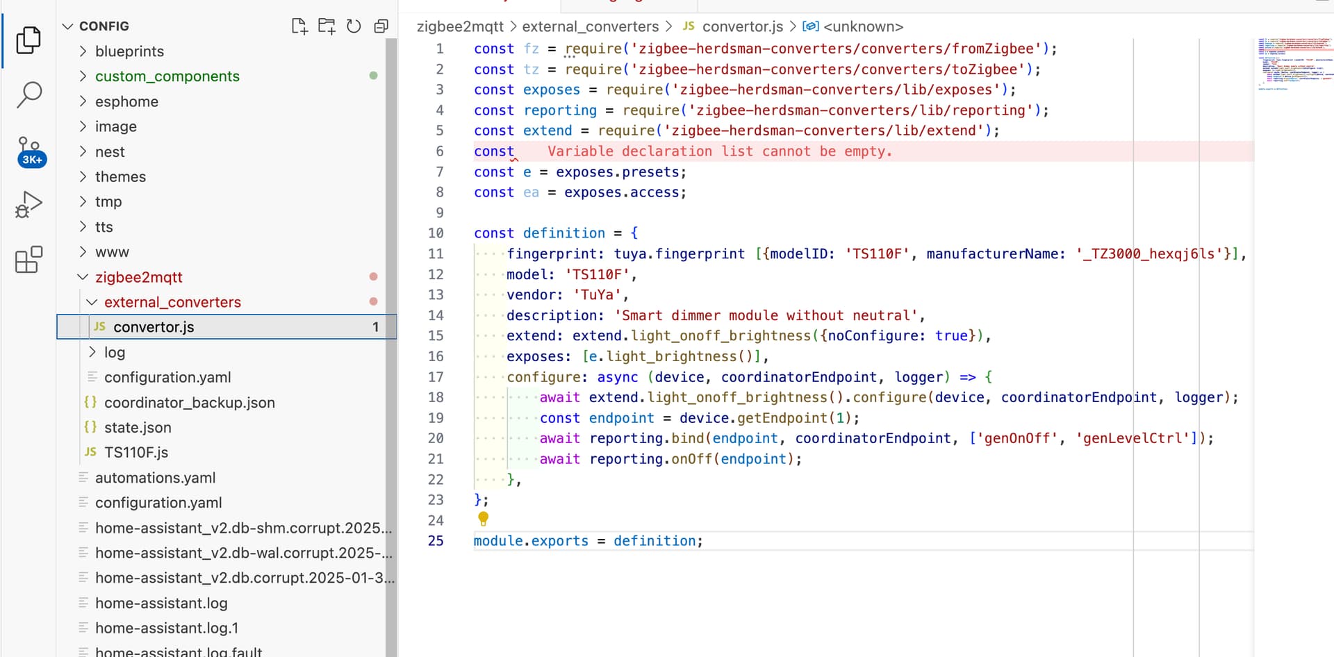

I’m struggling with this to i created a folder via Terminal zigbee2mqtt/external_converters
but im still getting the error: z2m: Failed to call ‘ExternalConverters’ ‘start’ (node:internal/modules/cjs/loader:645
this is my file structure
Have you restarted Z2M since you created that folder? Also, swat happens if you delete line 6 in your convertor.js (the one with the obvious error)?
