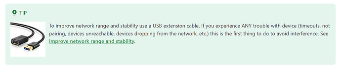

Trying to get this to work was incredibly frustrating and then the fact that no one responded here was also frustrating.
I think what I did to get this to work was to flash the zigbee stick, remove the coordinator backup, and edit the z2mqtt config to change all the numbers to “GENERATE.”
At that stage I kept getting errors that said there’s already a network with that PAN which I don’t understand at all because I was asking it to configure a new network ¯\_(ツ)_/¯
an llm told me to buy a usb extension cable so I did and then that fixed the problem.
Good luck to anyone else trying to get this mess to work.
It’s on the first page of the documentation, but I’m glad you got it working.
Thanks for pointing that out. Of course, your post would have been helpful months ago, but now just feels like criticism.
