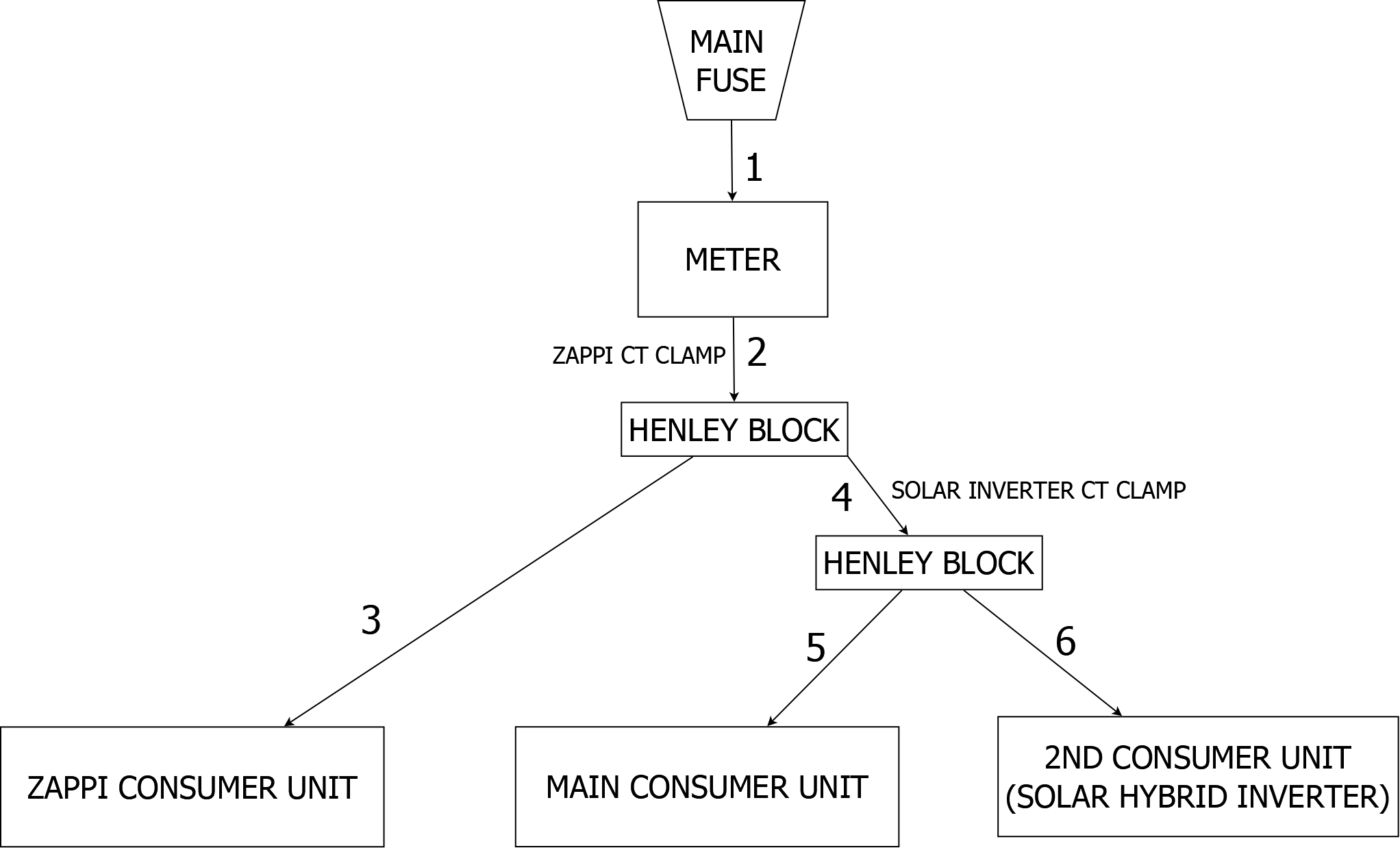

I am trying to get to grips with my new Zappi Glo EV charger, which was installed a couple of weeks ago. We have a FoxESS solar PV installation (KH7 inverter and EP12 battery). The wiring is as per the diagram. The solar inverter is connected to the dedicated 2nd consumer unit and the Zappi is likewise connected to its own consumer unit. The intent of the setup was to prevent the solar battery from discharging to the Zappi by default.

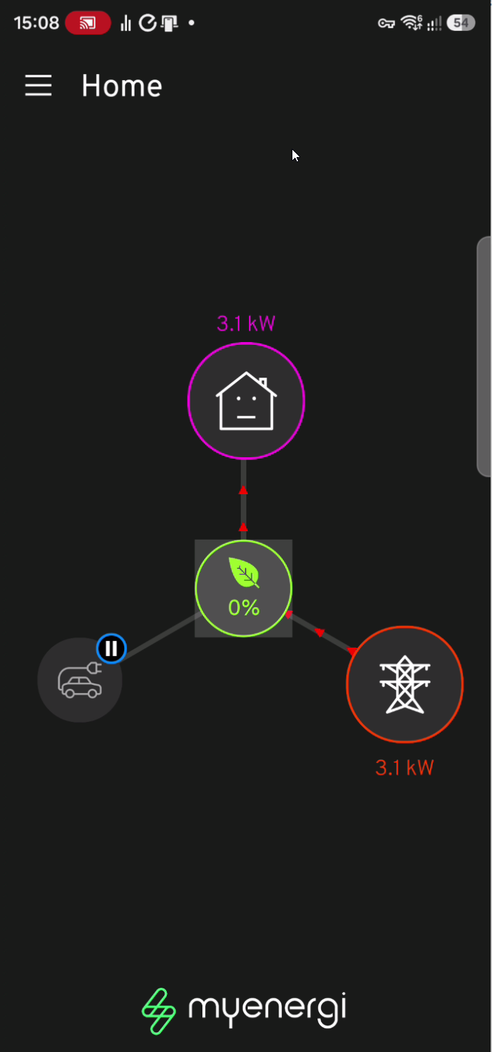

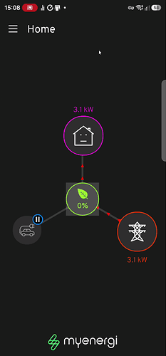

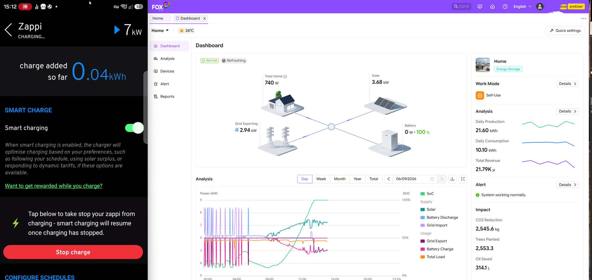

I tried to charge using surplus solar yesterday. At the time there was around 3kW excess solar being generated. The Myenergi app seemed to recognise this - recording 3.1kW of available “grid” energy just before it started charging. But then it started charging at a rate of 7kW, 4kW of which was imported from the grid.
How can I get it to charge from surplus solar only, which I thought was one of the main benefits of the Zappi?
