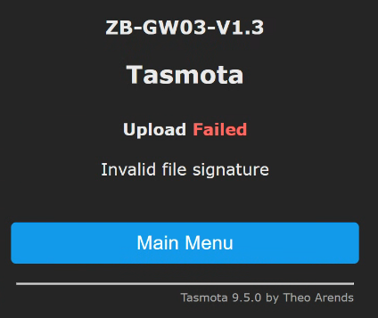

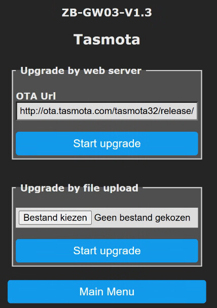

I have tried it through the “Firmware Upgrade”
But that one failed:
I found this in the console:
12:58:14.863 UPL: File ncp-uart-nsw_6.7.9_115200.ota
12:58:14.886 UPP: Multicast (re)joined
