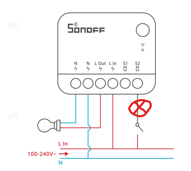

I wonder if it is allowed, and if it would work if I connect my ZBMINIR2 like shown on this drawing. The X is a lamp with is in series with the switch.
FYI, I simplified the setup. I have 3 switches controlling 2 lights. This seems the easiest solution.
No.
Thanks Sir!

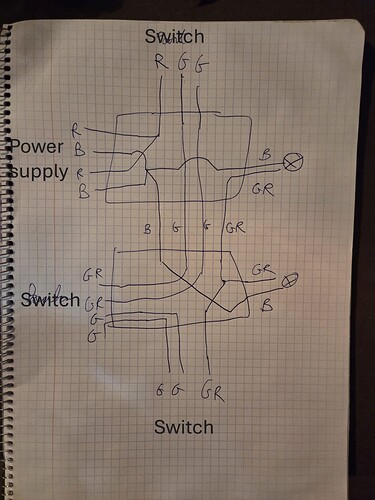

3 switches, so you have a 3 way switch for the 2 lights?
Why don’t you write what you’re actually trying to achieve (especially with “x” lamp) ? Then it’ll be easier to help…
but, in short: you can’t separately control 2 lights with one channel module.
Hi all,
I have 3 switches controlling 2 lights. I would like to add a ZBMINIR2 to turn them on based on door switches.
