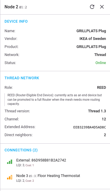

If I go into the Matter server web interface and look at the Thread Network Mesh it looks like this:
Is it normal that my ZBT-1 isn’t even showing up? If I view the node details for one of the devices on the “map” it looks like this, the border router showing up as “external”?
Any ideas? Is this normal?
Yes. A thread border router is not a matter device.
It will show up in the map if actual matter devices are attached to it, which doesn’t seem to be the case here.
