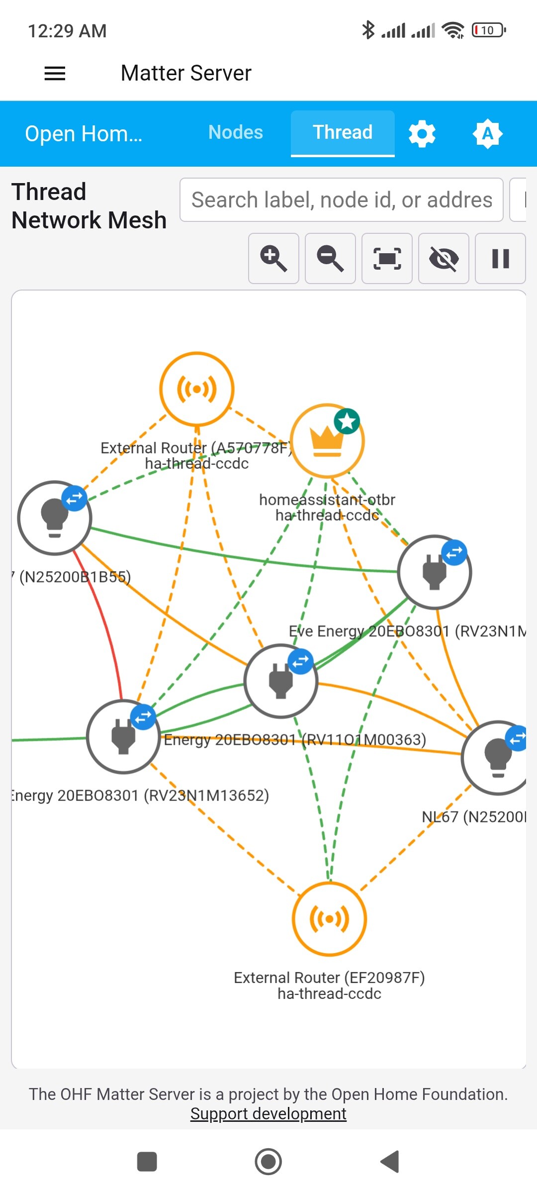

I updated my Matter Server from 8.x.x to 9.0.2 (9.0.3 now) a couple days ago. To be honest, I didn't disable watchdog (my bad), but Gemini assures me the migration went smoothly - I only have 6 matter devices.
Basically I'm wondering about the new Thread visualization menu.

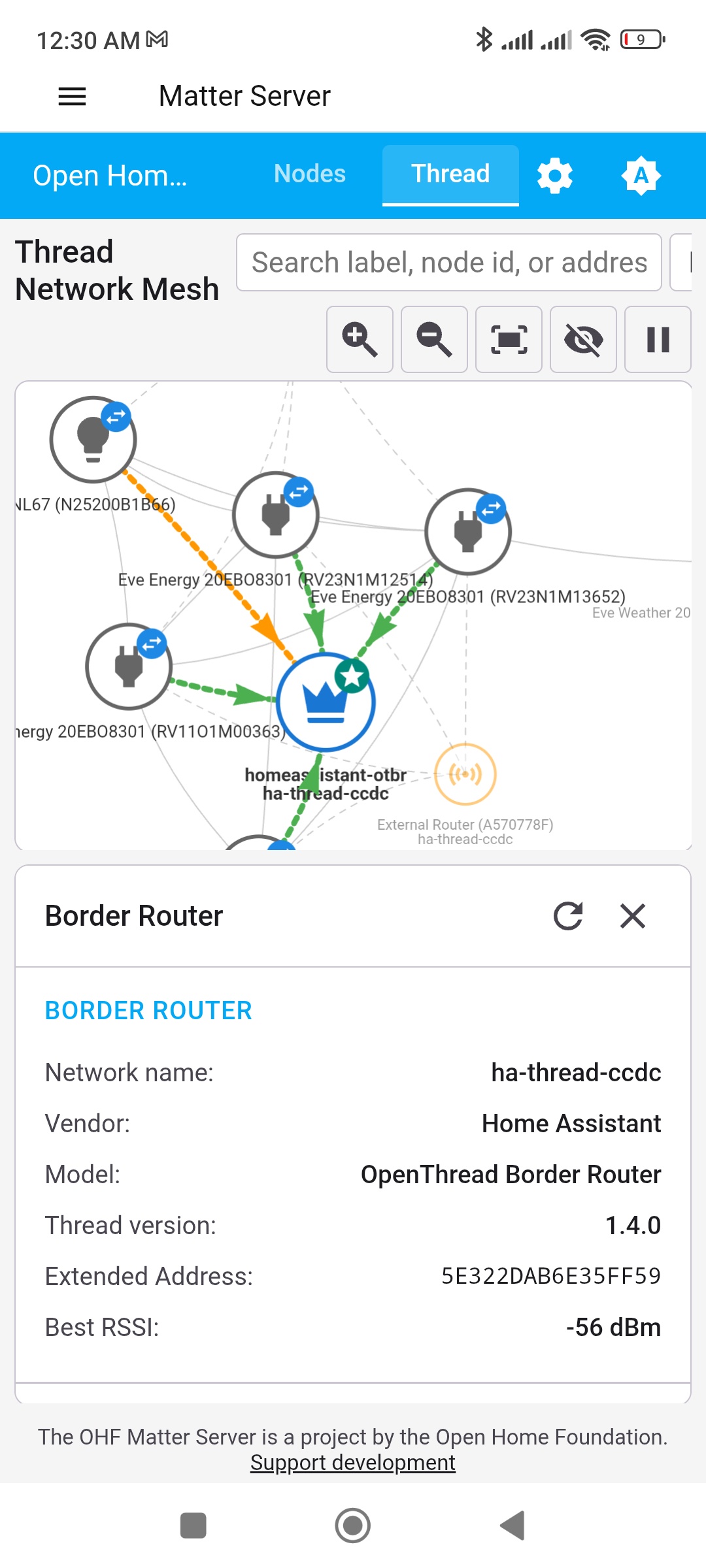

I've read the Migration FAQ, and as noted, I do have two "ghost" External Routers, but what has me kind of worried is that my ZBT-1 is shown in orange and not blue. Clicking it turns it blue temporarily, but if I click the refresh icon I get the "This device is not commissioned to this fabric and cannot be queried directly. Update network data from 5 nodes that see this device to update info." - same with the two ghost external routers.
It appears connected, but shows in orange instead of blue. All the devices are functioning normally.
Gemini is assuring me that the orange color for my ZBT-1 is normal since the router is not doing any active routing and that the ghost External routers should go away over the next couple of days (as my smart plugs and bulbs rebuild their internal routes?), but I dunno...

My ZBT-2 shows in orange, it always has been orange.
It goes blue for a while if I click on it.
It also shows as "not commissioned into this thread network", and always has done.

Sounds like your system is behaving normally.
Alright cool thanks. The ghost external routers are a bit of an eyesore as well, but I guess it is what it is, for the time being at least. Really hope it gets ironed out however eventually.
