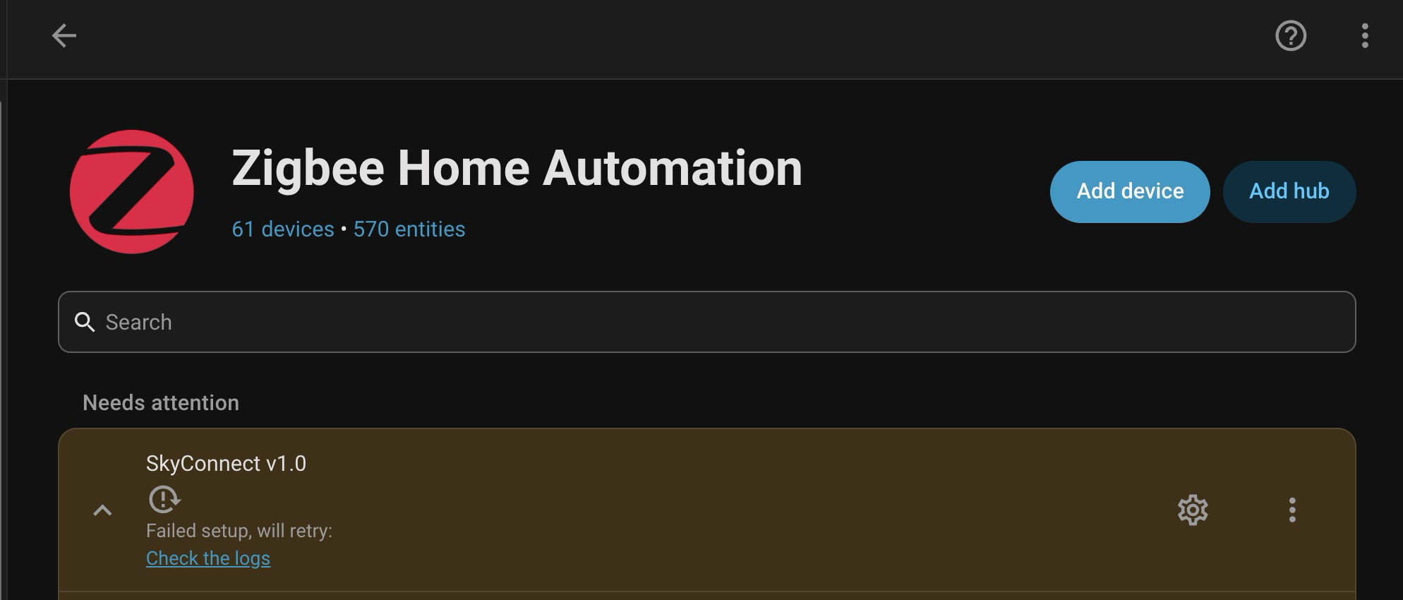

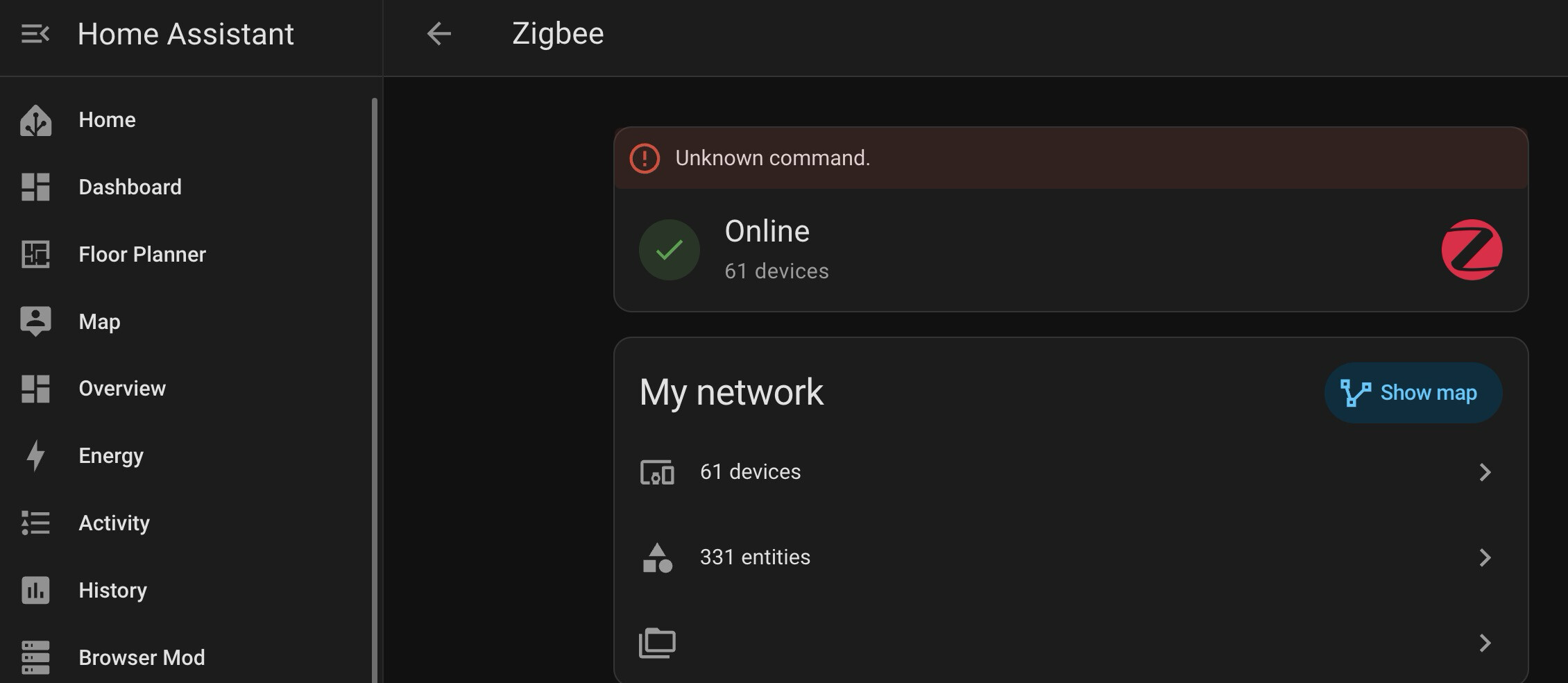

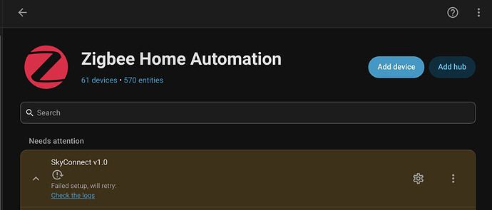

For some reason my Zigbee network stop working today, appears the Unkown command when I go to :
When I try to select the Options or the Network information options appears a black page without any information.
The logs do not show any error and after enabling Debug logging I cannot identify anything relevant also.

Thanks for the tip, I had already tried that and didn’t work.
I solved the problem by replacing the ZBT-1 with the new ZBT-2 model and rebuilding the network from scratch (removing the integration with ZHA), since the migration also didn’t work. I suspect the database was corrupted.
