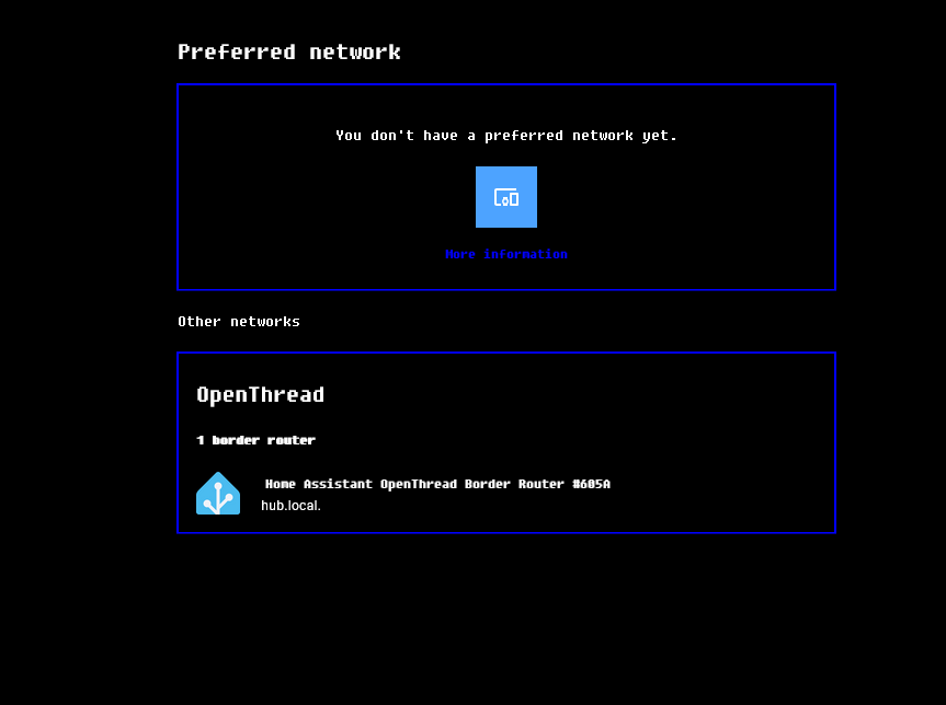

when I open thread addon, I see this
What I should do?
It states you have a border router already.

Your screen shot is the Thread integration, which is installed by default. And it suggests that the OTBR add-on is running, because a Thread network is detected on your LAN (unless you already had that one?). But the OTBR Integration appears to be missing and as you noted, needs the URL of the add-on during setup to be able to talk to it. The URL is typically http://localhost:8081. I agree it would be helpful if this were explained in the docs.
