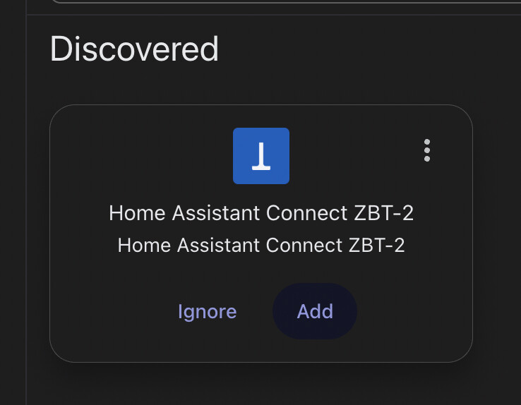

ZBT-2 discovered even though it is already installed
hey :waving_hand:
I have a zbt-2 with Thread firmware currently set up. OpenThread border router is set up on HA, and my network is working just fine.
Since a couple of days ago, I'm seeing my ZBT-2 as Discovered
I have no idea why, I haven't changed anything and as I mentioned, no issues with my Matter devices.
I wonder if I can ignore it this, or if going with Add does any good, like, tracking firmware versions, but also a bit concerned if doing any modifications can wreck my Thread/Matter setup (99% sure it won't affect but anyway)
I'm using Docker-based version, privileged container.
Check your integrations page if you have it already installed & if this "discovered" integration is a duplicate. There was a bug in the 2026.5.0 release where the ZBT-2 was being detected twice, but the bug was fixed in last Friday's 2026.5.2 release. If that's the case, all you need to do is update HA to the latest version.

nope, not installed. never did it. I flashed the zbt-2 when I bought, spin up the openthred container, it found the device and that's it.
but it should report firmware version.
that's what I was looking for. my only concern is that the steps to add the integration requires me to kind of "re-flash" the zbt and I wonder if it will break my setup
