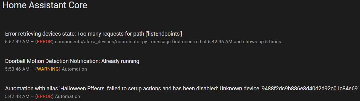

After migrating from a Home Assistant Green to Yellow, I found the blue light slowly flashing on my ZBT-2. I tried moving the ZBT-2 to different locations, I also powered down the Yellow and re-connected the USB cable. There is nothing in the log file that indicates a related issue (See below). The firmware is up to date Firmware: EmberZNet Zigbee 7.4.4.6. All of my Zigbee devices are functioning normally.

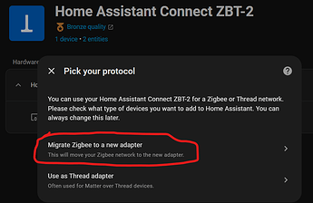

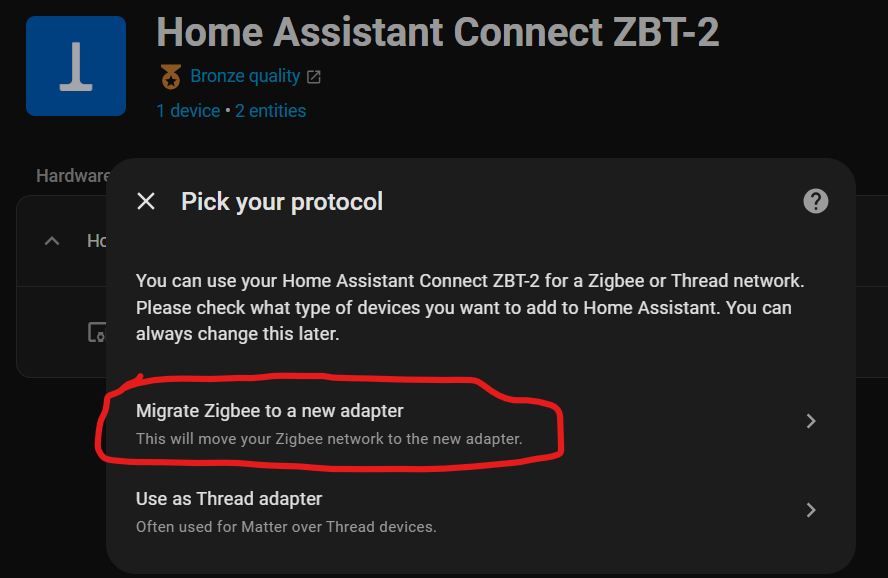

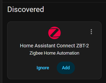

Everything looks like the Zigbee migration worked. Even so in the integration and hardware settings, I ran the “Migrate Zigbee to new adapter”. It was discovered again, and I clicked the “Add button” and now the light has gone out. Not sure why I had to do this again. When I migrated the ZBT-2 yesterday at one point there was something like “Yellow Zigbee blah blah”. I don’t recall what it said but it was related specifically to the Yellow’s Zigbee.

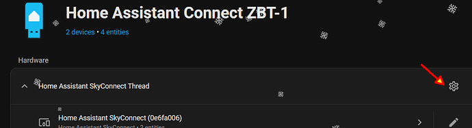

find the yellow zigbee/thread device in the settings, click the gear to choose between zb/thread, follow the prompts to have HA switch it to thread mode.

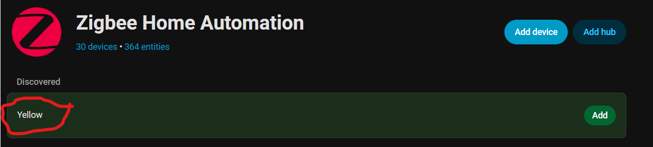

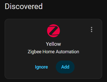

Also, I just noticed that “Yellow Zigbee Home Automation” is ready to be added. I already did this once, not sure why it’s prompting again.
Do you know what this “Yellow” Zigbee is for? Maybe the internal Skyconnect?
yes that is the yellow internal zigbee/thread controller, add it and choose thread
The only options pertain to Zigbee. Maybe just Ignore it for now until I configure the Skyconnect for Thread?

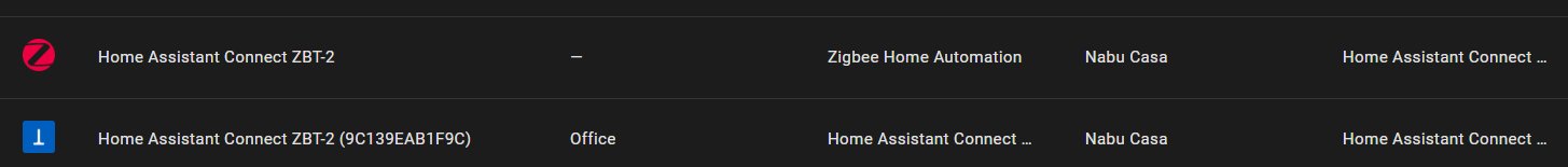

Also, under devices I have two ZBT-2 entries which seems odd.

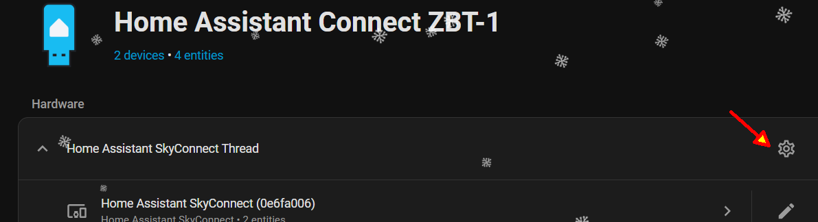

weird, do you see the yellow zigbee in the HA > SETTINGS > DEVICES/integrations ? if so click it and then click the gear to reconfigure it to thread.
as far as the zbt2, it looks like maybe one is for the zbt2 device itself and the other is for the ZHA to the device?

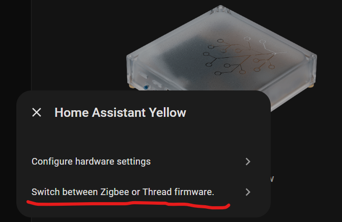

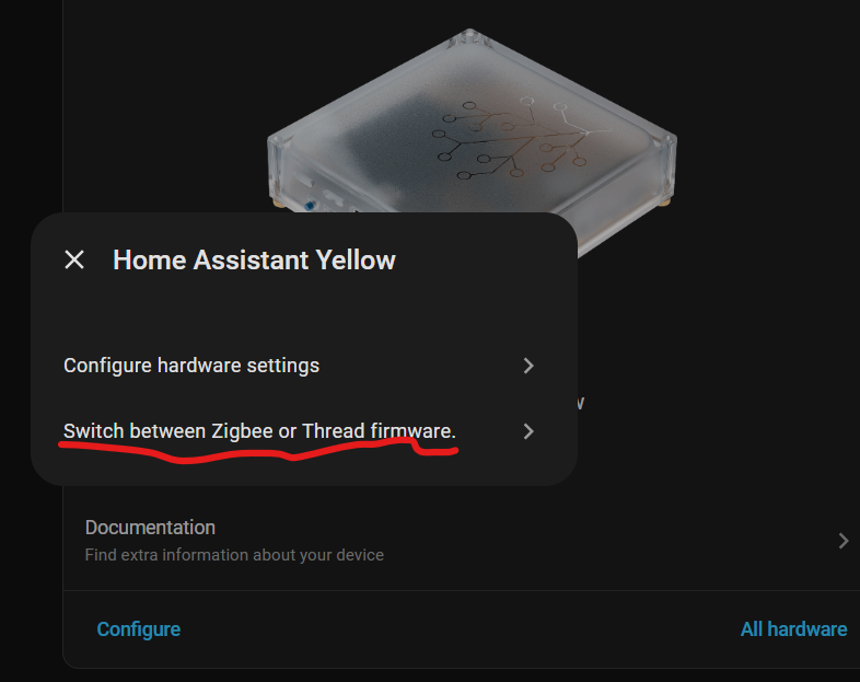

FYI, I believe to configure the internal antenna I went into Settings → System → Hardware and there is this option to switch between Zigbee and Thread. I just want to confirm this is the internal coordinator and not the ZBT-2 before I proceed!
ok yes that looks like it

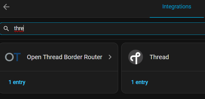

I followed through and configured the internal adapter as Thread, and it now shows up in my integrations. I still had this “Discovered Yellow” Zigbee message in integrations, I restarted HA, and now that’s gone. I think finally I’m good to go!
