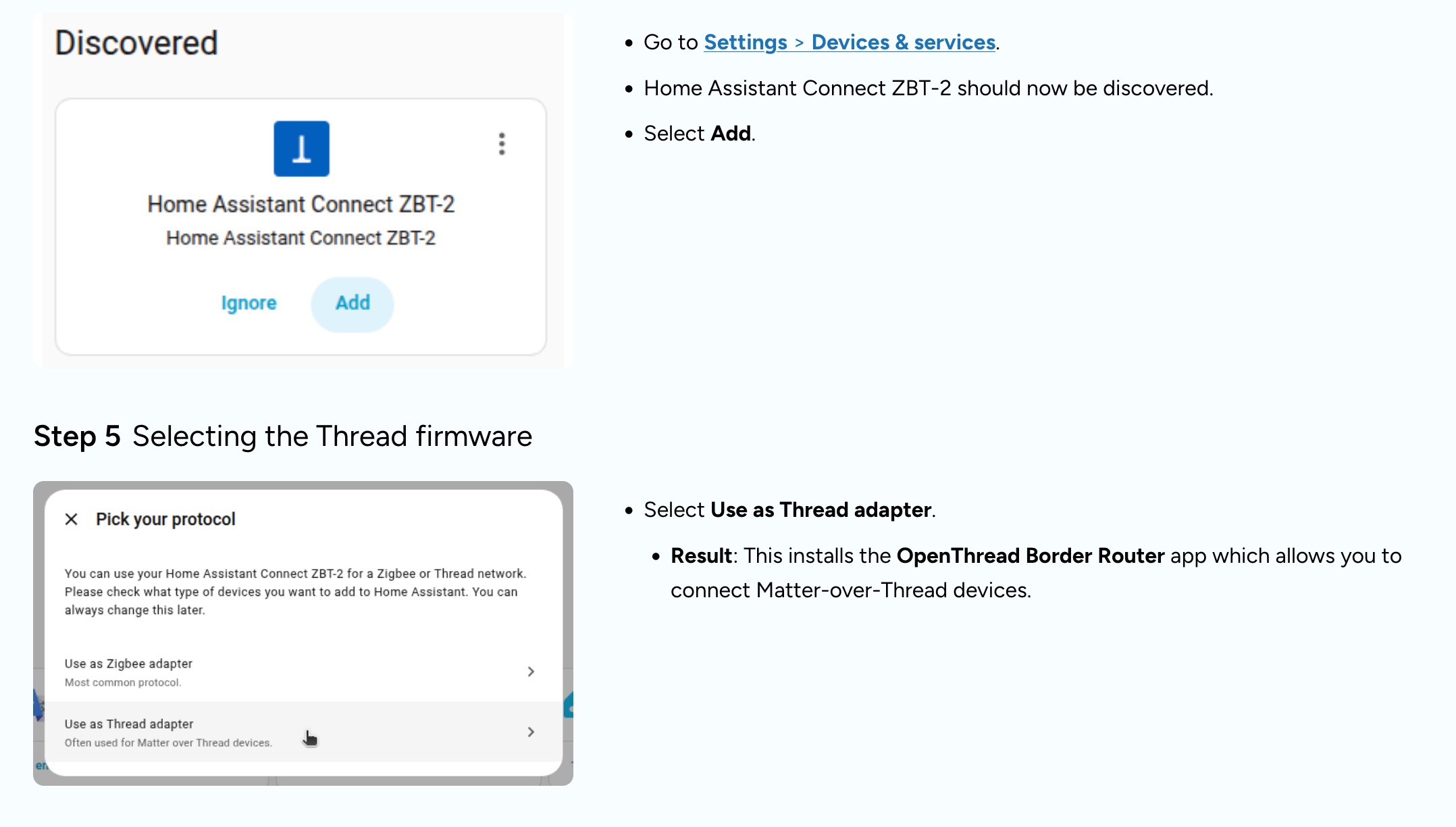

I just bought a ZBT-2 for my thread network. However when I plug it in I never see the following (screenshot) to choose between Zigbee and Thread? How can I get to this point to select what I want?
Yes between Matter, Thread and ZBT-2 there are things under Devices and Sevices, Apps and system settings.
That setting is under Settings / System / Hardware and there’s a separate panel for the ZBT-2. Click it and it asks about Zigbee vs Thread use
Your a star, thank you…
