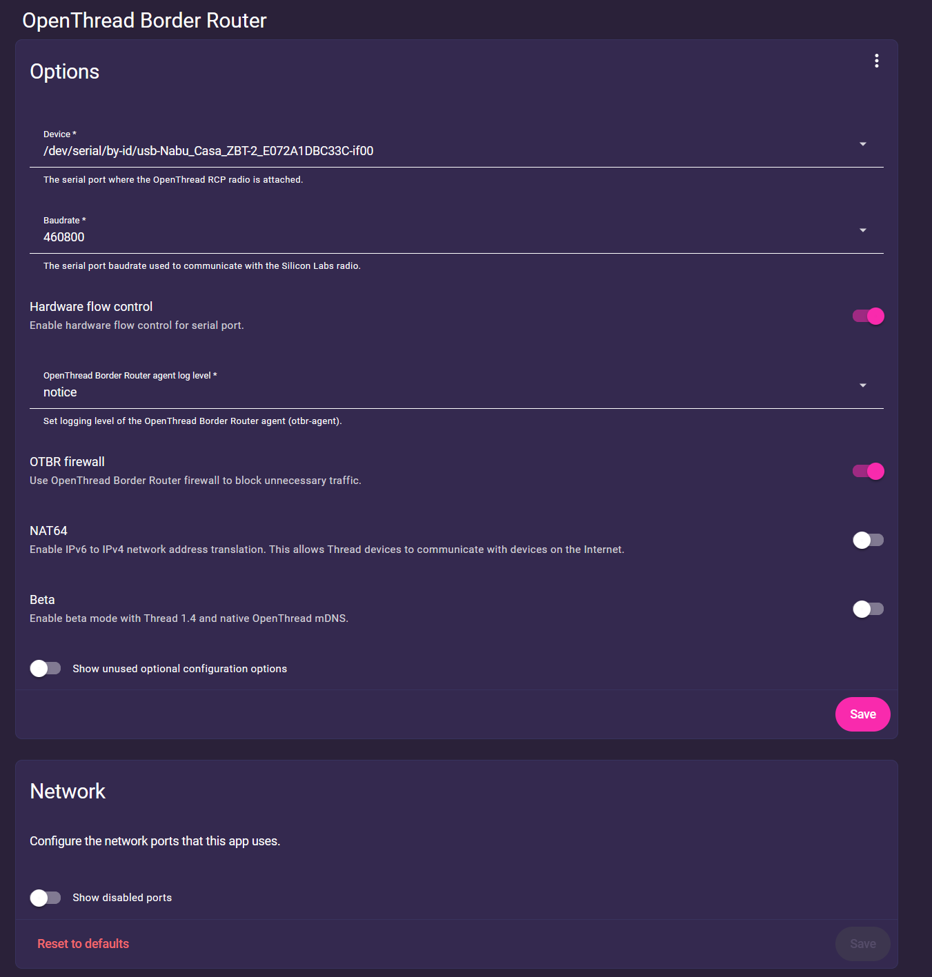

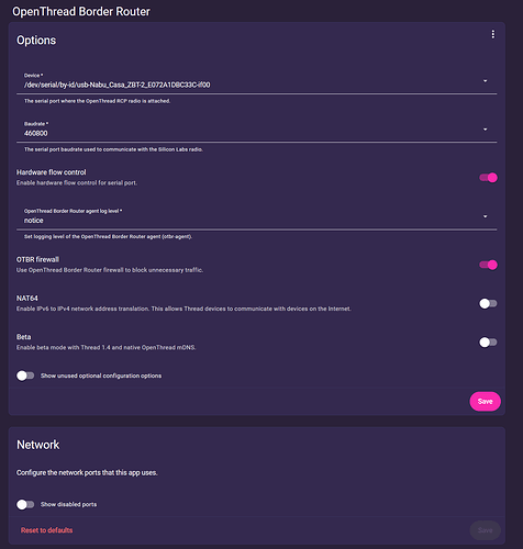

In the OpenThread Border Router app, this is the configuration:
