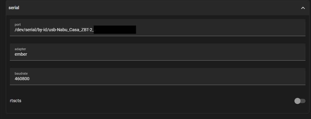

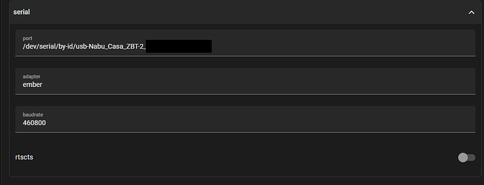

Here is my configuration :
According to this, you need to enable rtscts.
Switch the z2m config to yaml mode from the 3 dots in the top right & confirm that your serial: section matches the below:
serial:
  adapter: ember
  port: /dev/serial/by-id/usb-Nabu_Casa_ZBT-2_<usb-serial-number>-if00-port0
  baudrate: 460800
  rtscts: true
