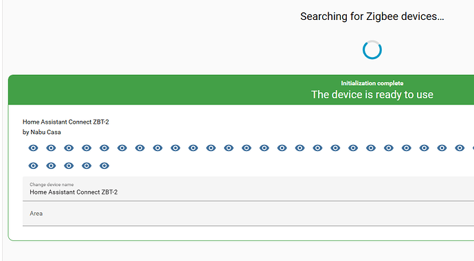

I have had a ZBT-2 up and running for about 10 days, and today I tried to add my old re-flashed Sonoff Type E dongle as a router.
Flashed as:
Current Device:
ZBDongle-E
Current FW:
Zigbee Router 8.0.2
When the Sonoff is plugged into a usb port the only device found is the ZBT-2:
This appear similar to https://github.com/home-assistant/core/issues/155228
Has anyone had issues onboarding new ZB devices with the ZBT-2?
