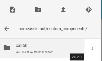

What I did so far:
  • python is running on my pi
  • I have installed and configured MQTT
  • I have copied these lines to configuration.yaml
shell_command:
  start_ca350: python3 /config/custom_components/ca350/ca350runner.py &
  • I have created a folder /homeassistant/lovelace-hacomfoairmqtt
  • in this folder I have copied the file "hacomfoairmqtt.js
  • I restarted HA and tried to insert this card in a new dashboard, but it`s not available
Is this all right?
What needs to be done then?
Thank you for your support.

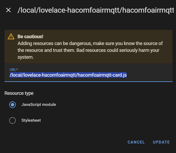

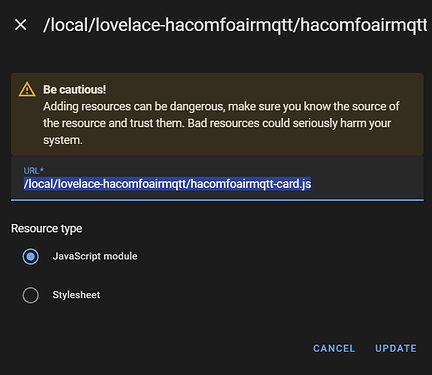

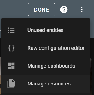

You need to put it in the www subfolder. e.g. /homeassistant/www/lovelace-hacomfoairmqtt
After that go to your dashboard, go to edit mode, select “Manage resources” from the three dot menu:
and add javascript module with url /local/lovelace-hacomfoairmqtt/hacomfoairmqtt-card.js
Thank you very much.

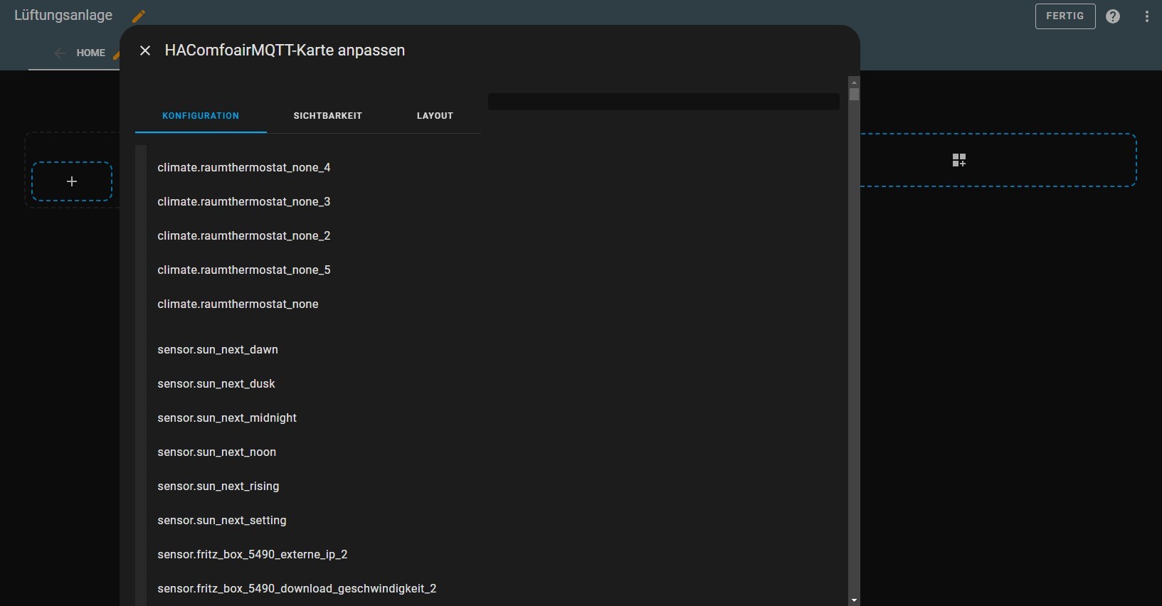

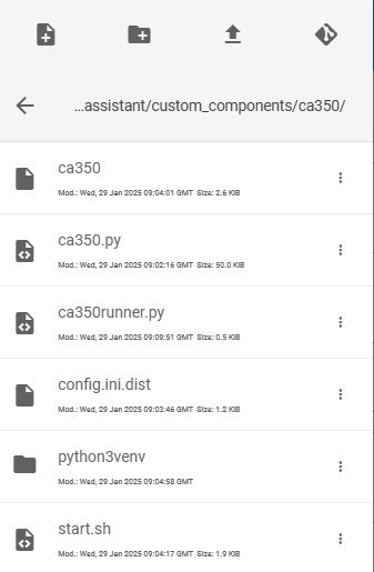

I did this, but cannot see the entities in my Dashboard.
Attached you can find some screenshots to maybe understand better, what I did:
Dashboard (no graph or picture seen)
configuration.yaml
configuration.yaml
Folders & Files
Folder-Structure_1

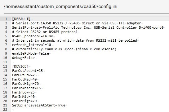

Do I need to make any changes in a file if I want to connect ComfoAir350to the USB-Port ttyUSB0?
USB_Pi

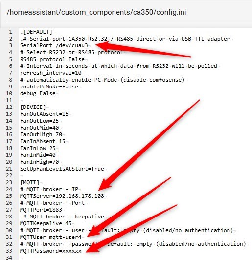

You need to adjust the settngs.ini file to your environment (e.g. mqtt server, serial port etc.)
Thank you.
I have already changed the config.ini according my data.
Please see the screenshot below.
Do I have to make any chenges if I want to use the USB I have shown above?

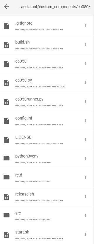

I don`t want you to have too much work, but do you have a overview which data you have copied to which folder?
My structure is like this:
I still don`t see any picture in the dashboard.
Thanks a lot.

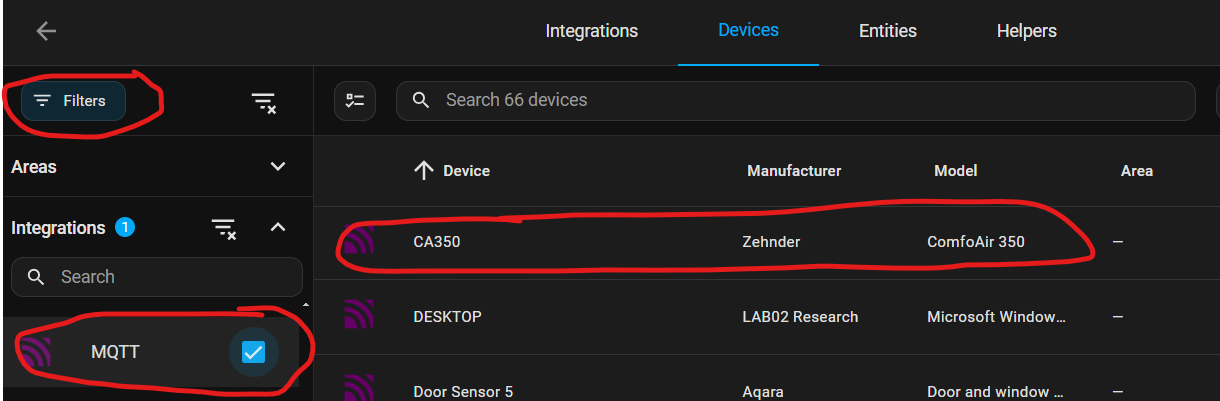

I’m sorry but I’m not fully sure about the deployment in HAOS and I don’t have it at home. First of all I would verify that the serial port is correct. You can check what is visible in the /dev/ folder. Run ls /dev/serial/by-id and you’ll see what’s there. I don’t know what type of RS232 adapter/cable you have and what other devices you have connected to your system.
Apart from that, make sure you’ve followed instructions on deploying the ca350 script as described in the Wiki Home Assistant Operating System · adorobis/hacomfoairmqtt Wiki · GitHub. As I’m not the author of those instructions I can’t validate that they are still up to date and will be working in your case. But they look good according to my knowledge.

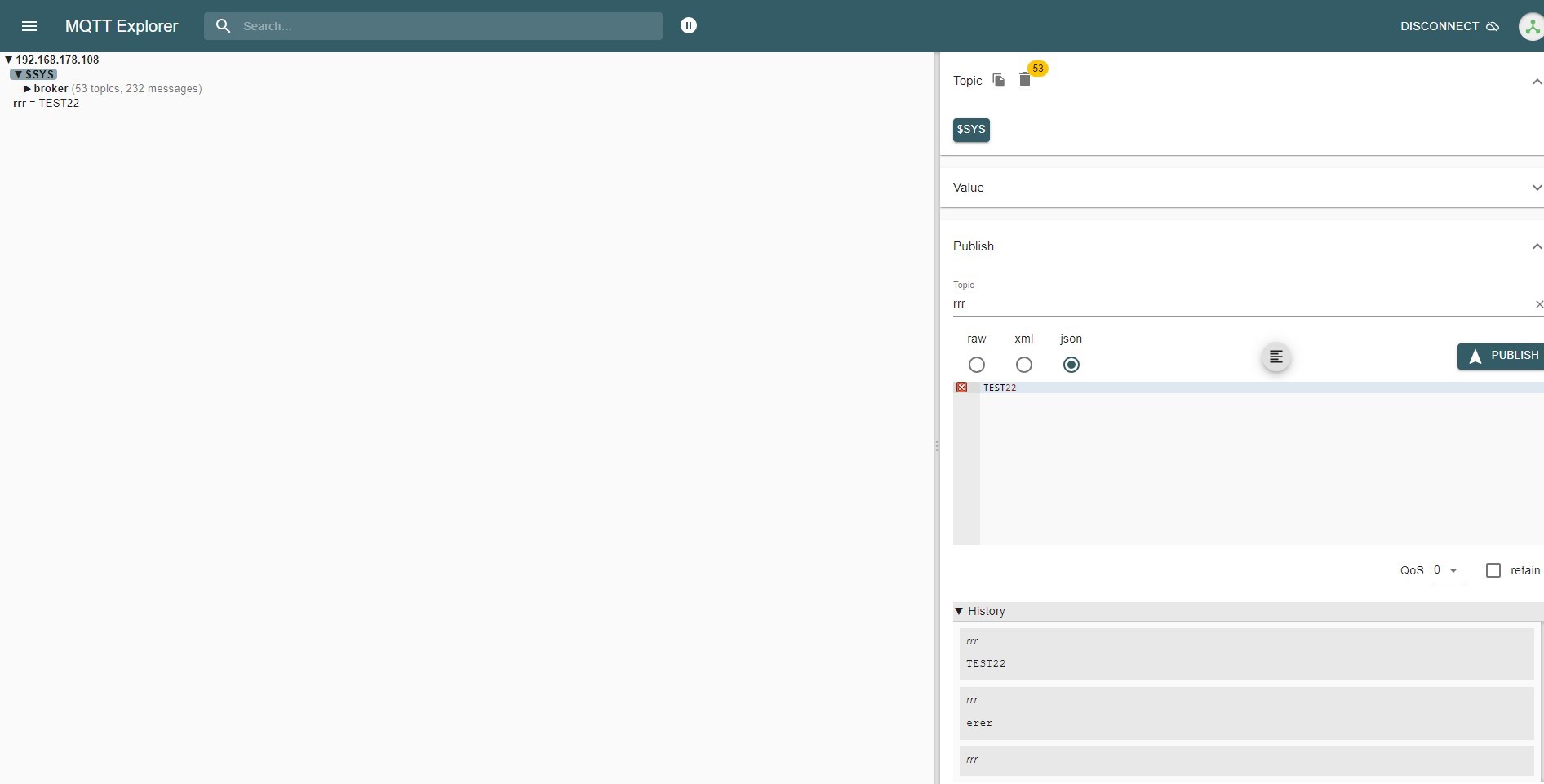

Next, check that the script is actually sending any data to MQTT broker, you can do it by using MQTT Explorer app. If you have not changed this in the config.ini the data should show up in comfoair topic:
If the data is not there it means that the script does not run. If it is there, especially with online status go to HA and verify that the corresponding device and entities are visible in the MQTT integration:
If it is not there, it means that something is wrong with your MQTT integration.

My USB-Connector is listed as following (worked well with openHAB) port:
port
Must the port be copied to the config.ini → if yes waht will be the name?
If I check MQTT, I`ll get following result (Comfoair is not listed, as described by you).
I think, it`s a problem with MQTT.
Sorry for all those questions.
Yes, the name will be /dev/serial/by-id/[this-long-name-that-you-have-shown-above]
Now, once this is correct, restart this command line again, or ideally just run it from the command line so you’ll see if it works or if there is any error being returned. To do that, in command line activate the venv:

Well, clearly the serial port is not correct. You need to provide the full path as I’ve mentioned earlier:
/dev/serial/by-id/usb-Prolific_Technology_Inc._USB-Serial_Controller_D-if00-port0

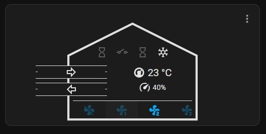

I can now change the fan-speed and get data like on the screenshot.
How can I get the outgoing and incoming temperatures as well?
