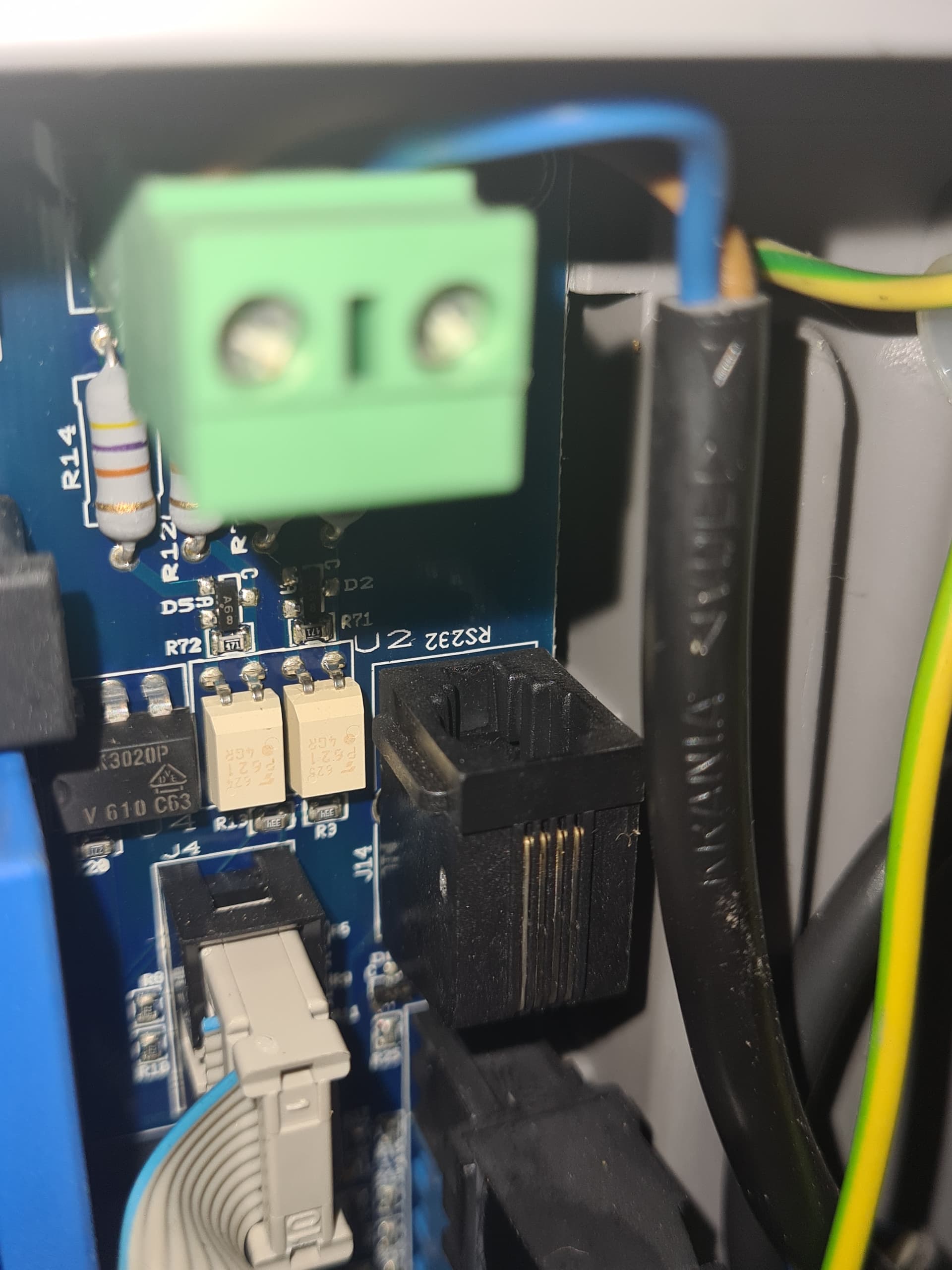

Hello guys!
I’ve tried to use julianpas/esphome-comfoair repo to communicate with my Zehnder CA 550. The ESP32 starts up normally and appears to run fine, but as soon as I power on my Zehnder CA 550 and communication begins between the ESP32 and the ventilation unit, the ESP32 freezes after a few seconds.
With the original code from wichers repo, the ESP32 communicates with the Zehnder unit reliably without any freeze ('m using the same ESP32 hardware and wiring for both your fork and the original repo).
Some details:

The above pattern repeats consistently every time, and it does not matter whether I have comfosense connected or not. Has anyone else encountered this problem?
Can you describe how you wired the ESP32 up? It seems like you have wired the unit to the second UART which is meant to proxy the ComfoSense commands.
Hi Julian! Thanks for responding!
I’ve triple-checked the wiring and it is the same as in the image from the post above, so:
the units TX/RX → level shifter channel 1 RX/TX → esp32 RX/TX pins (3/1)
comfosense TX/RX → level shifter channel2 RX/TX → esp32 pins 16/17
Here is my yaml:
esphome:
  friendly_name: ESP-Rekuperacja-3
  min_version: 2024.11.0
  name_add_mac_suffix: false
esp32:
  board: esp32dev
  framework:
    type: arduino
logger:
  baud_rate: 0
  level: VERY_VERBOSE
# Enable Home Assistant API
api:
# Allow Over-The-Air updates
ota:
  - platform: esphome
wifi:
  ssid: "[cut]"
  password: "[cut]"
  domain: .local
  reboot_timeout: 15min
  power_save_mode: NONE
  fast_connect: False
  passive_scan: False
  output_power: 20.0dB
  enable_on_boot: True
  manual_ip:
    static_ip: 192.168.68.53
    gateway: 192.168.68.1
    subnet: 255.255.255.0
    dns1: 8.8.8.8
  use_address: 192.168.68.53
  ap:
    ssid: "Rekuperacja Fallback Hotspot"
switch:
  - platform: gpio
    pin: GPIO25
sensor:
binary_sensor:
external_components:
  - source:
      type: git
      url: https://github.com/julianpas/esphome-comfoair
    components: [comfoair]
uart:
  - id: uart_bus
    rx_pin: 3
    tx_pin: 1
    baud_rate: 9600
  - id: uart_proxy
    rx_pin: 16
    tx_pin: 17
    baud_rate: 9600
comfoair:
  uart_id: uart_bus
  proxy_uart: uart_proxy
  type:
  size:
Here are the logs:

Hi all, my unit seems to be different from everything I already read. I bought a house with a storkAir WHR930. I wanted to automate this with an ESP8266 and HA. I bought and build the parts similar to GitHub - LukasdeBoer/esp8266-whr930-mqtt: Control your StorkAir / Zehnder WHR930 using a ESP8266 via MQTT. However when the time came to connect it to the PCB i found that my unit did not have an RJ45 port, after some measuring and testing i found out it was an RJ9 port (4P4C). I ordered this cable cut it up and tried connecting it this way to a DB9 RS232-TTL converter. However i am not sure about the pin out i tried a couple of combinations but nothing seems to work. Has anyone got any ideas. tips or resources to set me in the right direction?
Are you sure its a WHR930, because it doesn’t look like a print of a WHR930. These are green and have a RJ44 (RJ45) connector for RS232 communication.
By the AI looks of it this is a 950 or 960;
edit: hmm funny… If I click on electrical scheme I get a schematic drawing which mentions RJ45. https://zehndernl.zendesk.com/hc/nl/articles/360000168117-WHR-950-Elektrisch-schema
apparently there are different board versions? As your photo matches the connector on the 950/960 board photo.
