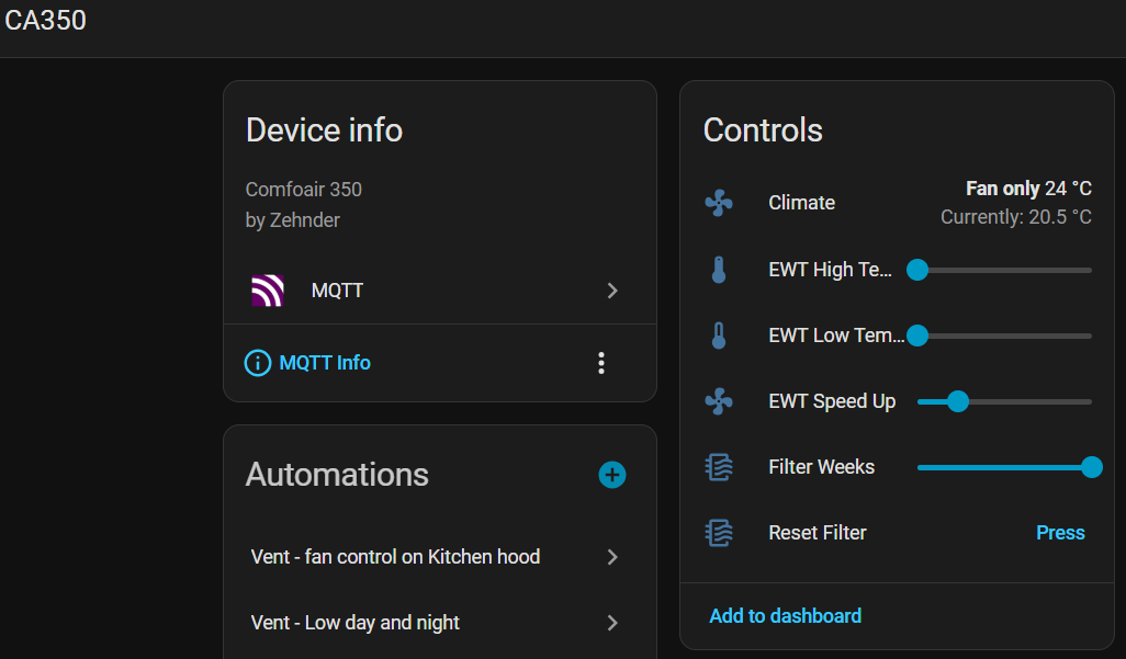

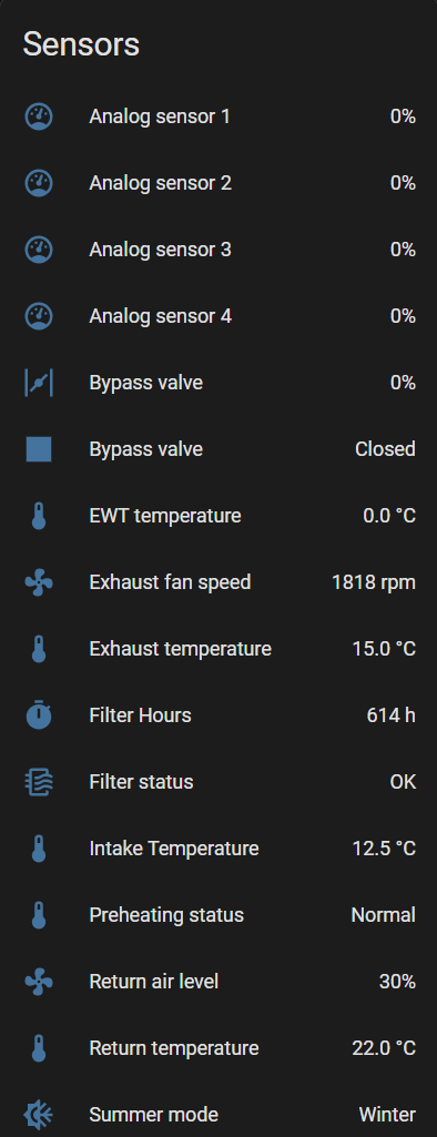

Anyway, why don’t you check what entities you have in HA. Go to Settings->Devices&Services->MQTT and select your device (default name is CA350). You should see something like that:
and a pretty long list of sensors:
Which one are you missing?

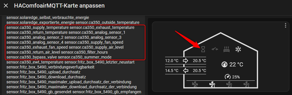

The entity “binary_sensor.comfoair350_wohnraumluftung_filter_status” was not shown in my dashboard. I have updated it now.
Now it`s visible again, but not in the visualized view:
There is just a grey sand clock visible and the entity is not listed in the MQTT-List.
I have in mind, that this was different before.
If the filter time has exceeded, I was normally able to reset this by pushing the “Filter Reset-Button”.
But here also nothing happens anymore.
Sorry for so many questions. Have a nice day.
Yes, it should look like that (or red in case filter requires replacement):

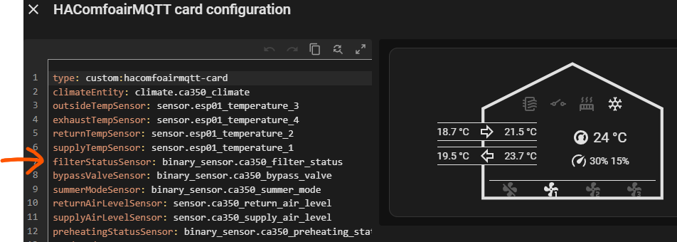

Could you go to yaml mode of the card config and check if you have proper entity id defined there:
Make sure it is the same as the one you can see in your device:

I have checked all entities-they seem to be right.

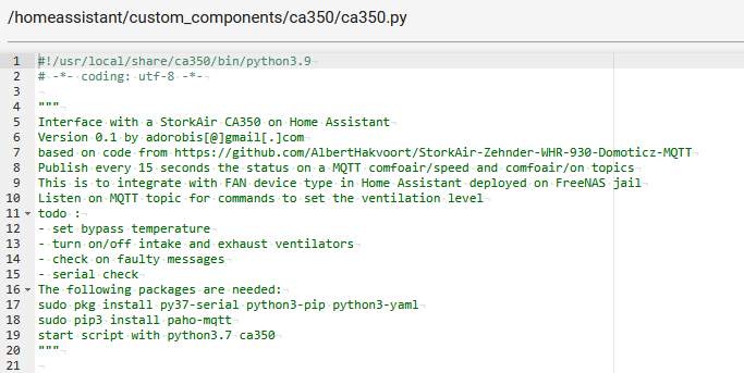

I have replaced thoe code you have posted in this file:
/homeassistant/custom_components/ca350/ca350.py
After doing so and restarting the system CA350 Items don`t work anymore.

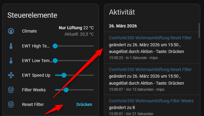

The LOG-File shows, that I have pushed the Button “Reset Filter” several times, but the red Icon still remains.

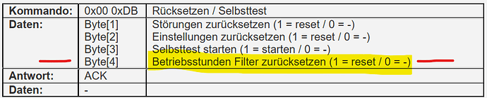

Alternatively, you could try using this command to reset the filter hours (though I haven’t tested it myself yet):
Interestingly non of the options work for me anymore. Maybe because I’ve reset the filter a few weeks ago successfully sending the two button press commands - at that time filter was past the timer. But now the status of the filter is OK and hours ~670h. Can’t reset it at this stage - maybe this is standard behavior?
Reset from the CC Ease (with long button press) is probably only possible, if filter warning is active.
Did you also try with the 0xDB commad?
My guess is, that this should always work.

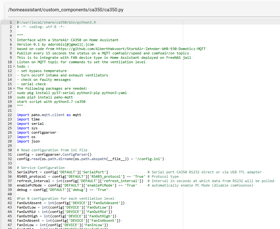

I have replaced my old ca350.py File with the new file you mentioned.
If I do so, after restart all Entities are unavailable.
I have not found any line to change/customize in this file.
Did I miss something?
Is it just abou to replace this oine file “ca350.py” wih the new code?
