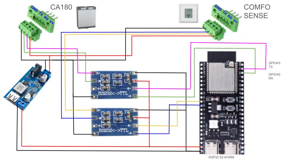

Hello again everybody :slight_smile:
I've been using the @julianpas code for 3 year now with no issues.
I wanted to upgrade to @adorobis code and also use @pepo83 integration in HA.
I decided to use a spare ESP32 N16R8 which can be an overkill but I wanted to share my newbie schema as I'm waiting for the new MAX3232 converters.
For me keeping the Comfosens proxied and working along with the esp is mandatory.
I'm asking you gurus to check if the schema is all correct, especially the GND connections.
And I hope non-tech people can find it useful.
Once confirmed it's correct I will share also the yaml code.
Thanks in advance for supporting!

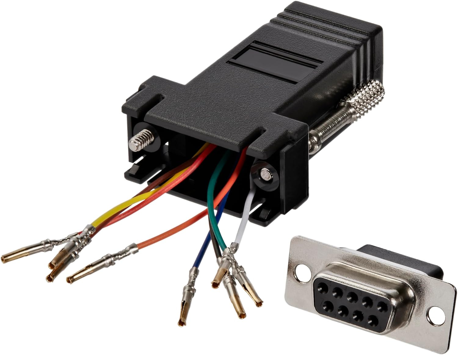

I'm planning to use the USR-W610 Wireless Converter Serial to WiFi Ethernet Converter RS485/RS232 gateway (RS485 to WiFi Converters | RS232 to WiFi Converters | Serial WiFi Converters) using a Startech DB9 to RJ45 adaptor (https://www.startech.com/en-us/cables/gc98ff) to connect to Zehnder. I will connect the RJ45 pins to DB9 as follows:
ORANGE RJ45 pin 2 (RX) → DB9 pin 3 (TX)
BLACK RJ45 pin 3 (TX) → DB9 pin 2 (RX)
WHITE RJ45 pin 8 (GND) → DB9 pin 5 (GND)
Do you think this will work?
Thanks!
Yes, that's how it should be connected. Make sure that you don't connect other cables from comfoair, especially the +12V line.

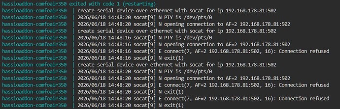

Hello Guys.
First of all many thanks for this project !
I would like to confirm that this Waveshare USB to RS232/485 Serial Converter works very well
Best regards !
sending thanks to : TimWeyand/lovelace-comfoair: Homeassistant Lovelace Comfoair card
took insparation from his card works great on LAN-C version too.
Hi, thanks for your support.
I have now installed a Docker container following the instructions. However, the system won't connect via the IP address. I can send a ping, and it works. I have no idea :pensive_face:
