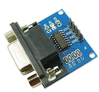

I need help, I cannot make it working with ESP32 + MAX3232 RS232 converter
I cannot make the integration connecting to the remote serial.
how the ESP yaml looks like? how to configure the integration?
Awesome! Any chance to have iti in English?
I managed to make it work. The issue was the swapped TX/RX lines between the ESP32 and the MAX3232.In case others run into the same problem, a very effective test was to short‑circuit the RX and TX pins on the MAX3232. This allows you to isolate the issue and verify each part of the chain separately: ComfoAir, RS232–TTL converter, and ESP32.
