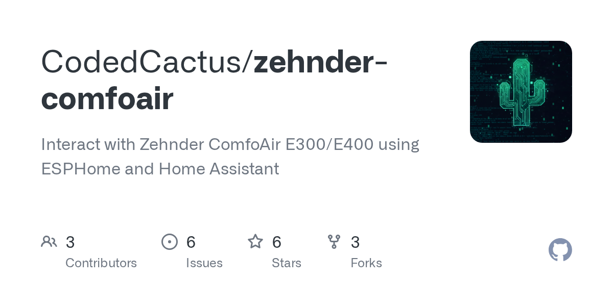

I’ve create a ESPHome component for interacting with the Zehnder ComfoAir E300/E400 devices. The project is likely to work with the ComfoAir PRO 200/250/300 series as well, but this remains untested.
It works by connecting to an undocumented RS485 serial interface using Modbus RTU.
Current capabilities:
  • Fan speed control.
  • Read fan states (RPM, duty cycle, flow rate)
  • Read temperature & humidify (extract, supply, exhaust, intake).
  • Read bypass & heater state.
  • Read external setpoints (RF, 3 way-switch, bathroom switch)
  • Read device fault/errors.
  • Diagnostics (model, orientation, FW, etc)
Here you can find the code. If anyone’s interested, let me know since we need data from more devices to complete the register discovery.

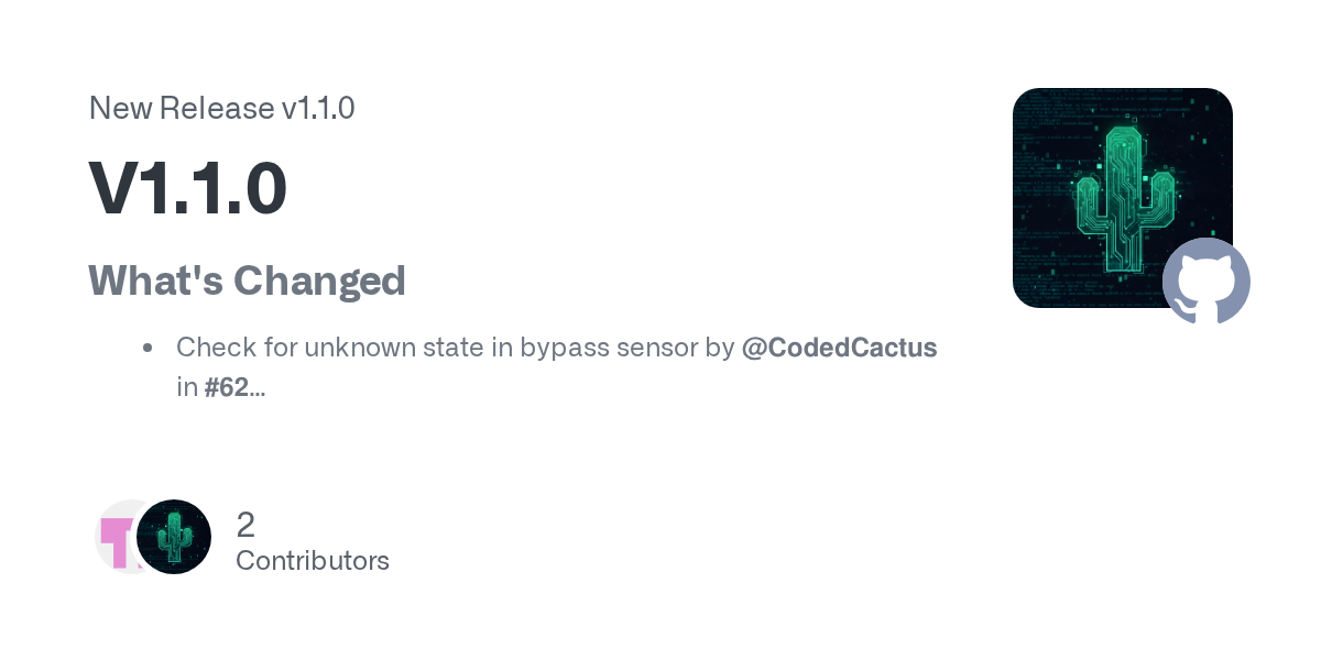

I’ve released version 1.1.0 of the Zehnder ComfoAir ESPHome component.
:wrench: What’s Changed
  • Check for unknown state in bypass sensor.
  • Change VCC to 3v3 for build instructions.
  • Change status to offline when modbus device cannot be reached.
  • Add mapping for transient states.
  • Add boost mode switch.
  • Add register dump capability.
The new release can be found here:

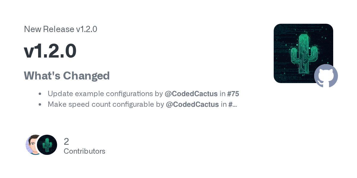

I’ve released version 1.2.0 of the Zehnder ComfoAir ESPHome component.
  • Speed count is now configurable.
  • Add optional air quality sensors.
  • Add/update sensor icons.
  • Add m5stack example.
  • Update example configurations.
  • Bugfix: Set correct pre-boost setpoint.

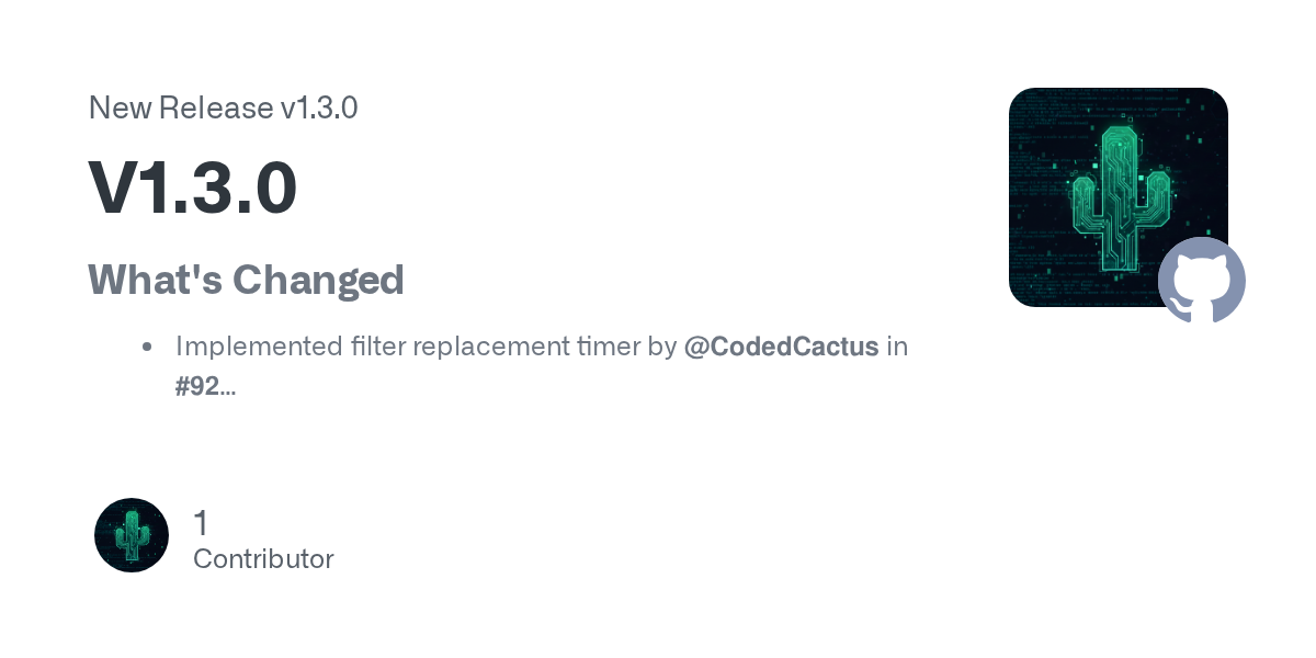

I’ve released version 1.3.0 of the Zehnder ComfoAir ESPHome component.
  • Implemented filter replacement timer.
  • Configurable replacement interval.
  • Automatic filter replacement detection.
  • Update deprecated AsyncWebServerRequest::url().
  • Update deprecated word_from_hex_str.
  • Change reference hardware to ESP32.
  • Add CI/CD pipeline.

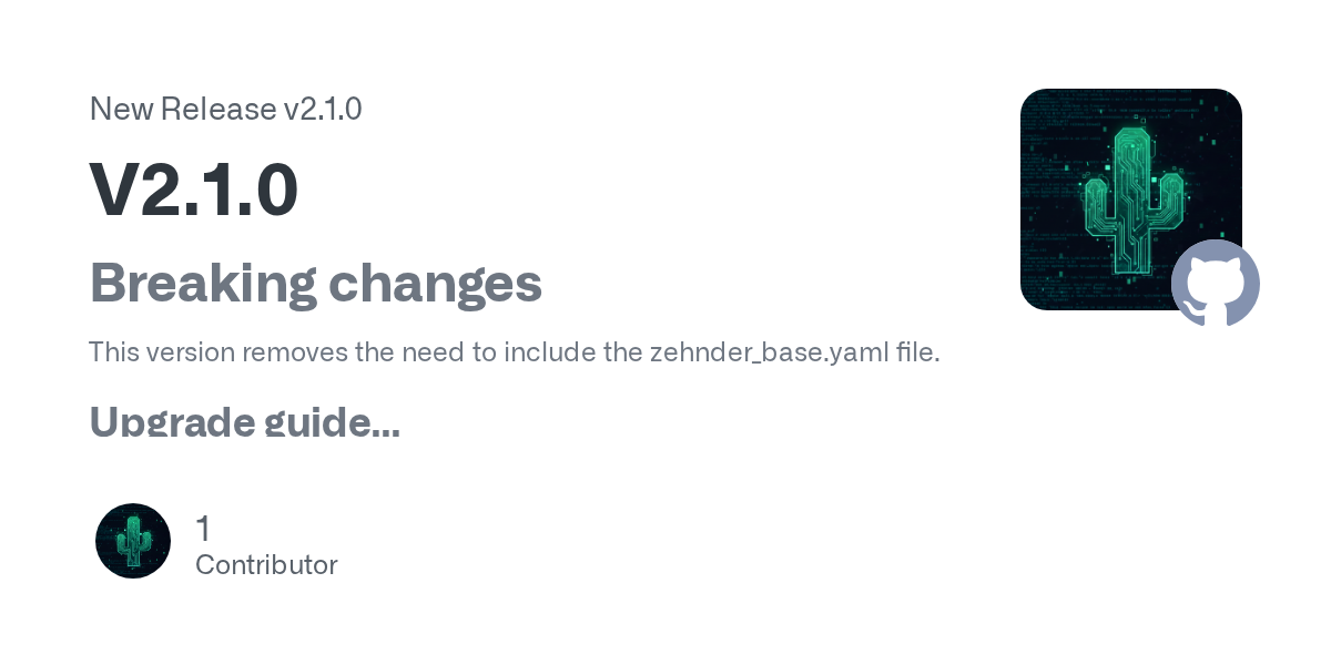

I’ve released version 2.1.0 of the Zehnder ComfoAir ESPHome component.
Breaking changes
This release contains a breaking change to the config in order to support newer FW versions. The config is now firmware dependent.
1. Check your FW version
On older FW versions (1.x.x):
Menu -> login (pwd 4210) -> toestel specificatie -> SW
Or on the newer FW models (2.x.x) and (3.x.x):
Menu -> Opties -> SW
2. Update your configuration
Old config:
packages:
  remote_package:
    url: https://github.com/CodedCactus/zehnder-comfoair
    ref: main
    files: [components/zehnder.yaml]
    refresh: 0s
New config:
packages:
  remote_package:
    ref: main
    files: [components/zehnder_fw{major}.yaml]   # use fw1, fw2 or fw3 depending on your unit
    refresh: 0s
  • Add support for units with firmware version 3.x.x.
  • Add error code sensors.
  • Add defrost cycles, heat exchanger type and humidity control sensors.
  • Add Running Mean Outdoor Temperature (RMOT) sensor.
  • Change parity bit to NONE.
