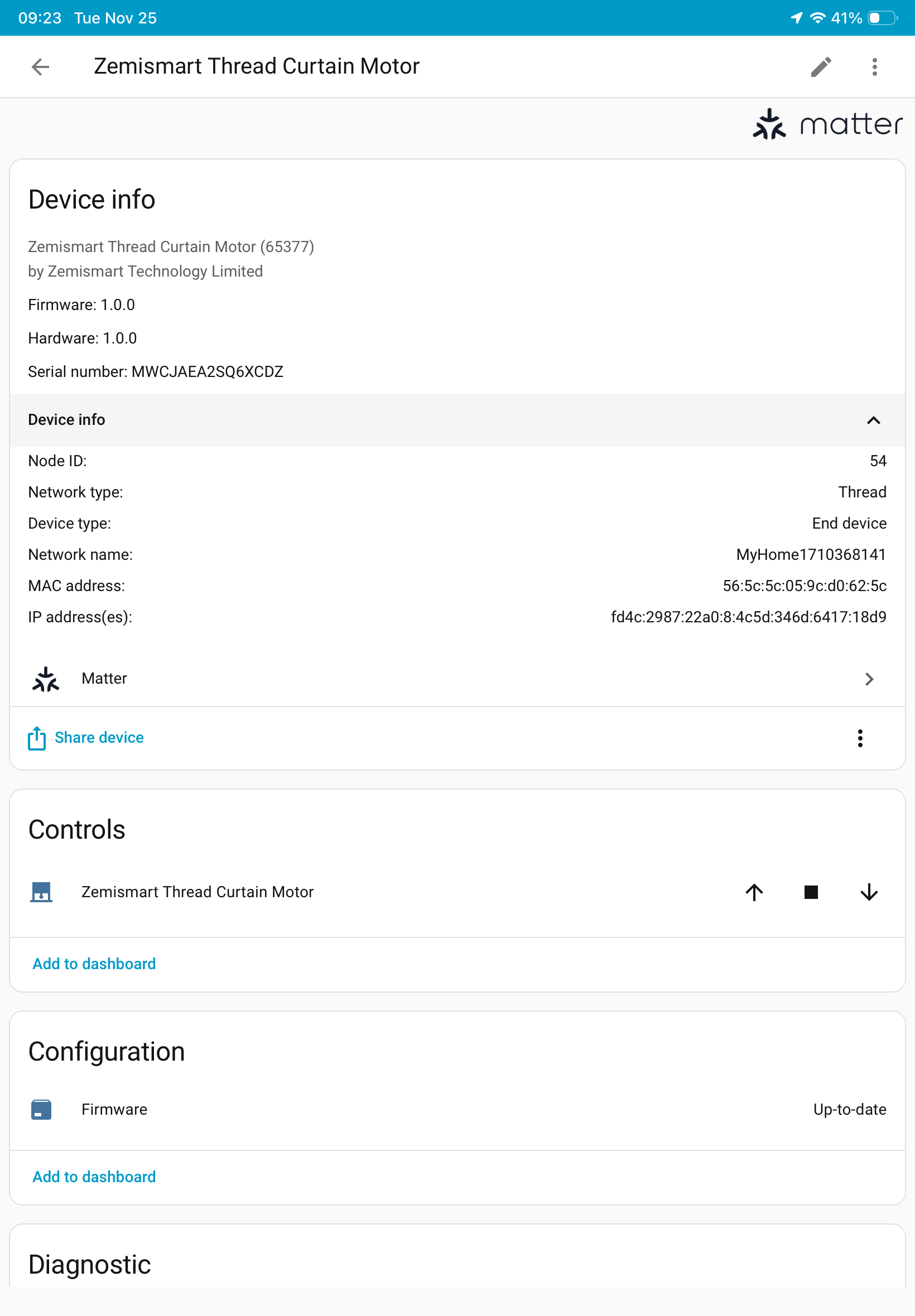

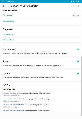

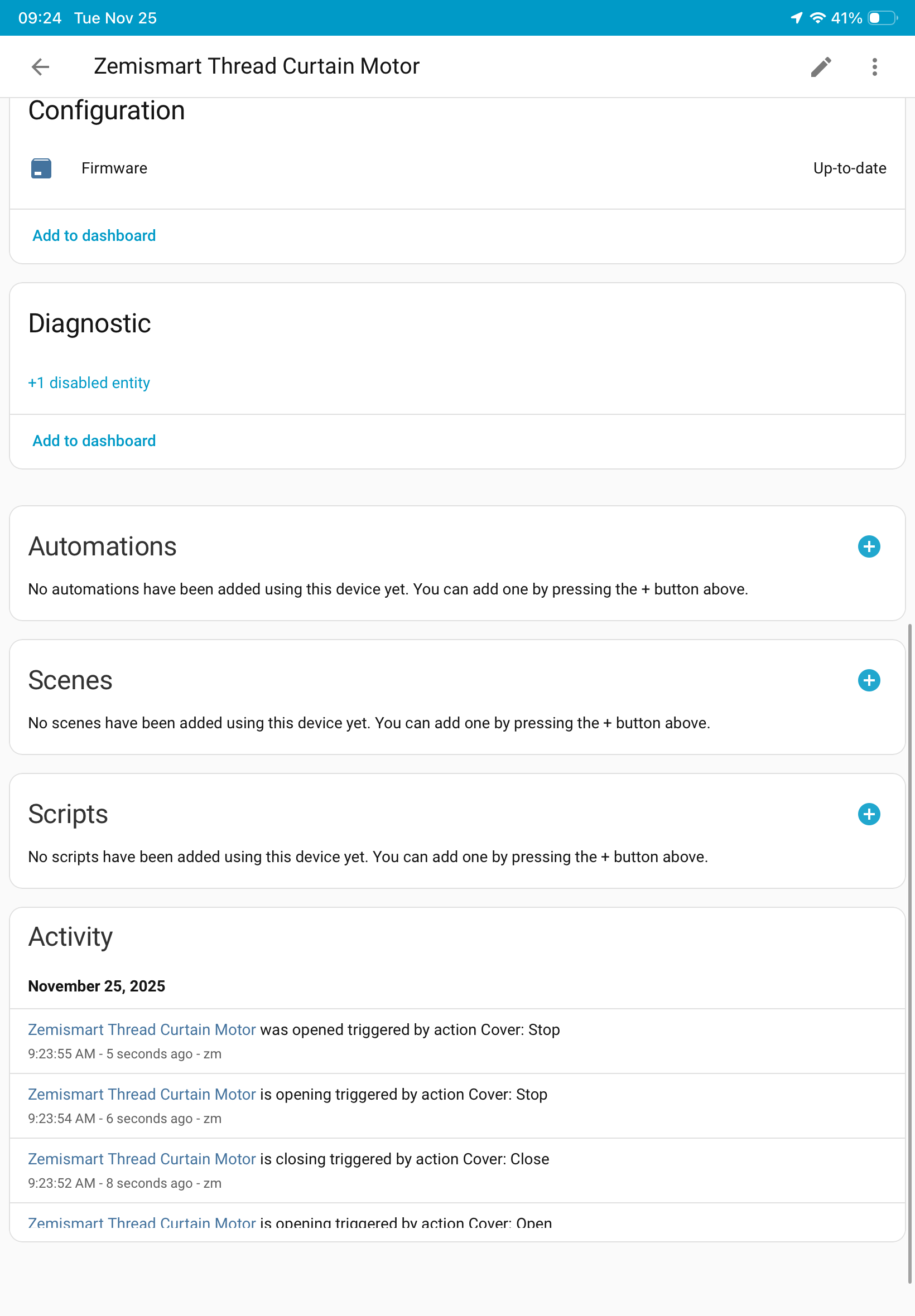

I was able to add the curtains! I first tried my wife's android phone, I got the same error. I then tried it with an old iphone and I was able to add it. So it seems there may be something broken about the Android app, at least in the way I have my HA instance set up. Thank you for your support Tommy, and thank you Zemismart for confirming on your end!
